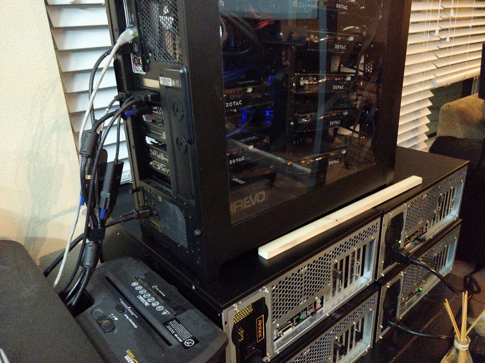

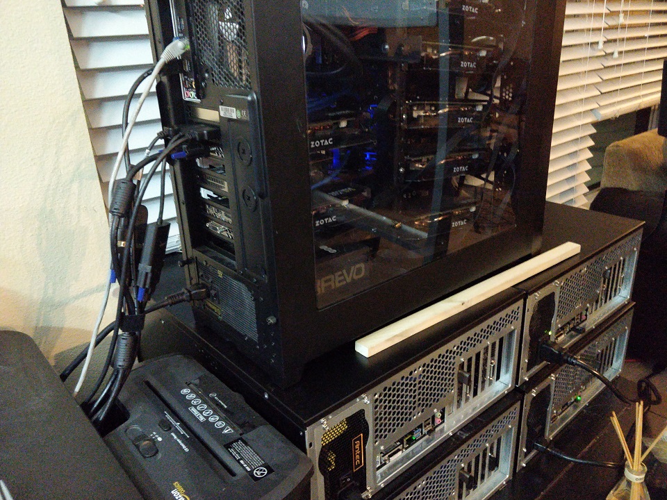

Mostly done. 5 1080ti's, 6 1060 6gb. 1 more spot for more 1060's. 2 RS 580's and whatever does not fit will go into a 4U case and put in the rack.

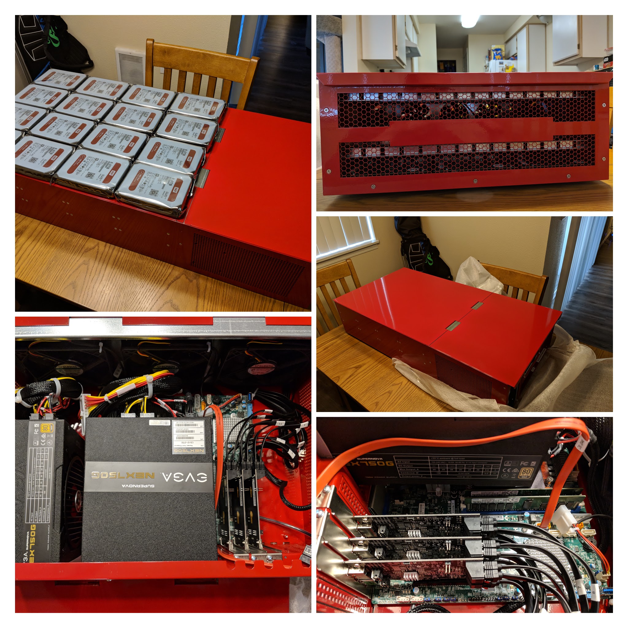

Some awesome rigs around here! I wanted a rackmount rig, so I built my own. Only 2 cards at the moment because they are too hard to find at a half decent price. I got lucky to even get 2 cards. Two GTX 1070 TI's mining ethereum.
Now that this is running and more or less set and forget, I will probably concentrate on looking for more cards, like spamming refresh on retail sites and hoping for the best. But I also spent way too much money on this, so I'm not sure I even want to spend more tbh, but if I come across a good deal then I may. By a good deal, I mostly mean a card that's actually selling at MSRP. :p
Would love to find a way to sneak a second PSU into my Rosewill LSV-4500s but.. :/
Yeah I saw that there are a few rackmount cases on the market but they seem to all be 4U which is not enough for a modern GPU because the power connectors stick out too much. I've seen some that have a hump on the back, but what's the point of calling it 4U at that point if you can't fit it in 4U of space. I originally was going to make mine 5U but messed up measurements and ended up 6U, but it worked out because I don't think I would have been able to mount the PSUs the way I did if I gone 5U.

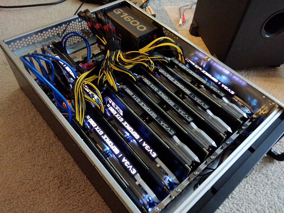

Here is another LSV4500 build i am doing with some tall EVGA GTX1080 Ti FTW3s / SCs. Note that there is a SC in the motherboard slot.
Newest build for a fellow [H] miner.
8x 1080 Ti EVGA SC2 / FTW3s on a LEPA 1600w unit ::::
+100/+352 @160w, ~1500w at the wall.
Equihash DSTM sample numbers: ~5.3 kSol @650-670 Sol. ~4.05 Sol/W average.
thebufenator It is a Rosewill LSV-4500 and a Spotswood GPU Drop-in bracket.
The case is roughly ~110, and Spotswood's bracket is 74 shipped.

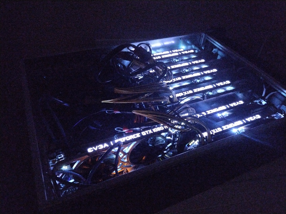

i've always wanted to do this but my fear is that the cards can't breathe? they're so close together or is the constant airflow enough? this is great for space-saving but i prefer open-air and spaced out (assuming you have the space).
Yes - the trick here is that the heat is localized to the front of the case and evacuated almost immediately by the 3 fans up front.
Two things have to happen to make this whole deal work - 1) The fans are pushing air out of the front of the case 2) These fans move serious air.
Works great! This is actually build #5.

high cfm fans means noise; how's the noise level? is it like server-room noisy?
