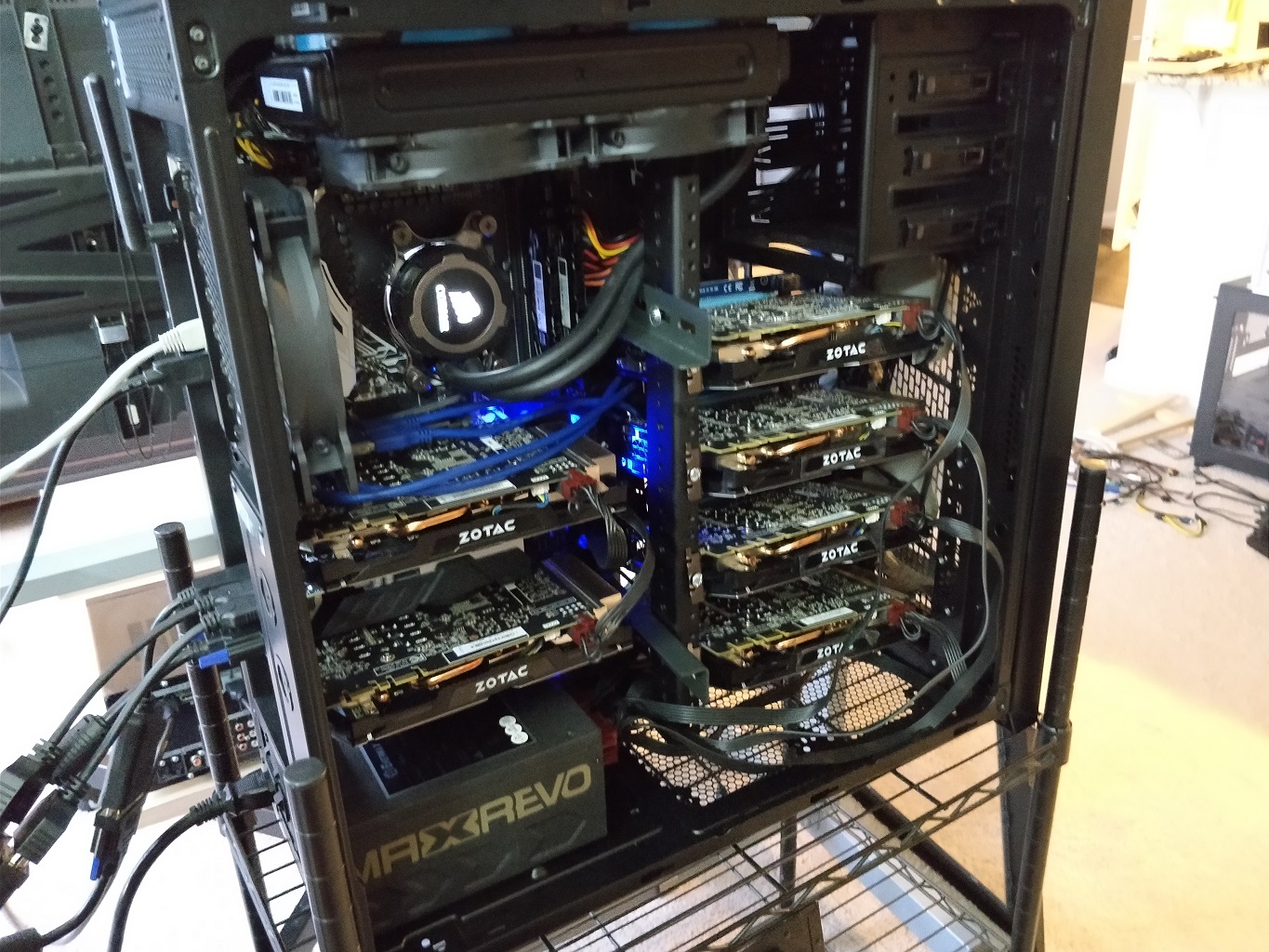

Also, retrofitted my workstation in pseudo-ghetto fashion:
  • Obsidian 750D airflow ed.
  • x6 Zotac 1070 Mini (4) on pcie breakout card / v7 risers
  • Eneremax MaxRevo 1200w
  • 1700x / Asrock x370 Taichi / 32GB DDR4
Far from *ghetto* ( i hate that word for some reason.) That's pure engineering! I've got a 750D airflow and that never crossed my mind
