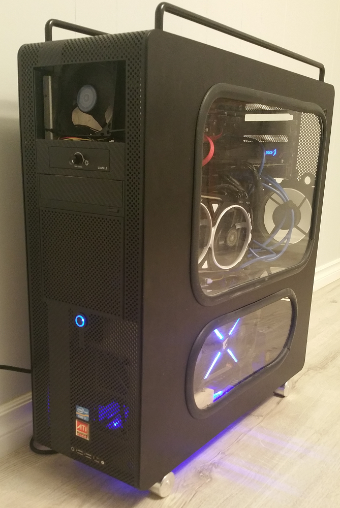

Got to bring my Lian Li V2000 out of retirement, hence the old school ATI case badge. Man i love this case. Managed to cram 4x1080 Tis and 2x1060 6GB into her. Temps are manageable for now and top out at 70 DegC, keeps the downstairs guest room nice and toasty.

_r2h nice! How are temps/performance?
Higher than I'd like, I tried some 55'ish CFM fans, only have 1060s in there, still need more cfm. So looking around for some 80-100 cfm. If i had a spot to put something stupid loud, I'd just get some 200+ cfm like you and others have done.
