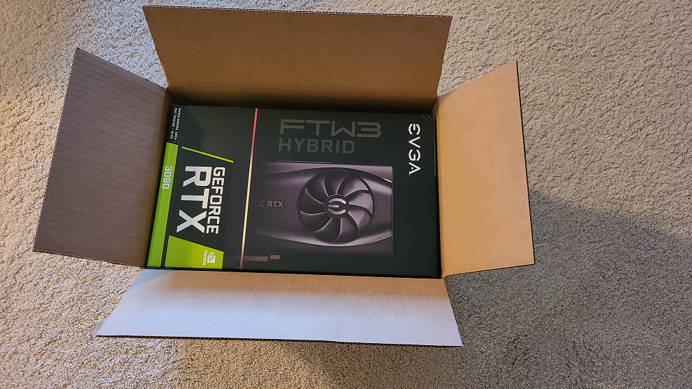

A mysterious package arrived today. What could it be...
GTX 1080 ------> RTX 3090 😈
Nice! A word of advice, check how the load balancing is on the card. Quite a few 3090 FTW3s suffer from a load balancing issue. The PCIE slot ends up drawing 80W+ and the third 8-pin will pull under 100W. Causes overall power draw to be much lower. The 3090 FTW3 I had suffered from it and as a result didn’t even outperform my 3090 XC3 that cost $200+ less. Ended up returning the card as I wasn’t going to settle paying hundreds more to get the same performance as my XC3.
If it suffers from it, see if EVGA will RMA it. I believe if you RMA within the first 30 days then they’ll send you a new unit. But I would confirm with them.

How did you measure that?
Mine seems okay so far. I haven't had a lot of time with it but it's been stable. For brief moments the PCI-E slot will hit 78 or 79 then drop down. Hopefully that's not too high.
