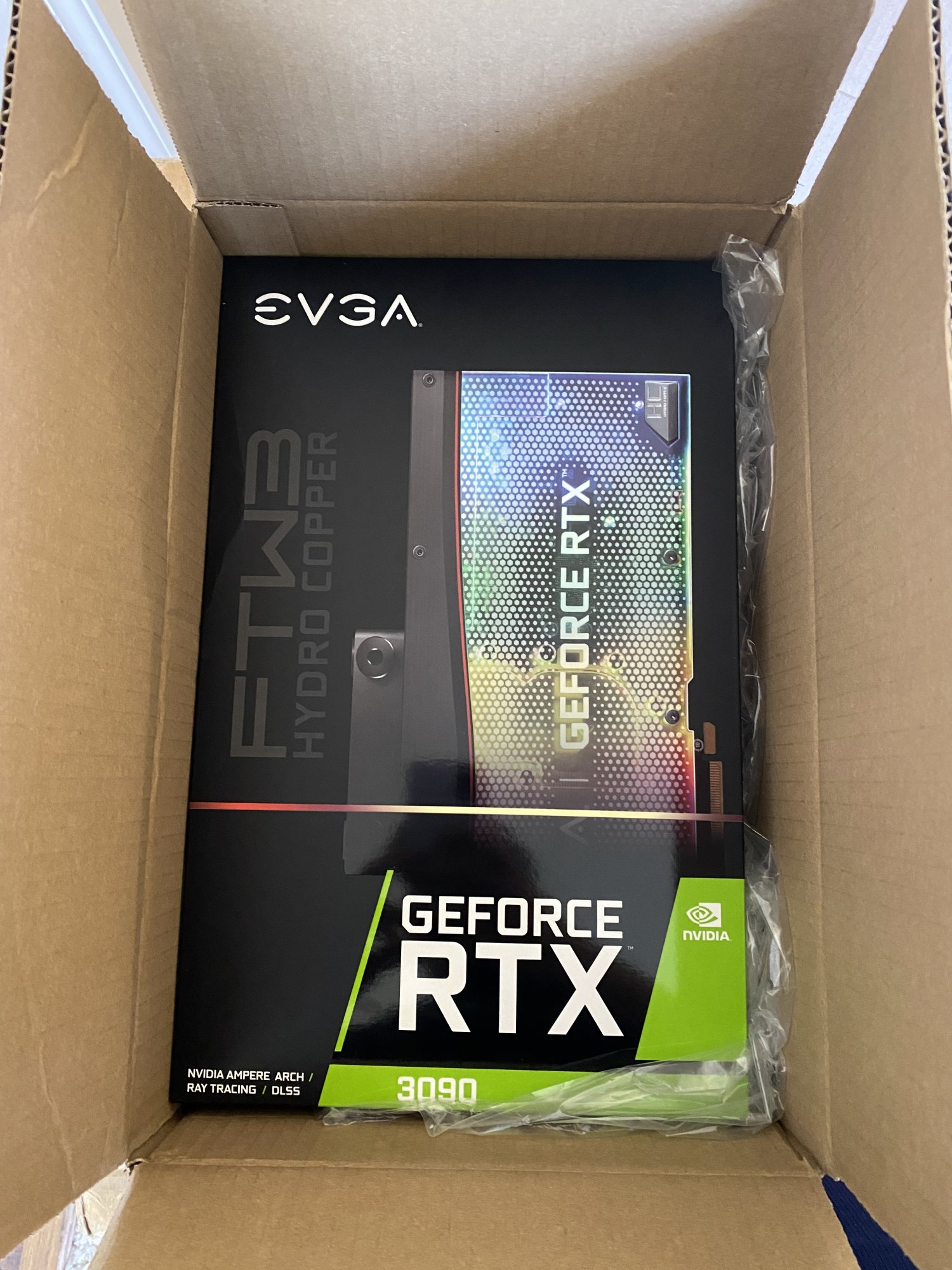

Where did you buy one? And what's your GPU clock speed in games ?
thx
EVGA queue. I was in the first batch.
I can’t give you an answer for clock speed because that varies from game to game and settings to settings. Name a game and the settings and maybe I’ll test it out.
