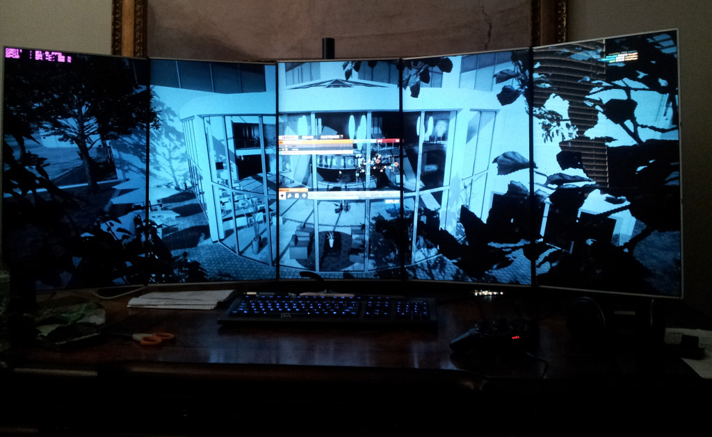

I am still having PTSD nightmares from running 5x1 setups back in the day and having displayport adapter hell on monitors 4 & 5.
Well, isn't 4k120 Full RGB 8-bit what you were trying? Or were you trying 10bit, or 444?

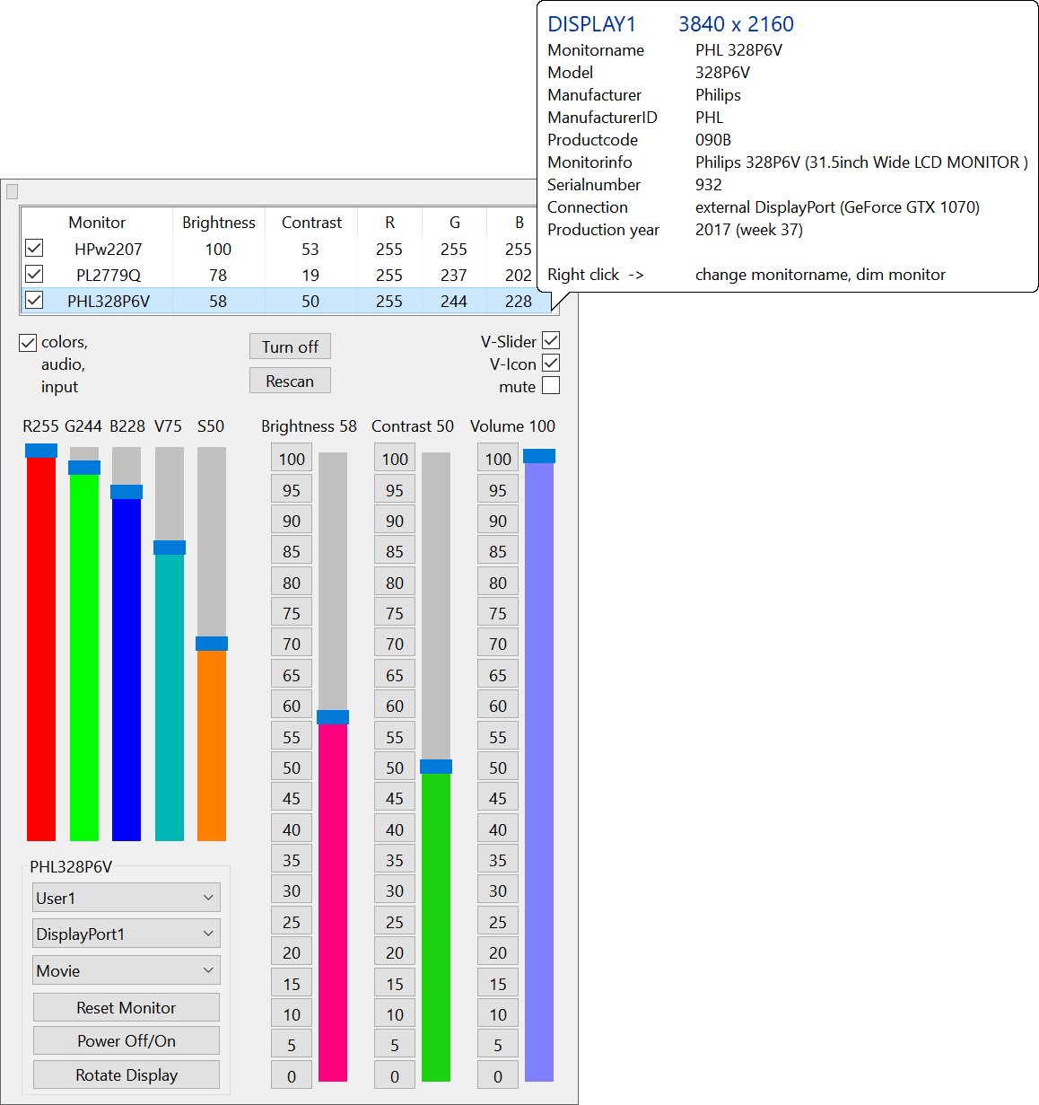

I use "turn off the lights" addon in my web browser (available for both firefox and chrome).
It does a dimming overlay at whatever default dimming level you set. You can also optionally have a brightness slider show up on the page that you can click to a small square to "minimize it". Turn off the lights remembers your settings per page and you can make a whitelist or blacklist (ironically named in this instance) for sites you don't need it to operate on. It can also show video frames without dimming them even if the rest of the page is dimmed, and you can set links on pages to click through the overlay so that they work normally.
I also use an addon called color changer which has a quick set of sliders in a drop down with a color wheel. It also remembers settings on a per site basis. It's very quick to change the background , text color, and link color with 3 sliders and a color wheel if you want to get picky. I usually just slide down the background to grey and slide the text to whatever contrasts best with that background.
Both of those addons would work well for your contrasted text issues. Turn off the lights can be active on every page by default (which I prefer) and you can also click a little lightbulb icon on the browser toolbar to active/deactivate it on that page if you want to. It's pretty much set and forget once it's set up though I like to have the brigthness slider available on the bottom right of web pages personally.
I use a 3rd party text editor and a 3rd party dual pane file browser which are highly configurable including colors. Besides that I use dark themes in every app I can, and I use dark/grey windows themes. There are still some apps that use white backgrounds or are otherwise harsh no matter what though.

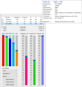

This clickmonitorddc app below lets you set hotkeys for a lot of monitor parameters (including brightness, contrast, saturation, R, G, B) on a per monitor basis. It can also launch and run with parameters based on what app you run using it's autorun feature.. and a lot of other neat things if you want it to.
https://clickmonitorddc.bplaced.net/
You can change color-profiles, select monitor-inputs, reset monitor, power off/on monitor, dim monitor, set monitor-speaker-volume, set system-volume, rotate display and set saturation/vibrance. You can do this by user-interface or by command-arguments.
ClickMonitorDDC requires Windows 7, 8 or 10.
You use this software at your own risk, I disclaim any responsibility for any harm.
You are allowed to use and spread this program for free.
Monitors and parameters
Hotkey method of activating parameters
Setting parameters per fullscreen app while running, reverts back when not fullscreen.
You can see the parameters per app on the right under the "command line" heading.
hahaha ......
I had 3 x Toshiba 40" 1080p displays on my desk maybe 4 years ago, no issues other than ... retina sear occasionally
