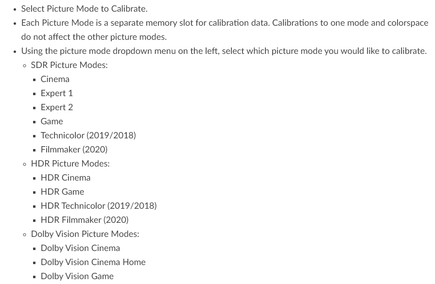

CX now supports AutoCal and using game mode does not lock you out of color management system. And you even have access to 22 point white balance. You basically took your experience with the C7 then made a blanket statement about all the LG OLEDs.
Oh, wow, if it supports the AutoCal, then this is another story. Of course. Just get an X-Rite i1Display Pro and you are golden.
Also, I specifically stated that I was talking about C7.
This is a big plus for me that it now supports the hardware calibration. This display is my plan B in case all the Acer Predators X38s are flawed. Hardware calibrated 120hz 4k OLED, oh man... That's freaking hot.
That's what I said, you're basing this off the C7 experience. You wanted to use ISF mode on the CX with the hopes that it has low input but it's really not necessary anymore.
I rather contemplate, basing off my C7 experience, but with no blanket statements about all the LG OLEDs.
It looks like game mode does lock the gamut selection to auto though.
It doesn't matter, if the Game Mode can be calibrated. On my C7 AUTO is sRGB. But when I calibrated I set it to Wide, since it was slightly larger than sRGB color space and was easier to calibrate. The AUTO has slightly smaller gamut than sRGB. It was hard to pull some colors that were too deeply inside the sRGB triangle... But it was obvious that AUTO was supposed to be sRGB.
Alright fair enough. It's just that from your posts about the C7 then following it up with saying you wanna use ISF mode on the CX made me think you were already writing off game mode on the CX as equally bad to the C7.
I would right it off if Game Mode couldn't be calibrated and didn't have the Color Management System. But it looks like it does, so everything is more than just fine with the Gaming Mode on the CX.
I would just like to see the proof that exactly the Game Mode can be calibrated, and not some other preset, and if it does, can it be calibrated in HDR format via the Calman AutoCal...
Pay for my calman license and I'll try for you :p
https://kb.portrait.com/help/calman-home-for-lg-walkthrough Calman certainly says you can in step 4:
Now whether I want to spend $145 for a license...
