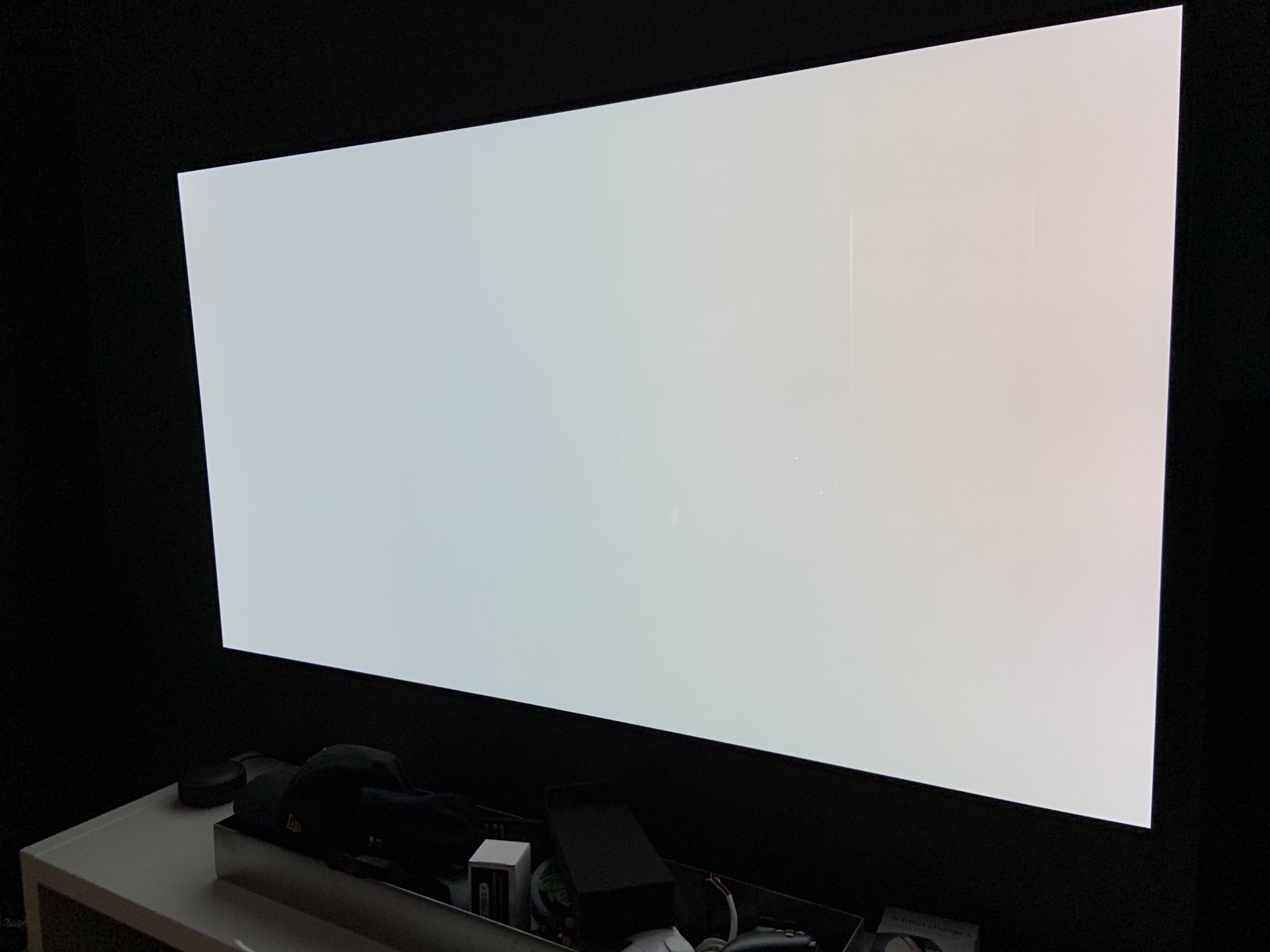

My 55B7 behaves exactly like this. I notice it when I'm walking by, but not across the room on the couch; I haven't tried to put it to use as a desktop display given its location and that I'd need to move my gaming desktop rig over to put it through its paces. I did use it briefly while doing some testing (only 'spare' monitor at the time), and for stuff like navigating UIs and terminals, it was fine.I took a quick shot of my 65" C7 while on a gray background. I was at about a 45 degree angle and maybe 3ft away. If I were to walk left across the screen, the "red" would move with me. From 6-7' away and centered, it's far more difficult to perceive.
My C9 doesn't look as nearly as bad as the C7, and the camera makes things more pronounced than I see with my eyes. I find it hard to imagine anyone being bothered by it in normal situations...I hadn't even noticed it.
