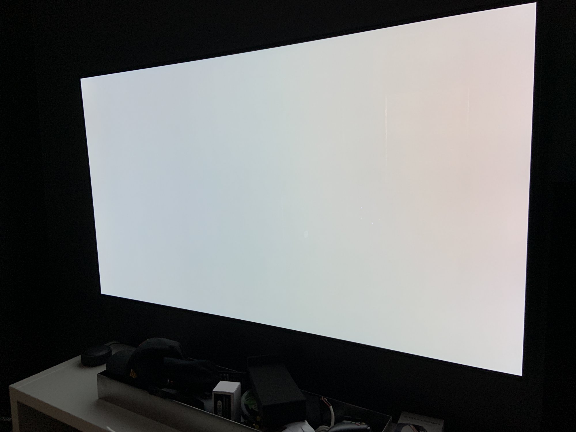

I took a quick shot of my 65" C7 while on a gray background. I was at about a 45 degree angle and maybe 3ft away. If I were to walk left across the screen, the "red" would move with me. From 6-7' away and centered, it's far more difficult to perceive.
My C9 doesn't look as nearly as bad as the C7, and the camera makes things more pronounced than I see with my eyes. I find it hard to imagine anyone being bothered by it in normal situations...I hadn't even noticed it.

Yeah exactly. Very VA-like. I just didn't want to make this comparison to avoid igniting even greater storm. It looks almost exactly like VA gaming displays I used to run.
VA has an actual gamma shift, OLED is a color or more acurately, white balance shift. All tech has some white uniformity issues, LED lighting having a major effect. Edge lit LED panels can be worse than OLED. Screen coating also has an effect. Sitting here in front of my Sony X800H, it has a similar effect, due to edge lighting.
This image will show any gamma shift, the logo should be indistinguishable from the background if gamma is correct...
http://www.lagom.nl/lcd-test/viewing_angle.php

Great. The OLED color shift is now a common kn
Check the image posted right above your post - that is how the lagom test looks like on the C7. The red also moves with you if you move across the screen...

the OLED gets more crisp the farther away (within reason) you sit :geek:
That image is taken sidelong and at way too near of a viewing distance to be fair. Cameras also have their own bias as was mentioned up front. I wouldn't sit closer than 40" to 48" (4') away viewing a 48" and as a gaming/media monitor it would be directly viewed from that viewing perspective.
Thanks!....now I notice that too on the cx48, now can un see....ignorance is bliss.....
