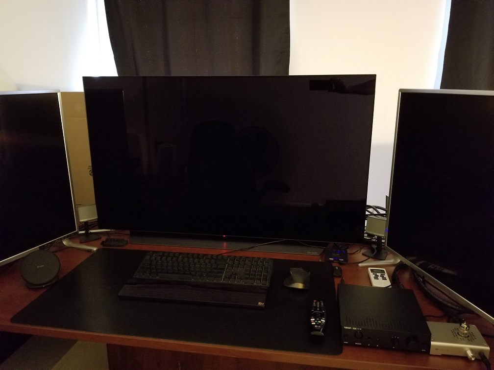

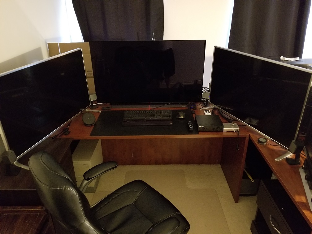

Got mine set up today and I have to say this thing is sick! I'm blown away by how good it looks. The blacks are incredible. Especially coming from 15 years of IPS gray/glow whatever. I have not seen problems with blacks with GSYNC enabled. It looks the same to me enabled an disabled. Hopefully that issue is overblown and not widespread. I'm really liking the size. I wasn't sure if it would be too big coming from 43" but I have to say it's perfect. Especially when gaming. I have it at the same 22" away that I had my 43" at and it's just right to fill my entire FOV while gaming. Anyway here it is in between my two 43" Wasabi Mango UHD430's.
Awesome.. I have a 43" on each side of my 31.5" 1440p VA right now. I measured the current array length and it is about 7' long. With the added width of the 48", I am thinking I would turn the side monitors into portrait mode. When I figured it out I was suprised that combined length of the array would again be 7'. :)
I have a separate desk on casters that I keep in front of my main desk though so I can see all of the monitors better. It looks like you are inside of your monitors the way you have it there. o_O
Very cool to see the monitors and same sizes all together though. Thanks for posting the pictures.
Sure no problem! I'm happy to hear that someone else is going with the 2x43" +48" setup. It's interesting that you are going to go with the side monitors in portrait. I think they may be a bit high for me like that but I haven't tried it yet so I don't know for sure. I like the side monitors in landscape because I like to use them as TVs a lot. I will put on a baseball game or TV show on one side while I'm working on the middle monitor and other side. I's nice to have them all the same to switch easily and have full screen 4k/1080p content. I may end up moving the side monitors up to be flush the the CX 48 so they are a little closer though. I will just have to remove the stands from my speakers. It's fine the way it is but will be less of a waste of space, will look better and of course fit better in my field of view. I don't know if these pictures from my phone translate very well but here's a few in-game pictures.
