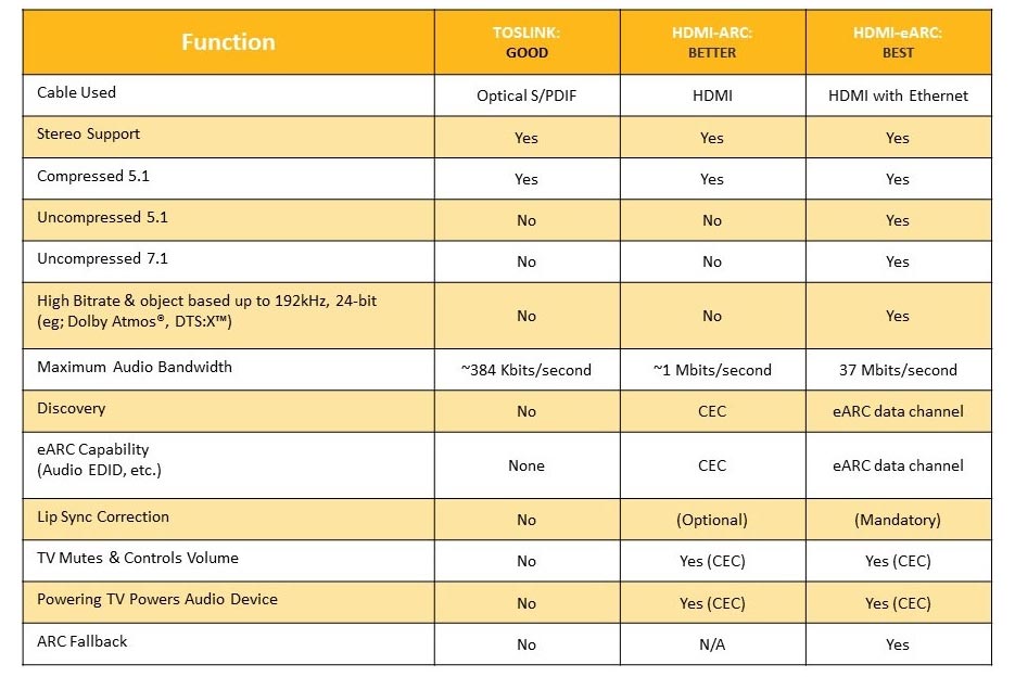

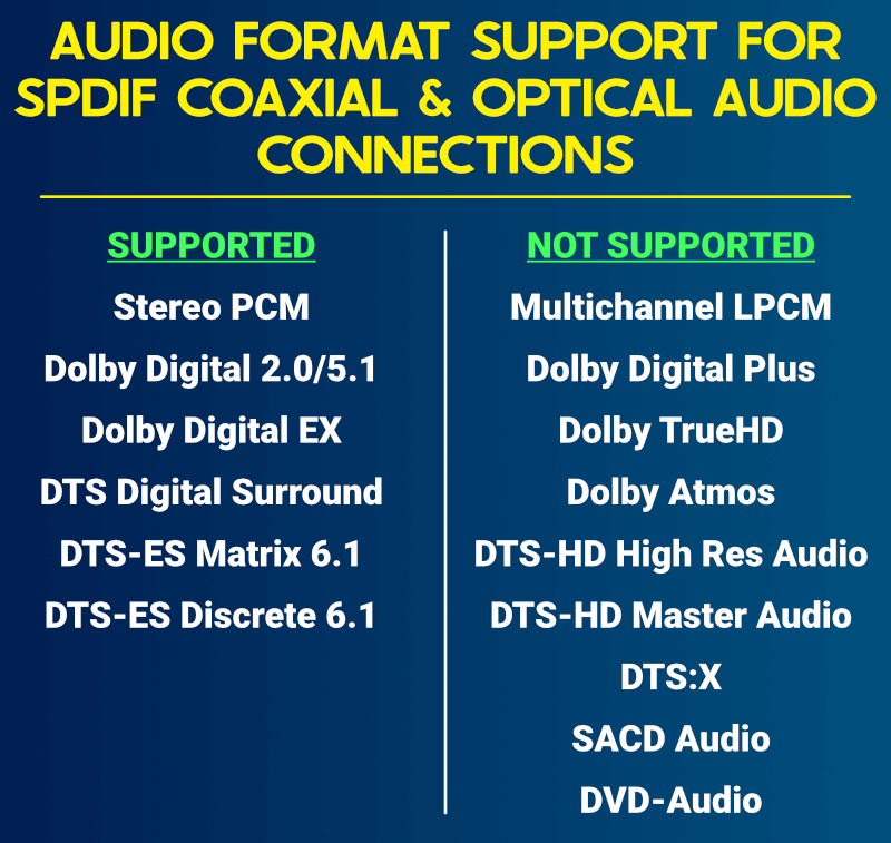

Audio passable over spdif/optical audio cables in general (not in regard to LG OLEDs):
Audio format support chart for Toslink/optical audio + Arc + eARC cables
LG CX/C1 audio format support per RTings:
Audio Passthrough:
ARC = Yes (HDMI 2)
eARC support = Yes
Dolby Atmos via TrueHD via eARC = Yes
DTS:X via DTS-HD MA via eARC = No
5.1 Dolby Digital via ARC = Yes
5.1 DTS via ARC = No
5.1 Dolby Digital via Optical = Yes
5.1 DTS via Optical = No
To enable eARC, go to Select HDMI Input Audio Format and choose 'Bitstream'. Then set Digital Sound Output to 'Auto' and toggle eARC Support.
