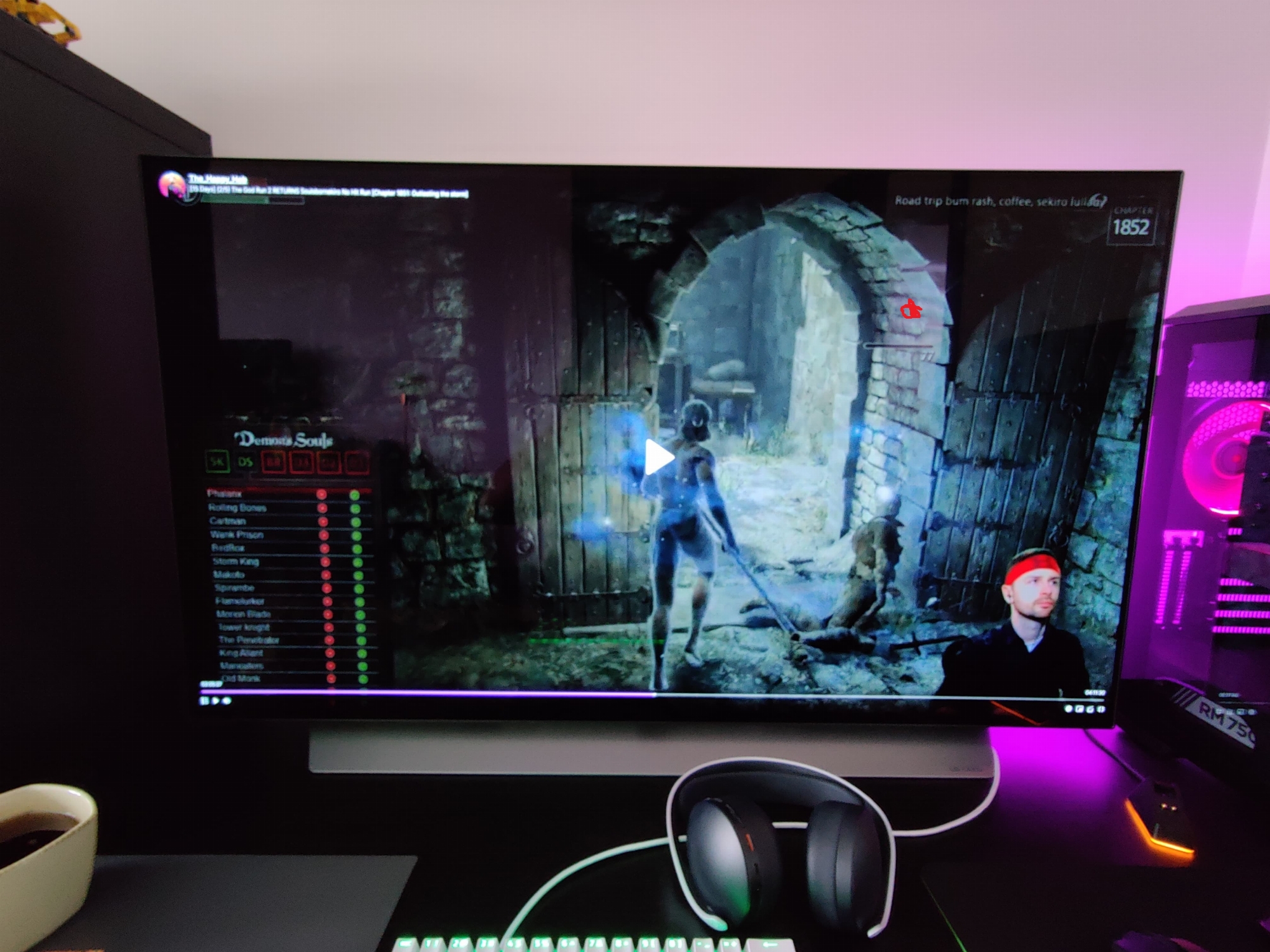

Freaking nightmare just happened for me. My windows screen saver is suddenly not turning on, and my triple 48's stayed on for the past 18 hours or so with my windows and icons. I have image retention and possibly burn in on my center screen from a white box that was on a web page, a small notepad window, and even my desktop icons, which I have religiously moved around to prevent this issue.
Has anyone run into something like this? I see the LG pixel refresher in the menus but don't really know what it's about. What can I do?
I am gutted. I've been very careful to date. I can move my main screen to the side and center one with no burn in. But UGH. So gutted. It's only noticeable with flat colours. But that's like the sky for me in driving sims. I'll see it.

There is an "auto off" setting in the TV, highly recommend you turn it on. It can be annoying at times but it's worth it
Definitely run the pixel refresher

Ok. I am 20 minutes into the pixel refresher and will report back. Any use in running that several times if I still see stuff?
I will look for auto off. Thanks for that! I gotta figure out why my screen saver isn't working. Power management used to turn them off at 30 minutes too. Not working. I did a windows updato to no effect. I will try unplugging USB stuff.

I would try to avoid running the pixel refresher consecutively because the voltage cycling it does will wear out the pixels faster. The TV will automatically run the refresher when it's turned off after a certain number of operating hours, so there is usually no need to run it manually unless situations like yours happens. If you're paranoid just manually turn the TVs off when you walk away from your PC.

Yes, do not run the voltage refresher often. I would actually recommend you never run it, as the TV will run it itself from time to time, and thats usually enough.
Turn the OLED off and give it some time. I highly doubt 18 hours of static content caused permanent burn in. Leave it off, let the voltage settle, and see what it looks like,.

Ok, guys thanks for all the tips. I am happy to report the image retention is gone. Thank god. I will look for the auto off and try to find out the reason my screen saver and power management is not working. Appreciate all the help!

Ok, I found the auto off timer which was under "timers". The 4 hour automatic shut off was already selected. But maybe it only functions for use as a TV and not desktop use?
EDIT: Also unplugged a bunch of USB's. My screen saver and power management works again. I will spend some time later checking for which device it was. If you guys run into your SS not working, definitely unplug stuff and find out what's keeping the computer live.
Whew, ok. Carry on!

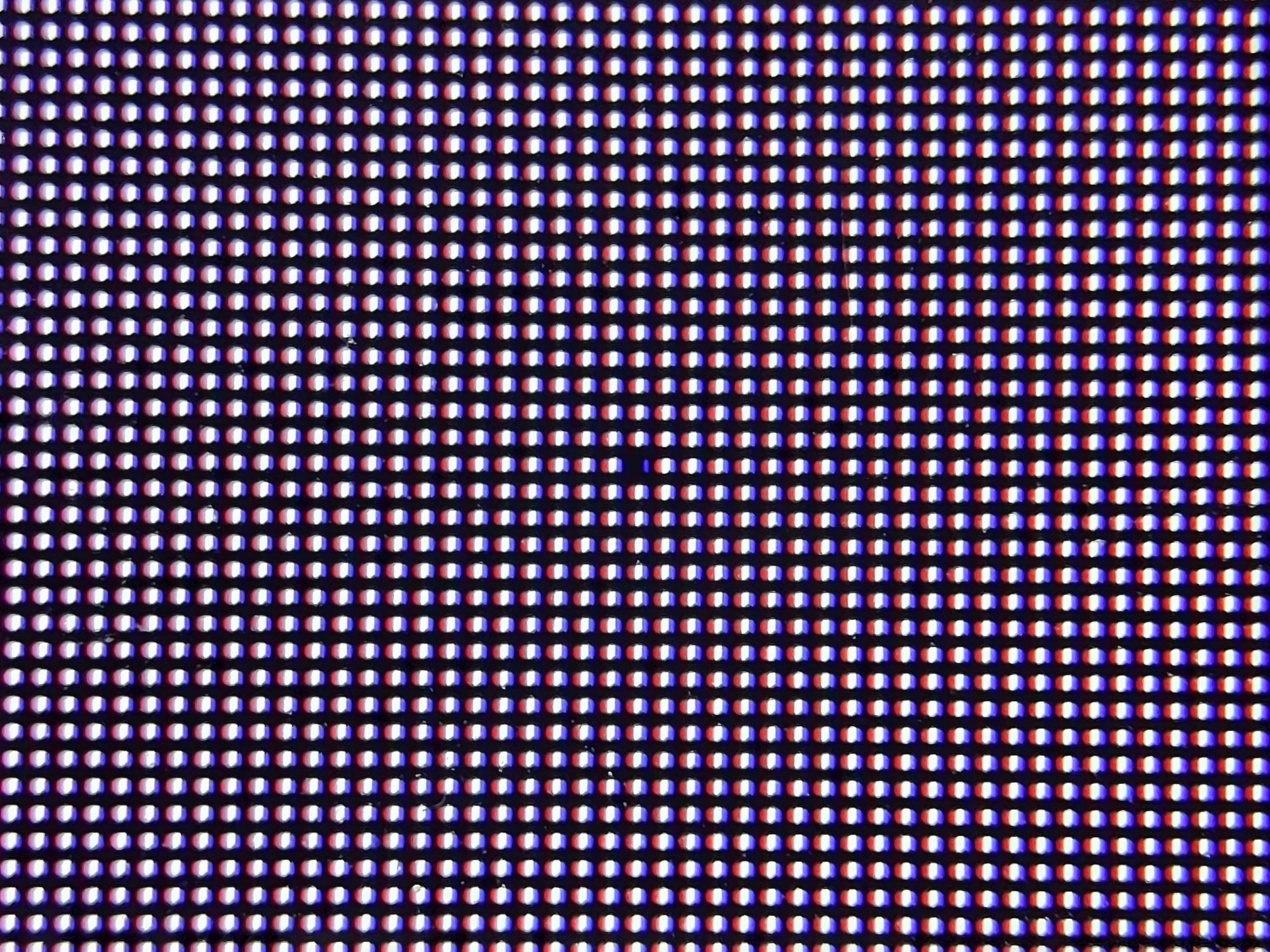

Still conflicted if I should return my 48" c1 with 2 dead subpixels in 1 pixel... probably not.
Is there any chance full pixel refresh will wake these pixels ?
btw, this is where it is:

You really do have to abuse the screen in order for there to be permanent burn-in. It's actually "burn-out" where the pixels dim to the point of being noticeably darker than the rest of the screen. Image retention can usually be solved by simply turning off the screen for a while or running pixel refresher.
Glad to hear all is well.

Dude, return it. It's a to of the line premium tv. You paid for excellence
I've ran full pixel refresher once to maybe fix the dead pixel but it didn't do anything.
In the end i think I better chill out. It's not worth to replace it probably... and I would have to give back LG fn7 wireless earbuds which I got as a preorder gift

No you wouldn't.
Are you that scared to make a phone call for an exchange? Do you not value your hard earned money?

I did in fact. The store said I can just return full order and order again (or from another place), so then I give gifts back too. They cannot offer me an exchange for new unit. Only return.
Or I can contact lg at any time and they would swap the panel. If I am to do that, maybe it's better to do after a year when more problems appear.
I agree about money and stuff but in the end let's not go too crazy over this. Now even if I ignore earbuds, I need to move the desk, pack the unit, return and pay for shipping, wait for money back and hope for better luck on next order. That's almost a month of inconvinience.
Anyway - I know You are right but there is some merit to just trying to fight with ocd and be chill

LG doesn't have a defined number of acceptable dead pixels, so it wouldn't hurt to contact them about it. They will probably ask for pictures of it so they can determine whether or not a replacement is warranted. Two subpixels may honestly not be enough, so if you're still eligible for a full return at the retailer I would take it and just buy another one. I find any dead pixels unacceptable no matter the type of display.

I find that dead pixels are not as bad as subpixels getting lit in the wrong color. I used to have a bright red pixel on white background happening on a 30" Dell I had and it was annoying. Also if the dead pixel is anywhere near the center it's going to be a far worse problem than one on the edge of a display.

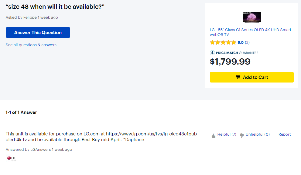

One of the other retailer websites on their site said it was available now, I never actually went through to try to add it to cart and see if was actually shipping though.
