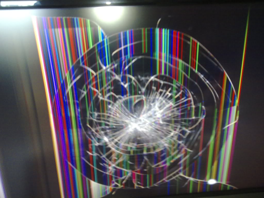

Another weakness of the Alienware 55 Oled is it did not hold up when my woman threw a shoe at my head, missed, & smashed the screen.
Stupid Dell / Alienware not building monitors to withstand projectile high heels!!!!
True story? What did you do to get a shoe thrown at you lol

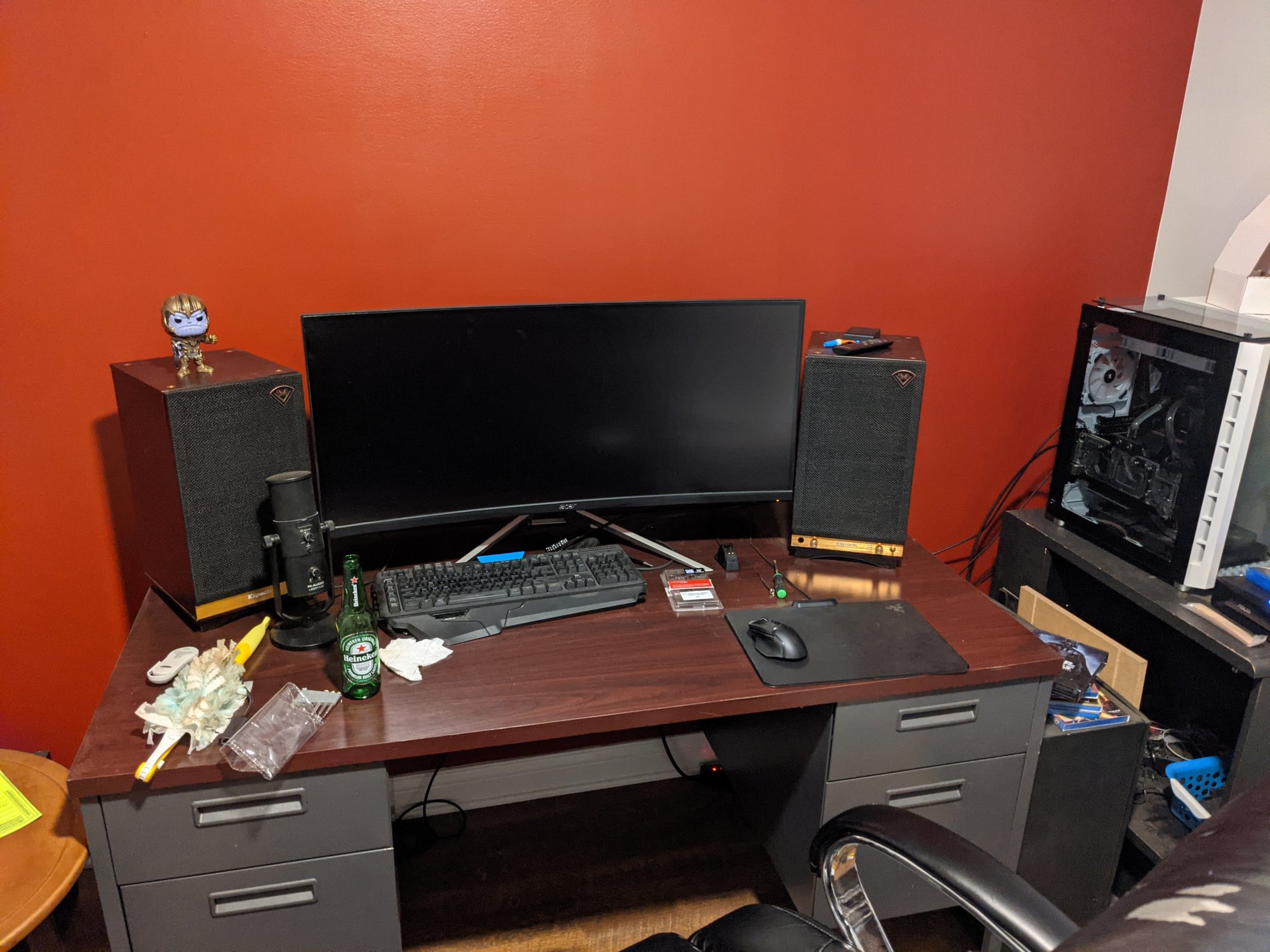

So the question is..is this the right monitor for me at 48"?!
Yea...same woman put her fist thru my first Gateway XHD3000 way back in 2009-2010ish.
XHD3000's are not fist proof and AW55's are not stiletto proof!
It sucks ass when you watch $4,000 go up in smoke.

If you wall mount it, buy separate stands for your speakers and pull your desk back a good amount. Otherwise no, not with this desk.
I agree with the speaker stands.
I checked the dimensions, and it's only 4" wider and less than 8" taller than the 38" UW in the photo. I think it'll be perfect. I lean back when I play, not forward. I rarely play FPS anymore, mostly sim games and Diablo 3.
