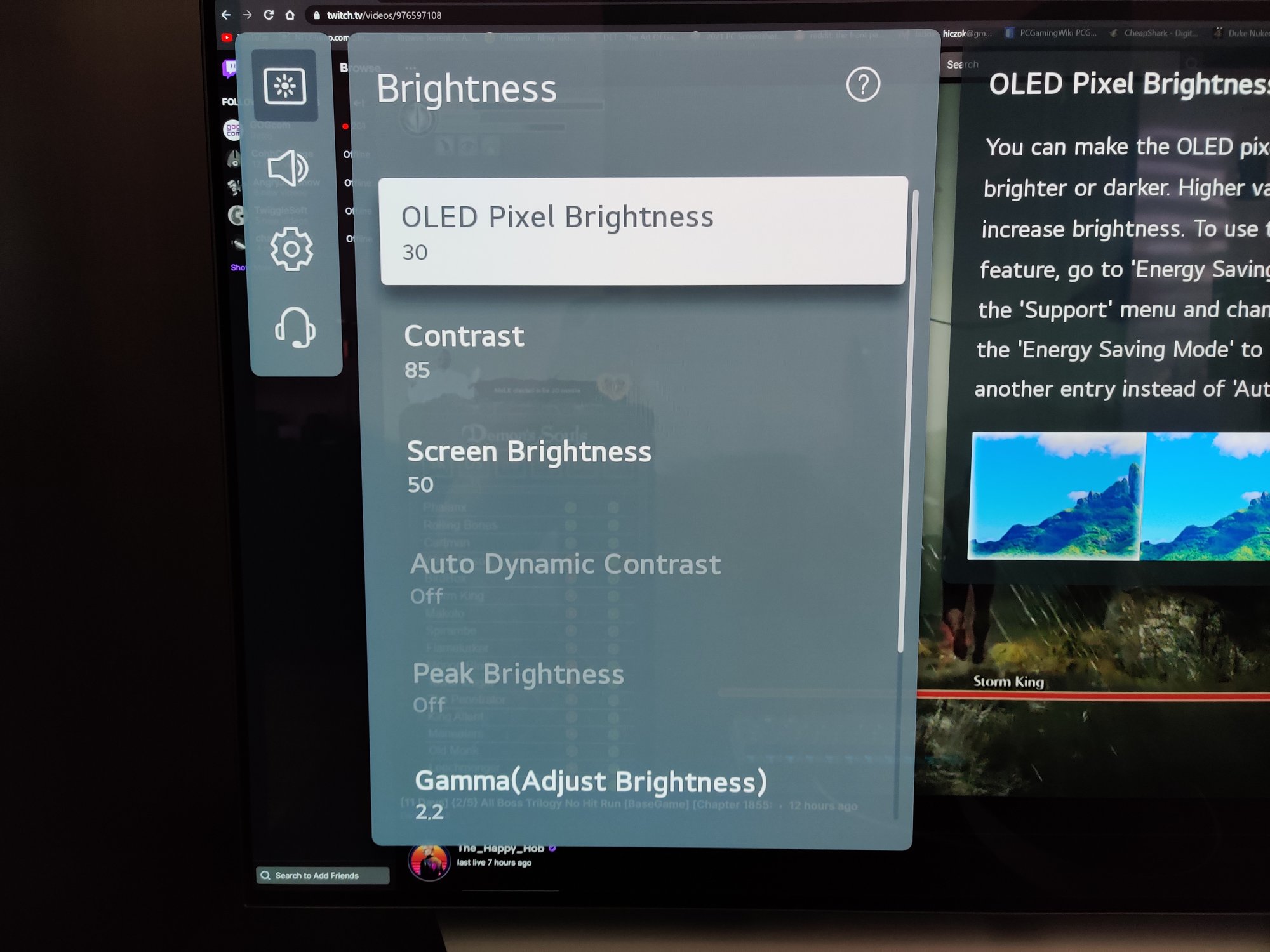

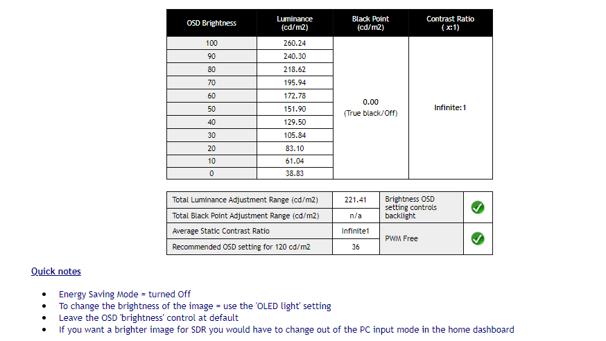

kasakka
Aug 25, 2008
2,194
Source:
https://www.tftcentral.co.uk/reviews/lg_cx_oled.htm#brightness
Since the C1 is basically unchanged from the CX the settings should be similar if you get one of those.
I think these will depend on the individual display. I don't have a calibrator anymore (borrowed from previous workplace) but for me it measured about 120 nits at 20 brightness. If it was as low as 83 nits it would be too dim for me. I normally use a setting between 20-30.

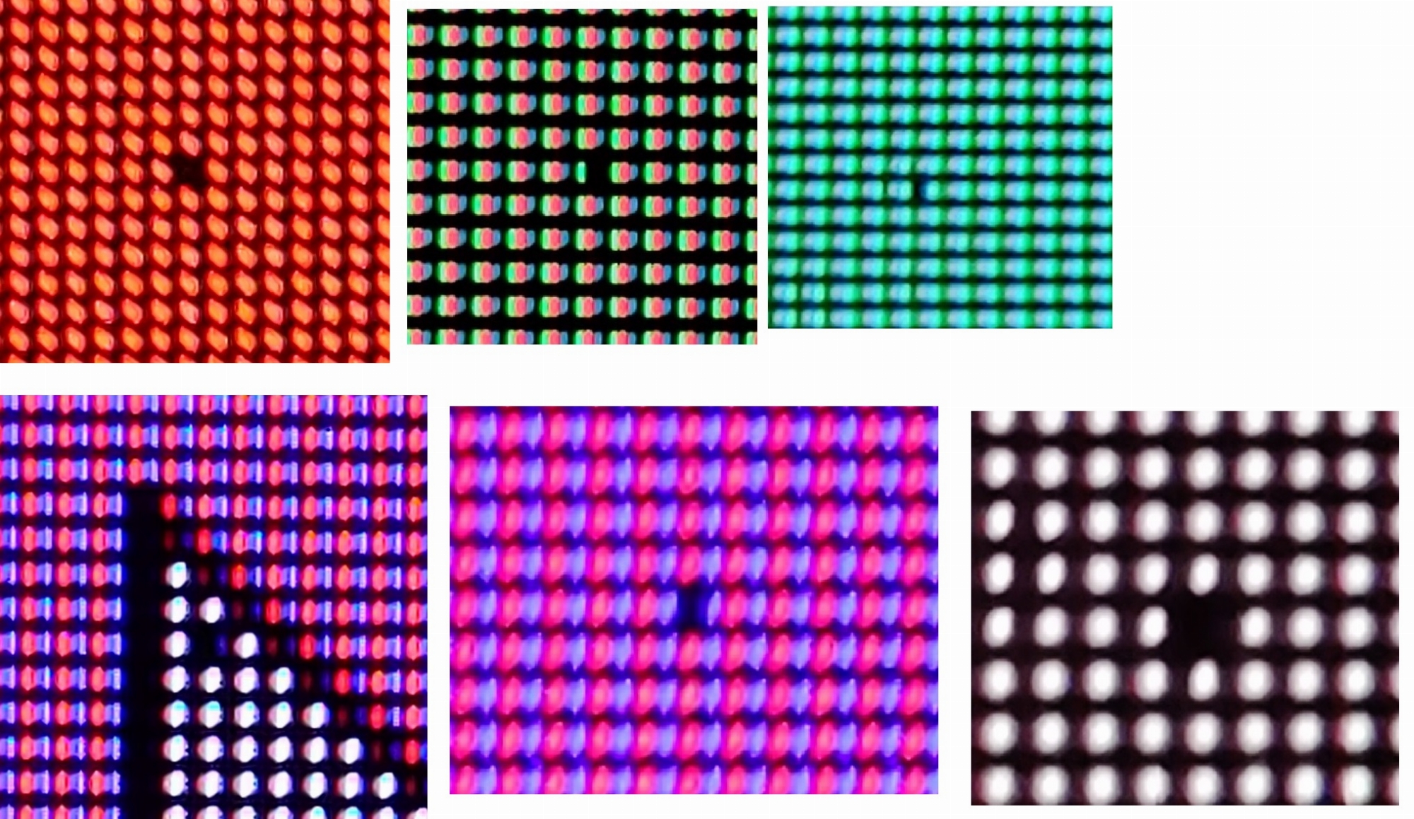

The LG's are really weird with dead pixels. From my experience, it's not like normal LCD's. I've had multiple 55" LG OLED's, and the dead pixels just come and go at random. I usually find 1-2 dead pixels on my screen, then a few months later I look for them and they're no longer there, but there's 1-2 dead pixels somewhere else, and it just repeats somewhere else. From my experience with LCD's, when you get dead/stuck pixels, they're usually permanent (even with stupid pixel refreshing fixes), and if they're not already on your screen the first time you use it then you should be good to go in the long term. I'm usually very OCD about dead/stuck pixels, it's a 100% return on my part usually, but the screen is so large, and I sit so far back, and they usually go away anyway, that it truly doesn't bother me. Just my personal experience though.
I took some more pics of this 1 dead pixel I have on c1.
It appears it's not the whole pixel dead. It's ok on blue or green but dead on red, magenta and white.
So maybe it's red and white sub pixel... no idea, the images I took on primary rtings colors only confuse me :p
I still don't find it reasonable to return the screen because 2 or 3 subpixels are not working... but I do notice it occasionally on sky or brighter colors and it's kinda annoying me
For the amount of money that these panels cost, I would return it.
I would but it's so much hassle to pack the tv back and wait for 2 weeks for money return so I can buy again elsewhere... and then get 3 dead pixels probably.
And the pixel is visible on reds and whites the most.
My buddy is getting the screen on tuesday. I will check pixels on his unit. If he has none, then I will return. The monitor is so good, I don't want to live few weeks without it again :p
And others said, the pixel might eventually maybe fix itself. Maybe I could run the full 1 hour refresher ?
