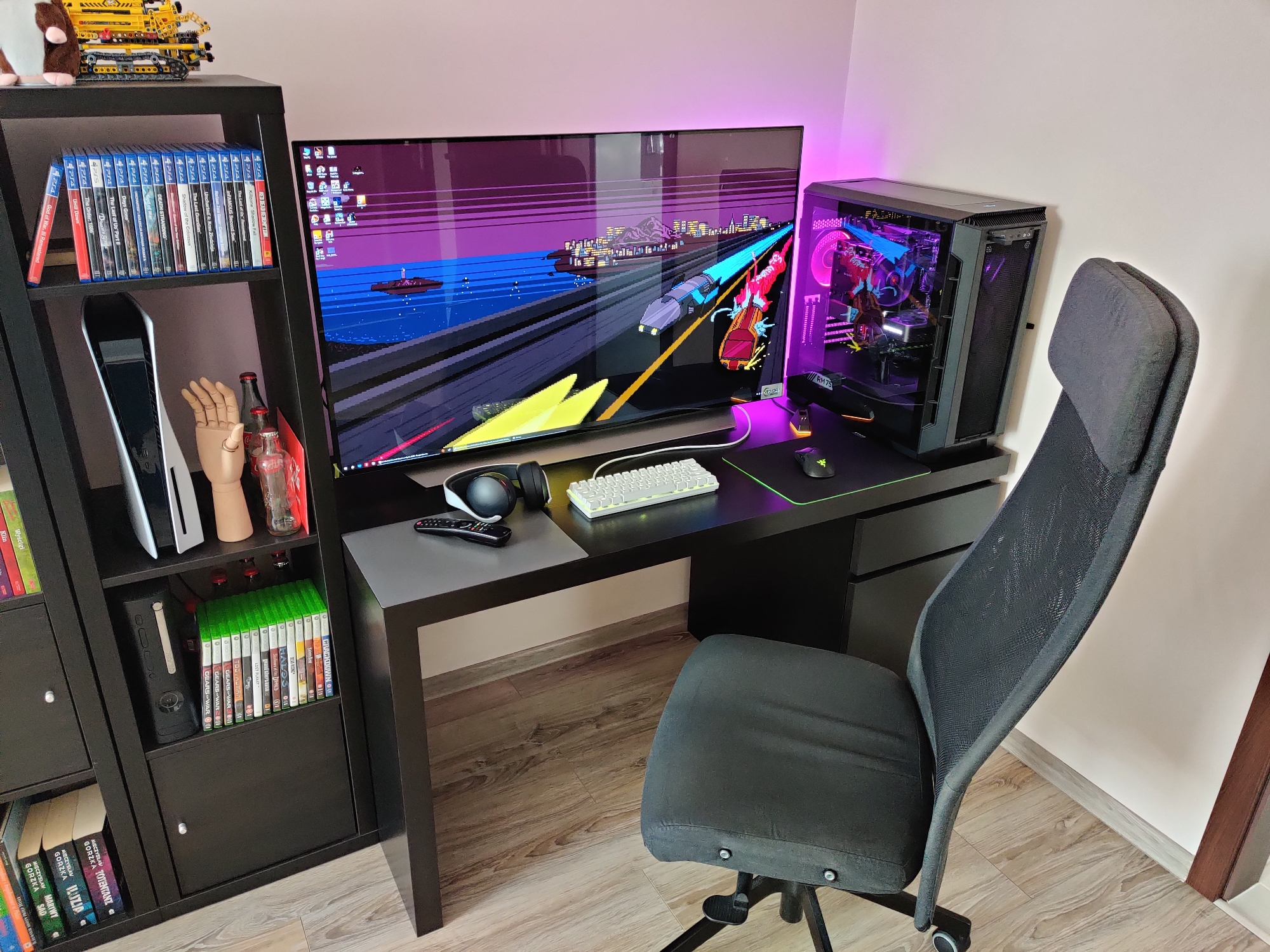

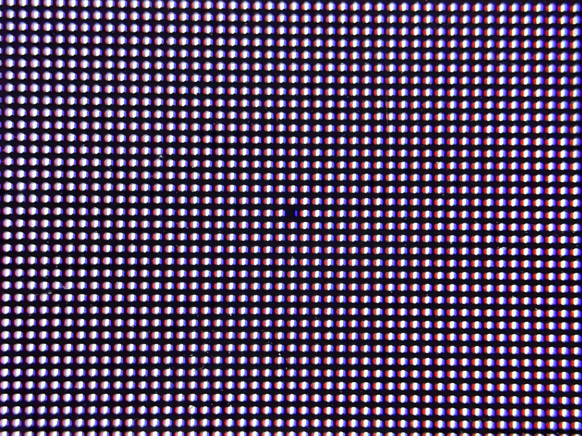

The tv is here and I've been using to a few hours. The picture and motion quality is downright stunning. Fantastic thing. Even sound is good.
I don't know if I will get used to it. I play leaned back. It's fine with controller as I can move back a bit more but with mouse and keyboar.. idk.
I know I sit further from the screen than I did to my 27" but is still seems more straining.
Also -I have 1 dead pixel.
Cali3350
Mar 22, 2002
4,699
I had the same experience. Absolutely amazing monitor that blows everything else out of the water, and works great for controller gaming. But I could just never get mouse and keyboard to work. What I ended up doing was buying a TV stand that fit right behind the desk - this one - and that gave me the little extra room I needed to make it work with mouse + keyboard.
Unfortunately, it made my standing desk useless, and I am one that actually switches between modes a lot. So I ultimately sold it :(.
While I don't have a C1, I have a 48" 4K on my desktop and yours is closer than mine is by a good bit by the looks of it - that is a big factor in making it something I can live with it long term (for me). I know some others have adjusted to a closer depth and yet others have moved the monitor to a floor or wall stand and moved the desk out a smidge when the desk is not deep enough and you don't feel like changing the entire desk.
Yeah looks really close to me. You need a deeper desk I think. At minimum, get an after market stand, you should be able to push it towards the end of your desk that way. I have an 80cm deep desk, with an aftermarket stand so it's about 70cm from me and I find this works well for mouse+kb. But still took some adjustment to get used to.
The LG's are really weird with dead pixels. From my experience, it's not like normal LCD's. I've had multiple 55" LG OLED's, and the dead pixels just come and go at random. I usually find 1-2 dead pixels on my screen, then a few months later I look for them and they're no longer there, but there's 1-2 dead pixels somewhere else, and it just repeats somewhere else. From my experience with LCD's, when you get dead/stuck pixels, they're usually permanent (even with stupid pixel refreshing fixes), and if they're not already on your screen the first time you use it then you should be good to go in the long term. I'm usually very OCD about dead/stuck pixels, it's a 100% return on my part usually, but the screen is so large, and I sit so far back, and they usually go away anyway, that it truly doesn't bother me. Just my personal experience though.
Your setup to me looks like it has a good amount of empty vertical space, so obviously the solution is to rotate the entire screen 90 degrees in a portrait orientation and use it as a 2160px wide display with a horizontal screen size similar to a 27" monitor. :p
...I mean, it could work, but in the last 6 months or so when I came up with that idea, I've realized that most people seem to much prefer the "immersion" provided by the larger screen to the point of people even using it in conjunction with a custom ultrawide resolution like 3840x1600, but of course running it in portrait eliminates that immersion.
Perhaps it's just my insane suceptibility to motion sickness that makes any such "immersive" view-port typically a complete non-starter for me and so my train of thought never even goes there.
But yeah, outside of my crazy "run it in portrait!" idea, there is the option of running a custom ultawide resolution in order to make it have a smaller vertical size in-game. 3840x1600 should have similar vertical height to a 35" 16:9 monitor while 3840x1080 would have similar vertical height to a 24" 16:9 monitor. Perhaps a balance between the two would be ideal, such as 3840x1280 and 3840x1440 which should be a similar height to 28" and 32" 16:9 monitors respectively.

Ok I got used to the 48" c1. I am keeping it. That 1 dead pixel is ok. I notice it only when I look for it up close on white background.
I got Free 150usd headphones with the tv (lg fn7) so I can let it go :p
Anyway, I only peeled the protection film from front and back today. Hope it did not caused any damage. I used the tv about 8 hours before I decided to keep it.
btw - there is no more warm 1 and 2 like in reviews. now there is a slider which goes from 50 cold to -50 warm.... so I keep it at -20 so far.
DO I need to change SDR contrast? It defaults to 85 in pc game mode. Oled light I set to 25% for sdr for now
btw I don't post too often but I've been here all these years. Back in 2007 when samsung 226bw was all the rage. Look where we are now! It is special to always share new display info here
