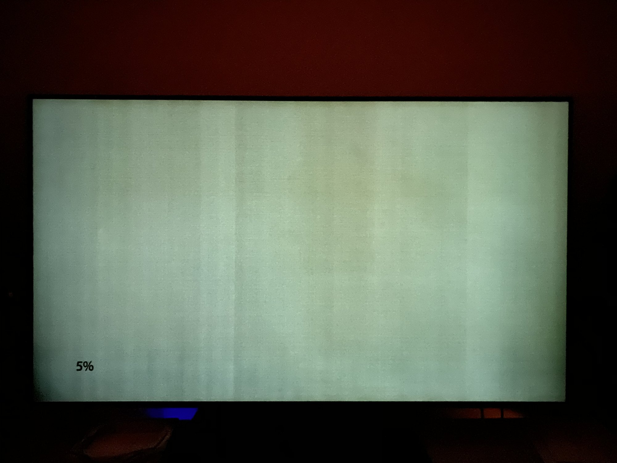

So 2 months of CX usage, the one thing I've picked up on is there is a noticeable vertical band just left of center on my screen. I didn't go looking for it, but it shows up in some games with lots of greys / dark greys. I've probably only noticed it a few times, but obviously now that I saw it I notice it more often. I finally ran one of those grey banding tests on youtube and good god - I don't recommend running this if you are a perfectionist. Obviously I can see ALL the banding with these tests, but it's really only this one band that I notice in actual usage - I can see it pretty distinctly even in 20% grey tests. I also noticed some non-uniformity but only at 5% grey (a distinct black patch in the lower left, which I had actually noticed when watching some TV shows, but very rarely). I guess these things are just normal for OLED though right? A bit of a bummer but I guess it's the way it is. I really don't want to play panel lottery.
You can see here what I'm talking about. I actually think from looking at other pics online my panel is very good - other panels all seem to have much larger uniformity issues with big black patches on the left side at 5% grey. It's just that vertical band just left of center that stands out in actual use. I'm hoping it gets better over time.
edit: disclaimer, this is overexposed to show it better
Have you run the pixel refresher manually yet? I think this is pretty normal and improves with time.
I have similar vertical bands, in my case if you divide screen to 3 vertical parts the middle one is the darkest and bots sides are brighter. I never noticed this in normal use.
Mine has definitely improved over time (and I’ve only had mine for about a month). Out of the box it had some very slight vertical banding. Now I can’t see any.
Yeah they all have it to some extent afaik. I can actually see it in normal content too, if I want to. But in reality it's a non issue a still far better uniformity than any LCD I've ever seen.

Also sad news, screen shift bug on Quickstart+ isn't fixed on the latest firmware after all. I caught it turning on when saying off today.
You must have had that camera exposure set to something crazy to get a pic that bright on 5% grey. :)
That's probably pretty good looking when viewed in person. Run it for a couple months and get back to us. I would not try sending one of these screens back for that, even if it is a little annoying. It should become very hard to see and nearly vanish as you go to 10-15-20%.

This is my 5% gray at max brightness. It's caused me 0 issues up to this point in any content.
No I didn't run it yet - as it hurts the lifespan of the screen, and I read it can even cause other vertical banding to show up (the pixel refresh runs on these vertical bands itself, it's why they happen in the first place I think due to the initial factory pixel calibration operating in columns). It's not really noticeable except in a few scenes and it's just the single band. So I think I just accept it for now. It's still way better than any LCD screen I've had.
Elvn, I know what you mean. When I look back and forth between my CX and my 47" VA LCD TV next to it, it's crazy how "not black" the VA panel is. And I keep it dialed WAY down for my dim office. You look back to the CX from it and it's like.... "oh, that's actually BLACK." The VA TV lives in a perpetual state of very uniform but very grey light bleed.
Oh it's definitely over exposed - long exposure on my iPhone in a dark room. It's the only way to get it noticeable in a picture. Of course the actual real life viewing is much more subtle.
You should probably put that as a disclaimer on the picture. (n)
