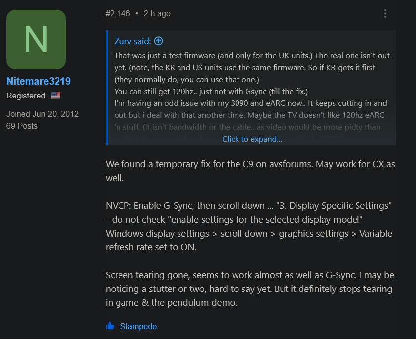

People with 30series over on Overclock.net are reporting they read somewhere on avsforum that if you ENABLE Gsync, DISABLE GSYNC on the TV specifically (uncheck "Enable settings for the selected display model"), and ENABLE VRR in the Windows display settings...the supposed 30series HDMI 2.1 VRR frame pacing issues are fixed. I don't have a 30 series to confirm/deny.
I've been going nuts trying to solve this issue but lemme give this a try and report back.
