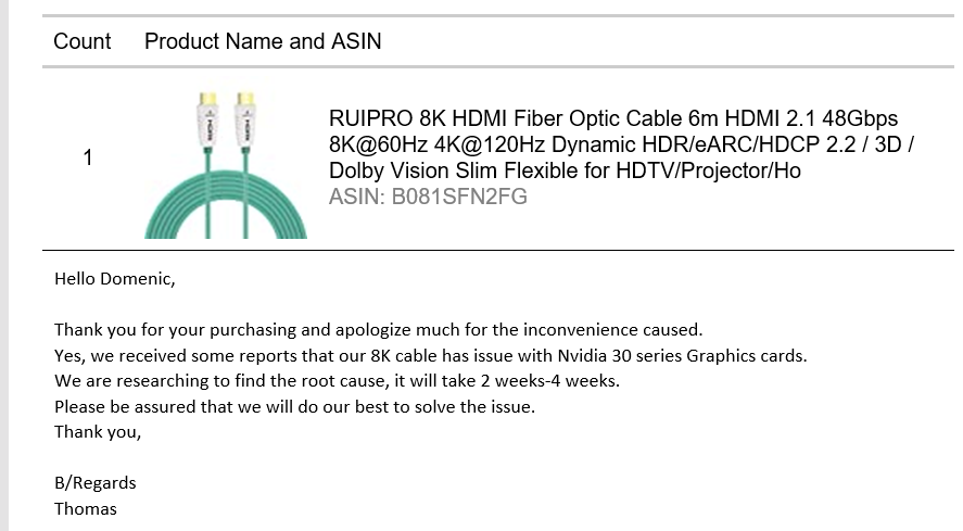

The black flashes is your cable I would guess. Had the same. I tried 3...had to find a high quality and no longer than 2m (cable certified for 10k at 2m and below). I'm sure if you spend a lot you can go longer, but it seems hdmi2.1 is rather picky. At least with the 30xx.
What is interesting with my cable issues is it worked flawlessly at 4k@60 on a 2080 (hdmi 2.0). Then the same cable at 4k@60 as well on a 30xx and it would cut to black once in a while. Sometimes it would go away for a few hours and then come back. New cable is rock solid.

I don't think any of the 2.1cables currently available are certified, they should have a hologram if they are

Yes the one domenic replied with originally is a fiber hdmi 2.1 cable rated for 48Gbps 4k 120hz. Theoretically they should work fully and be able to do much longer runs of 25' , 50', 100' but they are very expensive.
