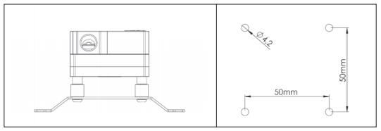

What is a DDC?
It is the most widely used water cooling pump on the market. Manufactured by Laing: link
- This type of pump is the most widely used/copied/licensed pump with good power at a small size. There are smaller pumps with lower power and larger more quiet pumps but this is the widely accepted best balance out there.
However, most people will use it in this configuration with a heatsink attached:
Total dimensions with heatsink and pump top are 63mm(length) x 68mm(width) x 55mm(height)
Mounting is with 50mm square hole pattern as below:
Technically, the size listed for the large tophat would suggest it is big enough to fit this. You could place the tophat above or below the udpated case design i believe. And with the tubing being horizontal this might fit.

But you cannot fit a DDC pump & a 240 radiator in the same L TopHat; and the tubing would only be horizontal if you use the stock Laing-style pump, go for one of the upgraded models with a heat sink & a pump top (like pictured above from EKWB) and you have one of the fittings protruding from the top of the pump assembly, increasing overall height...

Magic! Thank you for the detailed description and specs! As mentioned before we will work with some water cooling wizards soon and find some good places to add custom mounting possibilities before mass production. They should be aware of this pump, right?
But it seems like it will fit on top of the block, do you see a need for an alternative mounting position?

We have started the planning of the custom loop with the Swedish wizards =) DDC has been fed into that discussion and they have confirmed it's importance.

Best pump (IMHO) is a D5, lower noise & more pumping power; but that is a bulky beast, about a 90mm cubical bounding box worth of bulky beast...?
