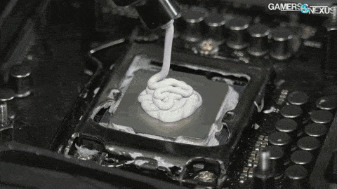

Im with GN Steve. I like to make sure all of the pins get covered too. Its like the bathtub in Constantine, it lubricates the transition.
