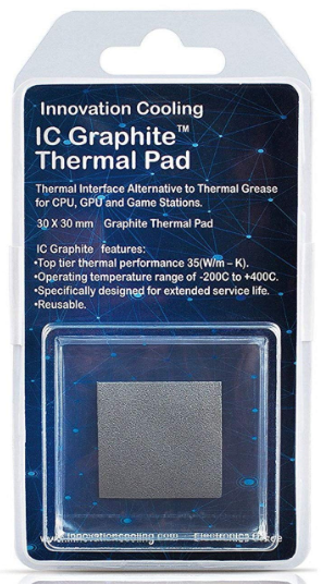

I've got the graphite thermal pads in two systems right now. They work perfectly well but run a little hotter than traditional TIMs. Not a big deal for me, since I'm not OC'ing at the moment but if you are planning on OC your rig, keep this in mind, it will take away some thermal headroom you might otherwise have with a good thermal paste.
I've got the graphite thermal pads in two systems right now. They work perfectly well but run a little hotter than traditional TIMs. Not a big deal for me, since I'm not OC'ing at the moment but if you are planning on OC your rig, keep in mind, it will take away some thermal headroom you might otherwise have with a good thermal paste.
that makes perfect sense to me....but in my case its impossible to apply paste correctly. I guess im kind of hoping the pad squeezes in the center and allows the entire hole heat spreader to make at least better contact. Lesson learned i should have stayed with thermalright brand of coolers:(

i just used the thermal pad and got 10-15 degrees better results :) I will never use paste again! This is to easy considering how easy it is to screw up a paste install. I was hitting mid to high 80s with crap paste install. And NEVER have to worry about my dang cpu pulling out of the socket....like to gave myself a heart attack :(
10-15 degrees? That is nuts. Something was really wrong with your previous paste application in that case.
There shouldn't be more than 1-2C difference from mount to mount, all else being equal.
