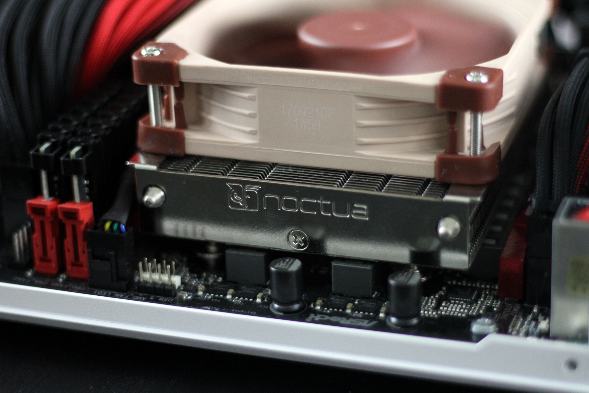

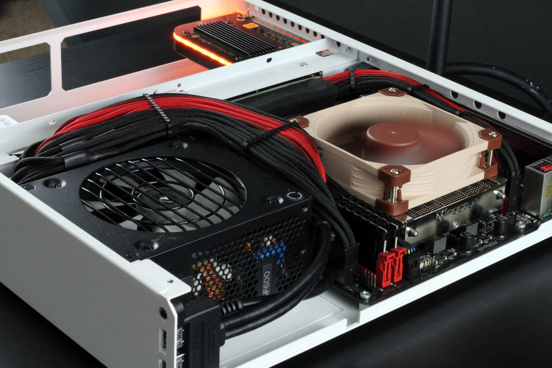

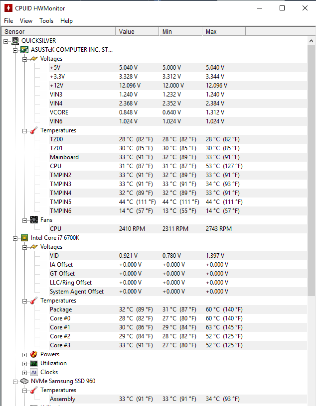

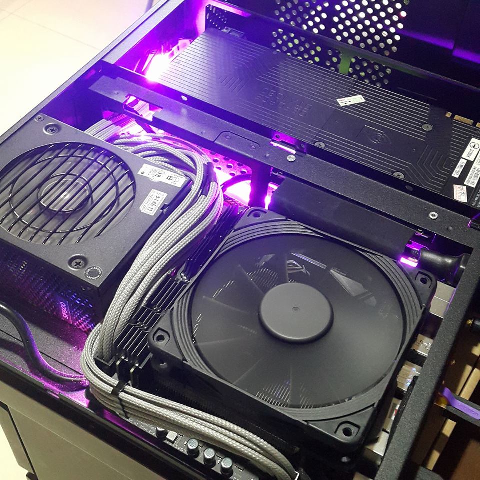

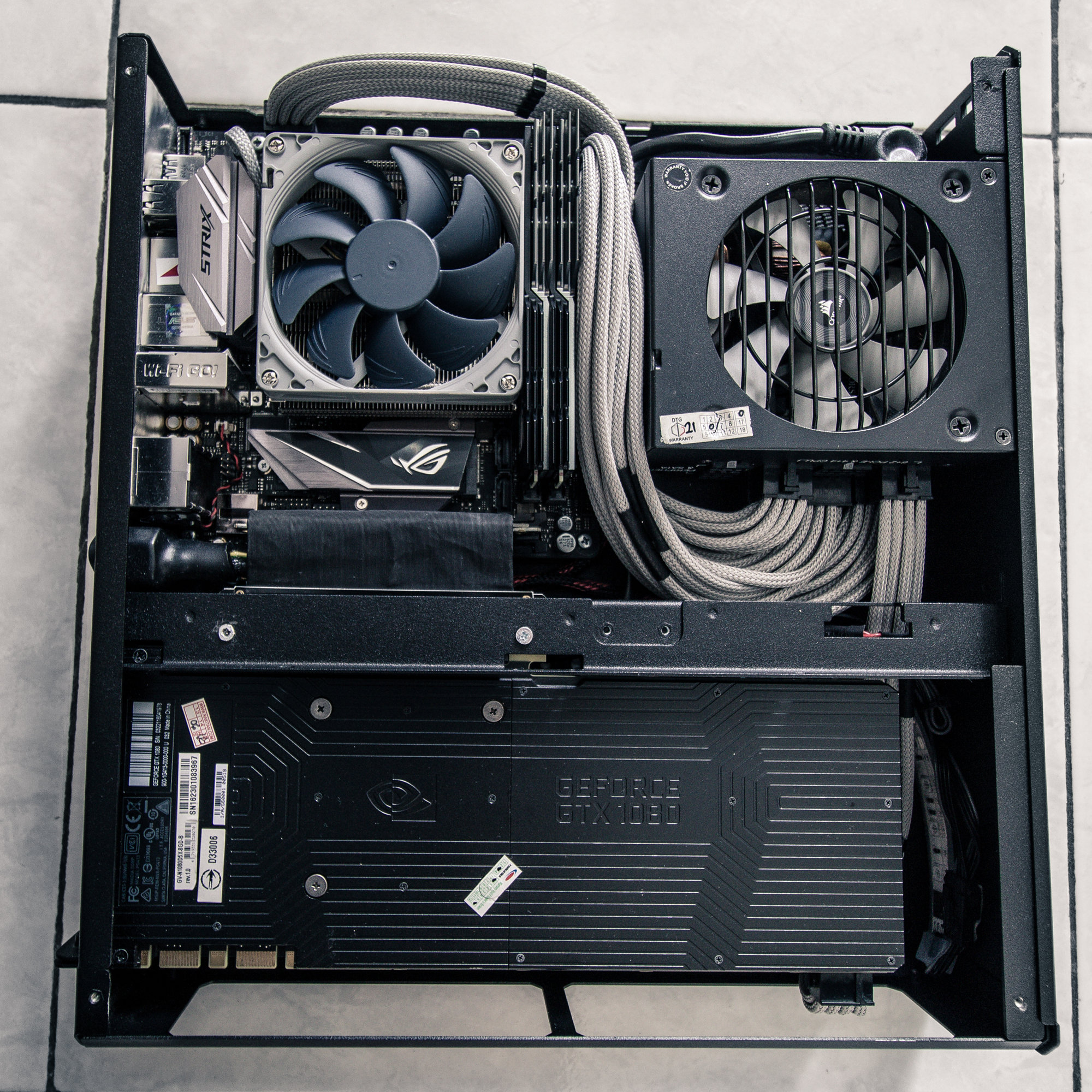

just testing L9i with NF-F12 IPPC 3000-PWM.. i want to mod the fan to fit in.. temps is good but the noise too damn high :depressed:
View attachment 64208 View attachment 64210
Is the fan too close to the case? That is usually the cause of excessive noise. Noctua has the 15mm thick 120mm fan now. But it is worth taking into consideration that most of the air a fan moves comes from the tips of the blades. So using a 120mm fan moves more air but the bulk of that air is being pushed around the perimeter of the heatsink, not through the fins like an appropriate sized fan.

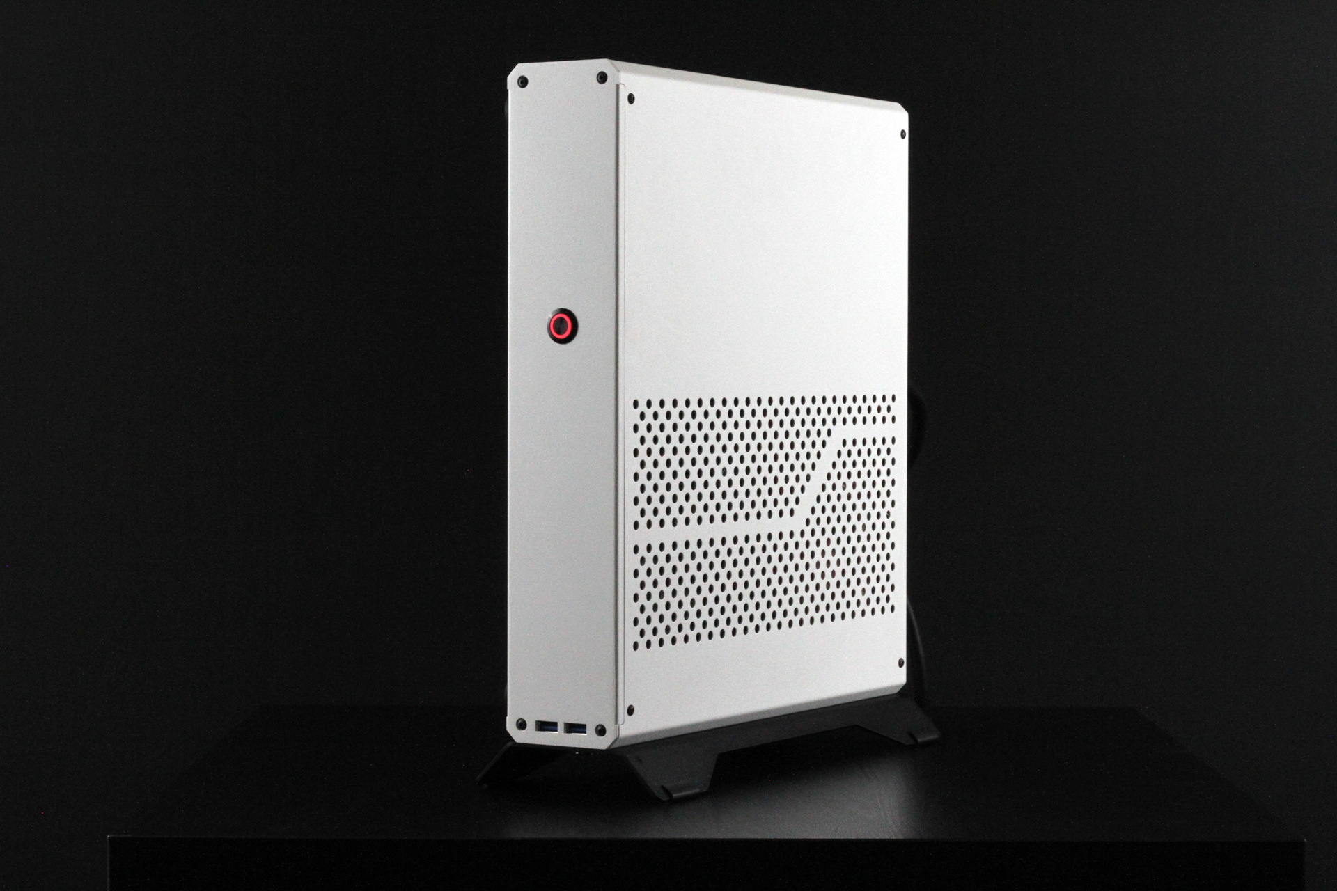

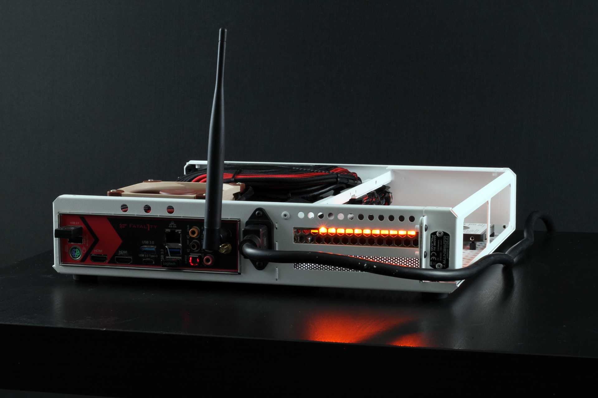

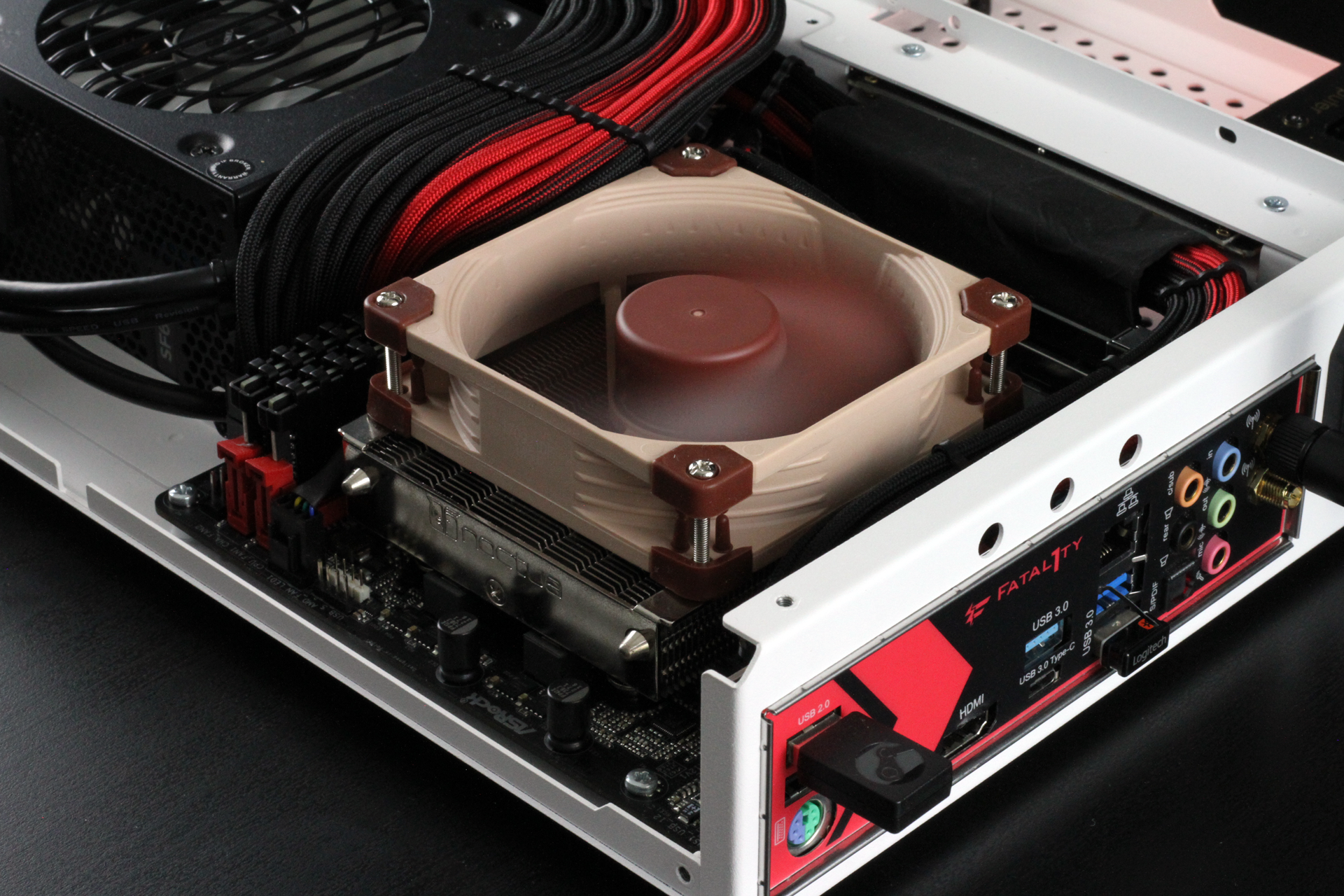

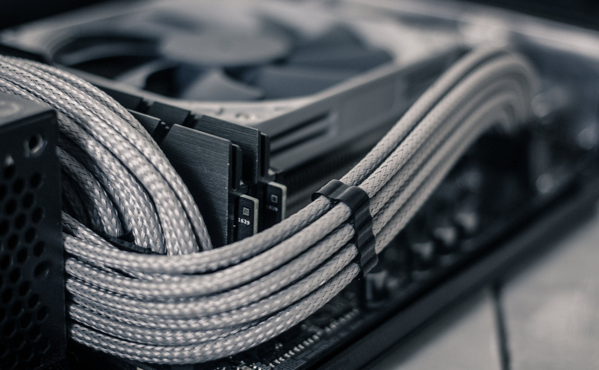

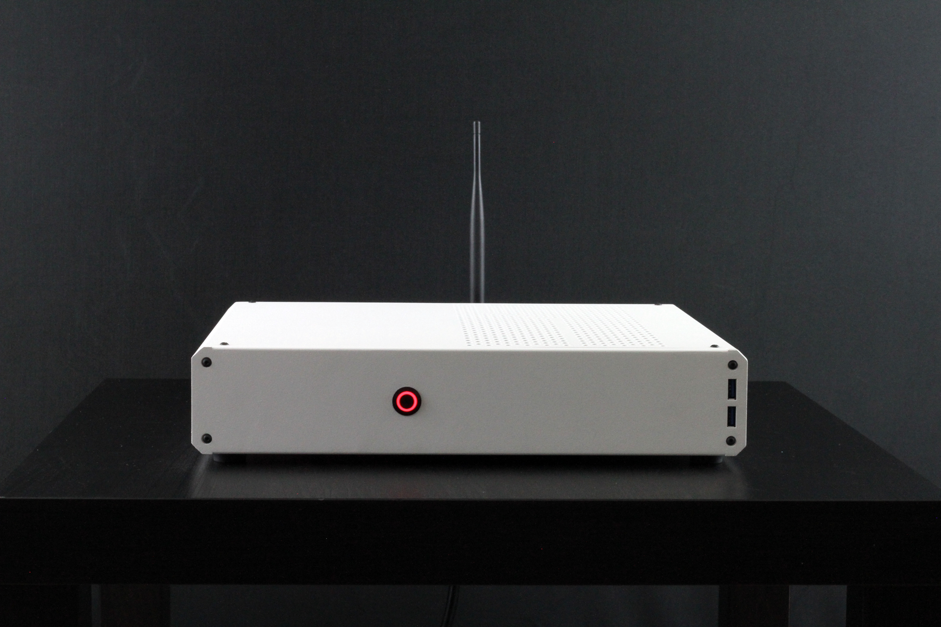

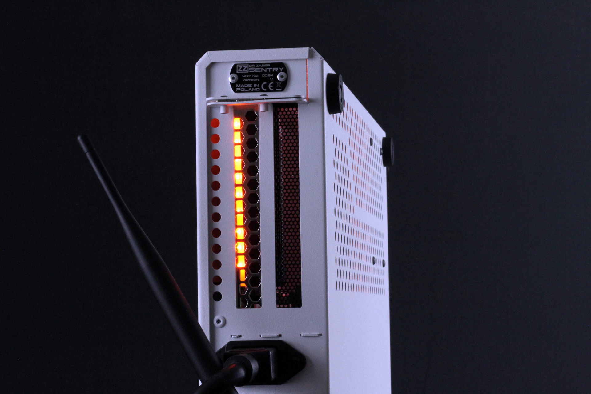

Really nice photos :)

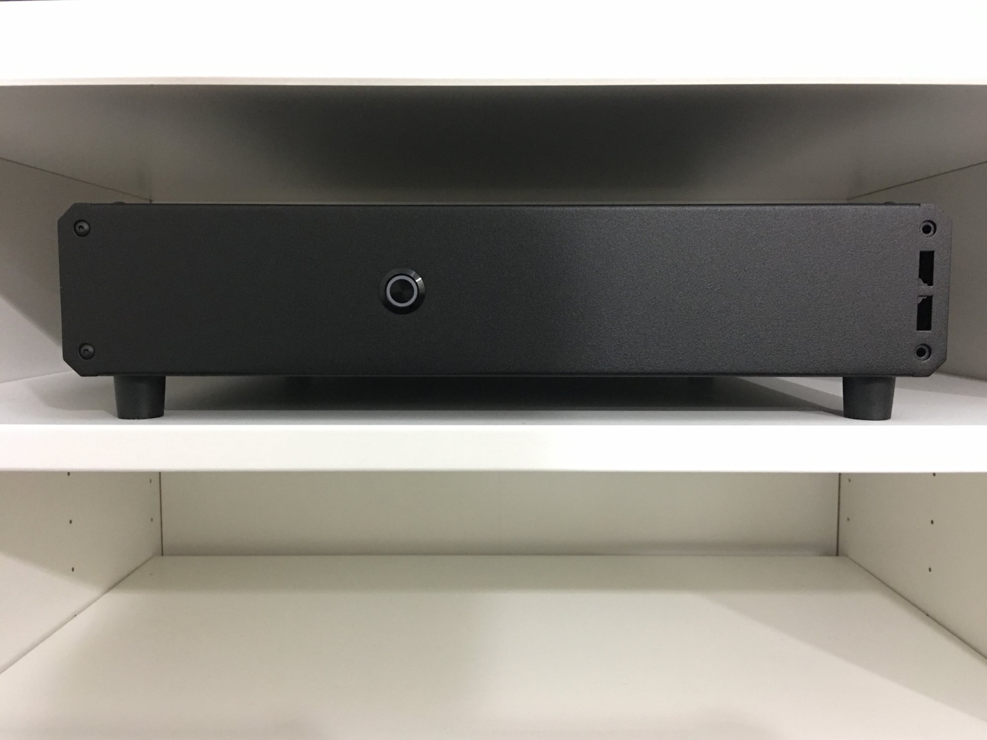

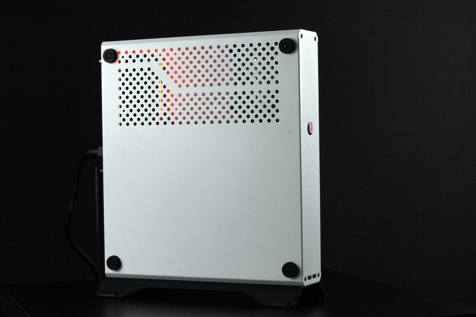

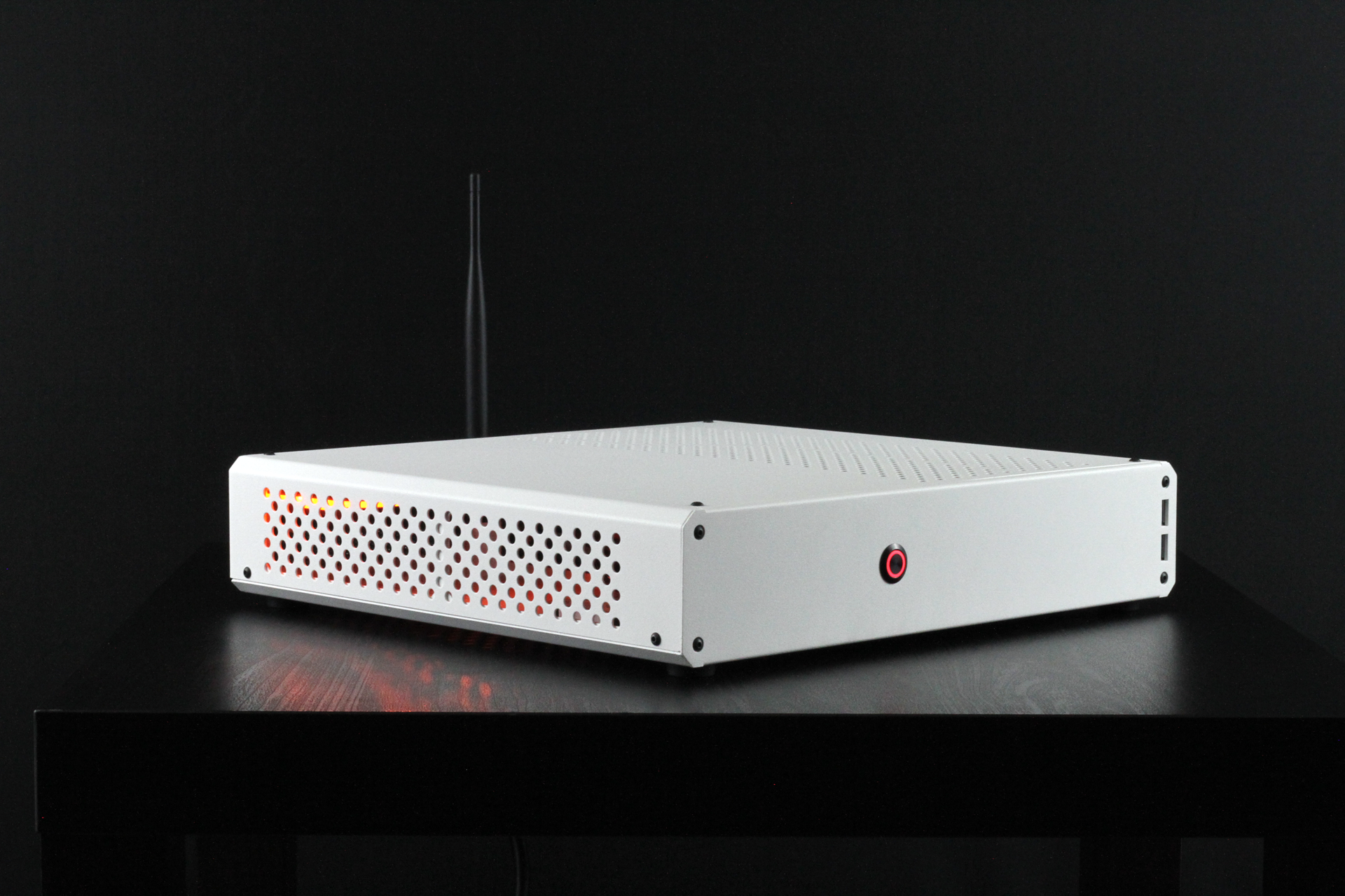

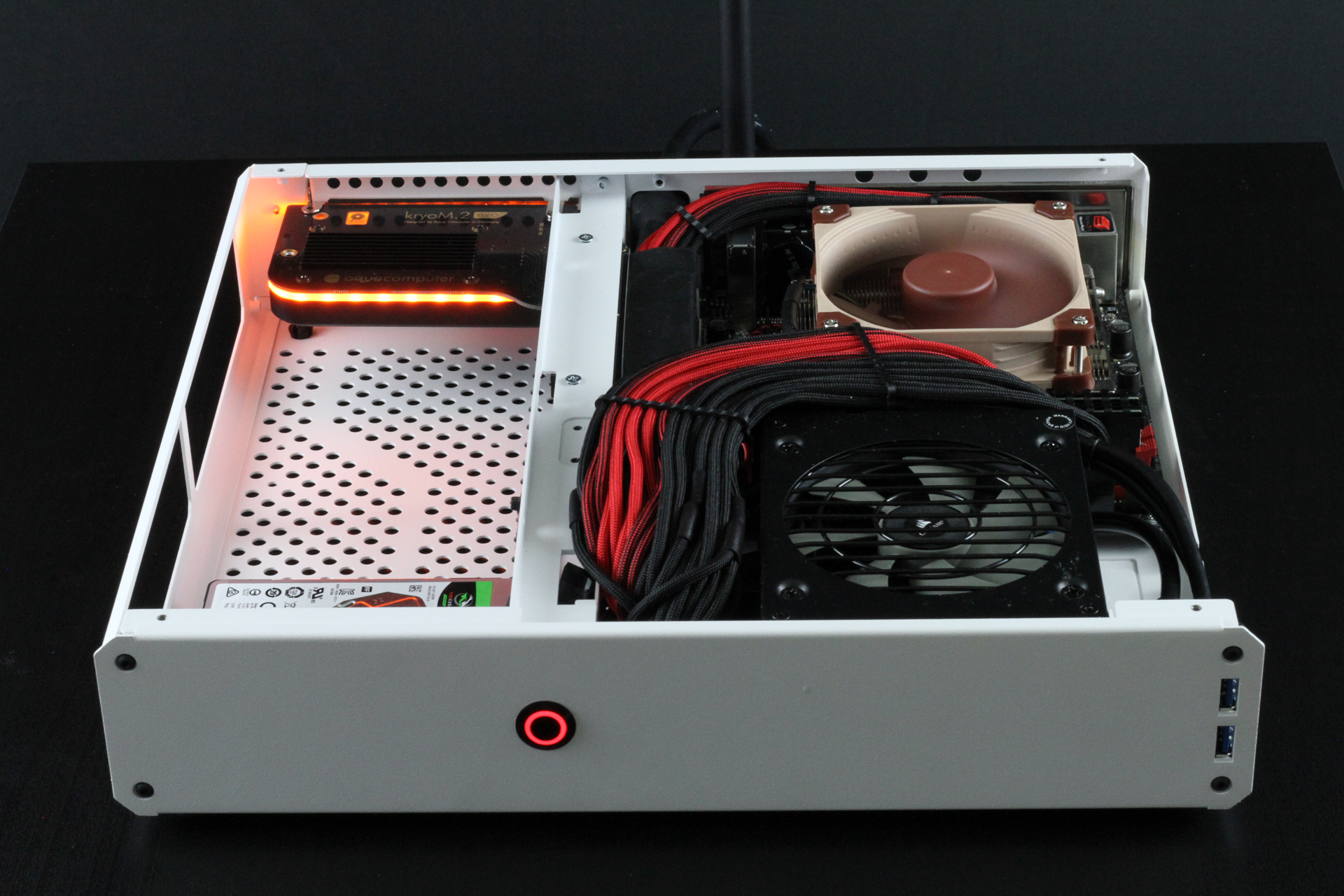

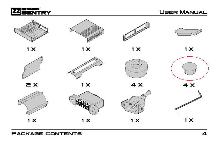

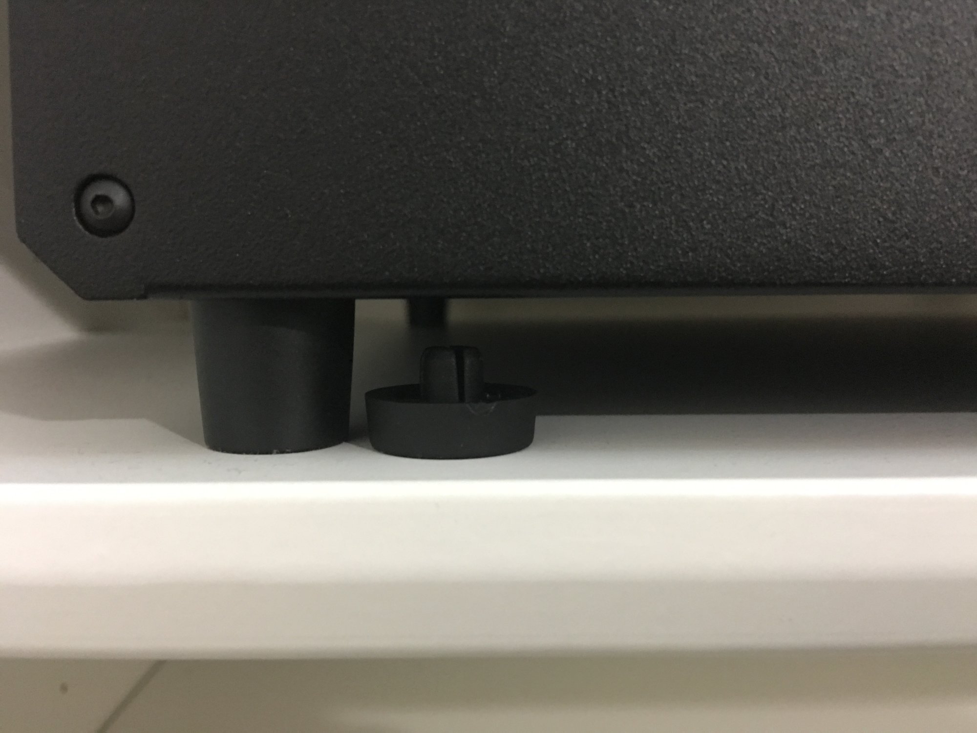

I have one question: If you will be using your case in a vertical position (on a stand), are you going to use the plugs we were sending with Sentry?
I'm asking, because we saw many people who did not use them at all or were using feet instead (the same way you did in first 5 photos), and we were wondering 'why'?
Thanks! I actually use my sentry in a horizontal position. Vertical was only for photos, otherwise i would have used the covers.

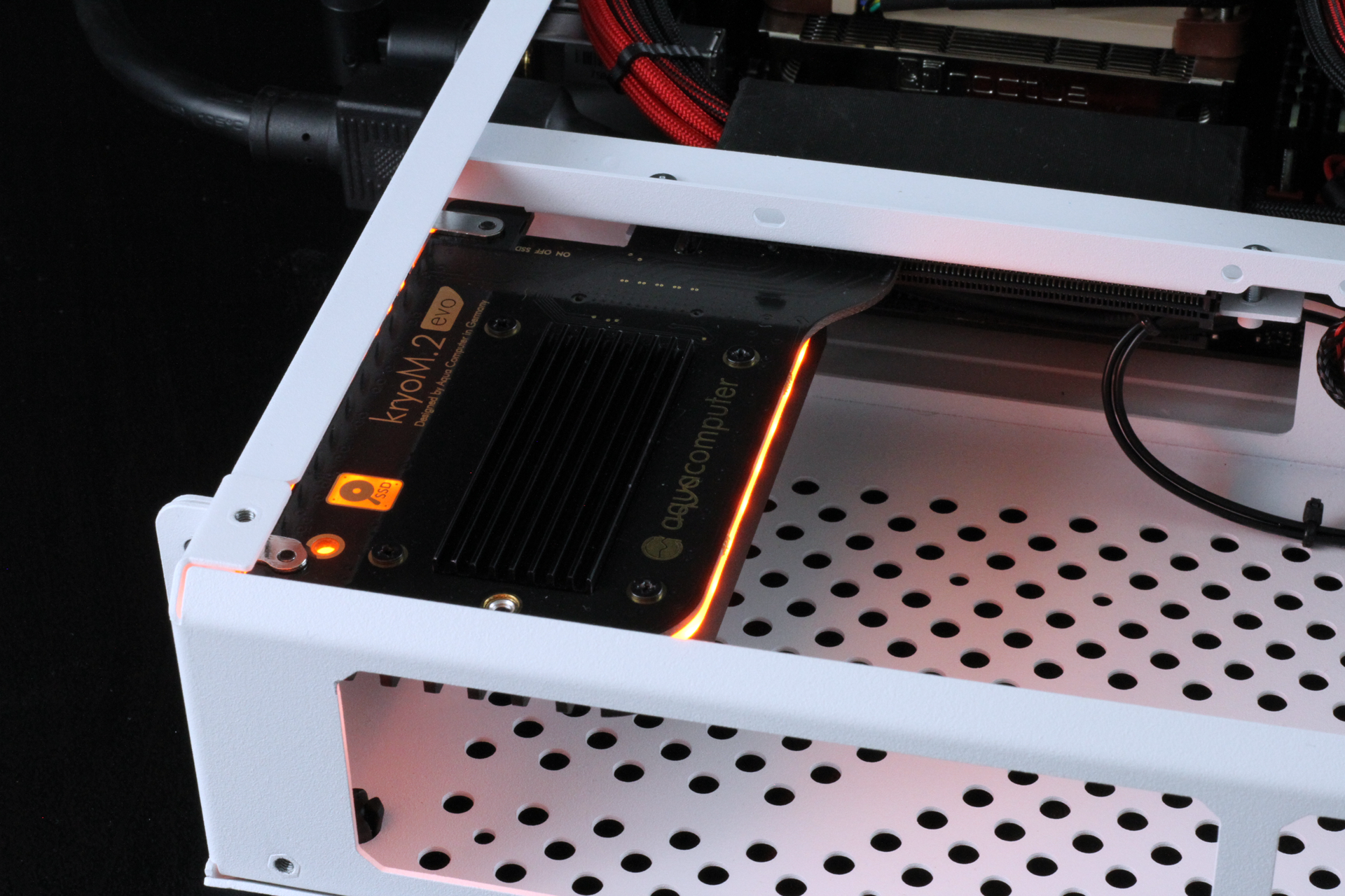

I used a thermal pad to connect it to the chassis, which helped a bit. If you are using one of the newer drives (Intel 760p, Samsung 970 and so on), it shouldn't be that big of a problem for normal usage anyway.
I you do stress the SSD a lot, the thermalpad might be a good idea.
Even then you only need a thermal pad on the drive controller, not the NAND chips. NAND actually has better longevity when it's warm (basically less than 60C). The controller is a tiny arm soc so it does prefer being cool, that's where you lose performance if it gets hot.
Hmm, I purchased some M.2 thermal pads from SilverStone and the instructions suggest the pad be placed between the motherboard and the SSD. Because of that it will probably not be thick enough to connect to the chassis. Does anyone think they will still help or will they be uselems?
As Ej24 said you want it on the controller. I added one and temps dropped from 75°C to 31°C. It was a 5mm pad.
Between the ssd and the motherboard? Strange. Fiberglass isn't known for its thermal conductivity haha, probably best to apply thermal pads between the ssd and the steel of the case if possible with your system.

My Samsung 960 M.2 is sitting on the back of the mobo and it's been fine, no thermal pads or any of that nonsense.

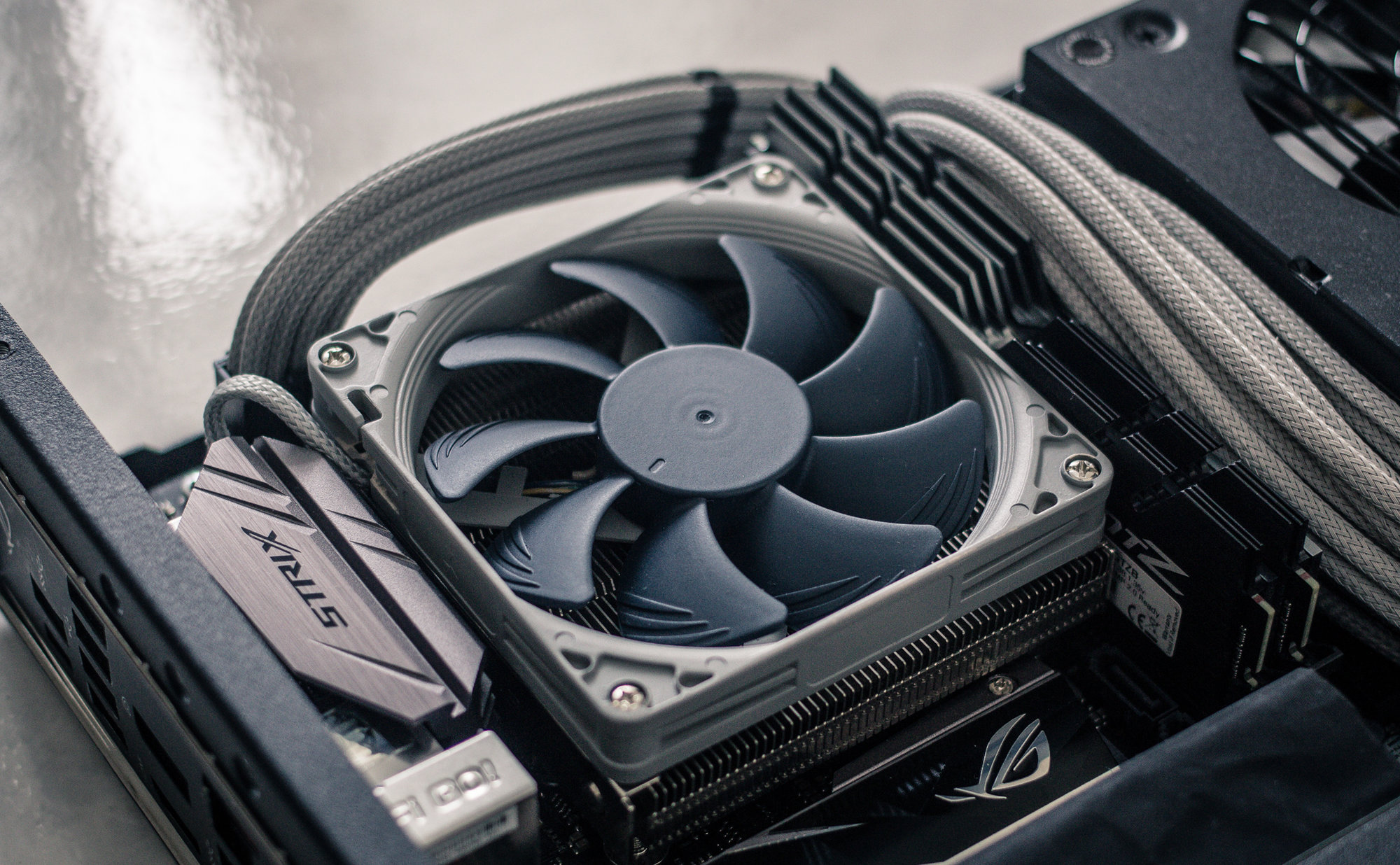

anyone have try cryorig C7 Cu on sentry? somesay its better than LP53..
I did not have a C7 on the Sentry yet, but If you mind noise, I would stay away from it, as it's to close to the sidepanel and will cause a lot of noise.
I tried a titan cooler, which even is a bit smaller than the C7 and it was a lot more more annoying than the LP53 with the same noctua fan at the same RPM settings.

Yeah my friend offer a group buy for C7 Cu.. The price is quite high.. I'm just thinking is it worth the price? I'm using L9i at the moment ..
Btw you have tried using LP53? The Temps is good?
I've been using the LP53 in my Sentry for over a year now. It's roughly 10C better than the NH-l9i, in my experience, using a delidded, undervolted i7-4790K (88w tdp). I made a small review, here.
I'm currently using one with the normal noctua fan 15mm fan (not the fast one that comes with the l9i) on a delided and lapped i7 6700k @4Ghz with 1.185V. I like to have silent system so I've set the fan to spin at a maximum of 1600RPM under heavier load. In almost all games it hovers around 1300-1400 RPM at 70-80°C (with an ambient of around 22° I would guess. Since it's getting warmer and warmer now the temps are more in the high 70 to low 80).
If you are not so noise sensitive like me, you can crank up the fan speed and get better results.
Just from experience, I would guess hat around 90w-120w depending on the ambient and the fan is that absolut maximum this cooler can handle with the thin noctua fans. Would be interested in what other peoples thoughts and opinions on this are, since I'm currently thinking about a 2700x or the successor to that (or maybe even the rumored 8 core I7).

I'm using L9i on i7 6700k non delided in sentry case for almost 1 years.. The heat sometimes go to 90 when I'm not using air conditioner..
So for upgrading my L9i, it's better to change it with LP53 + noctua NF-A9x14 (2500rpm) than C7 Cu?
