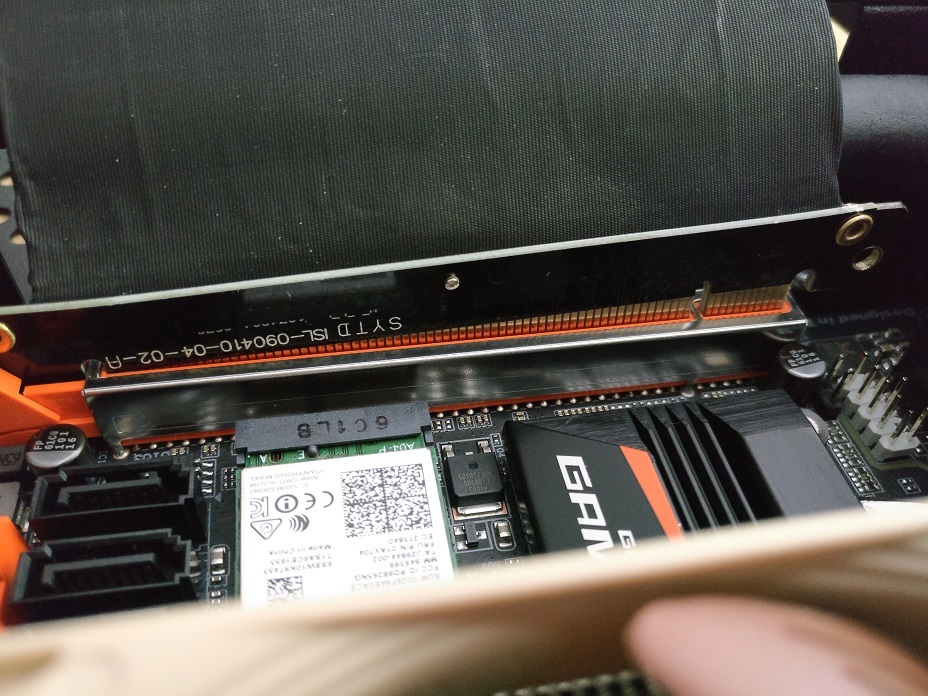

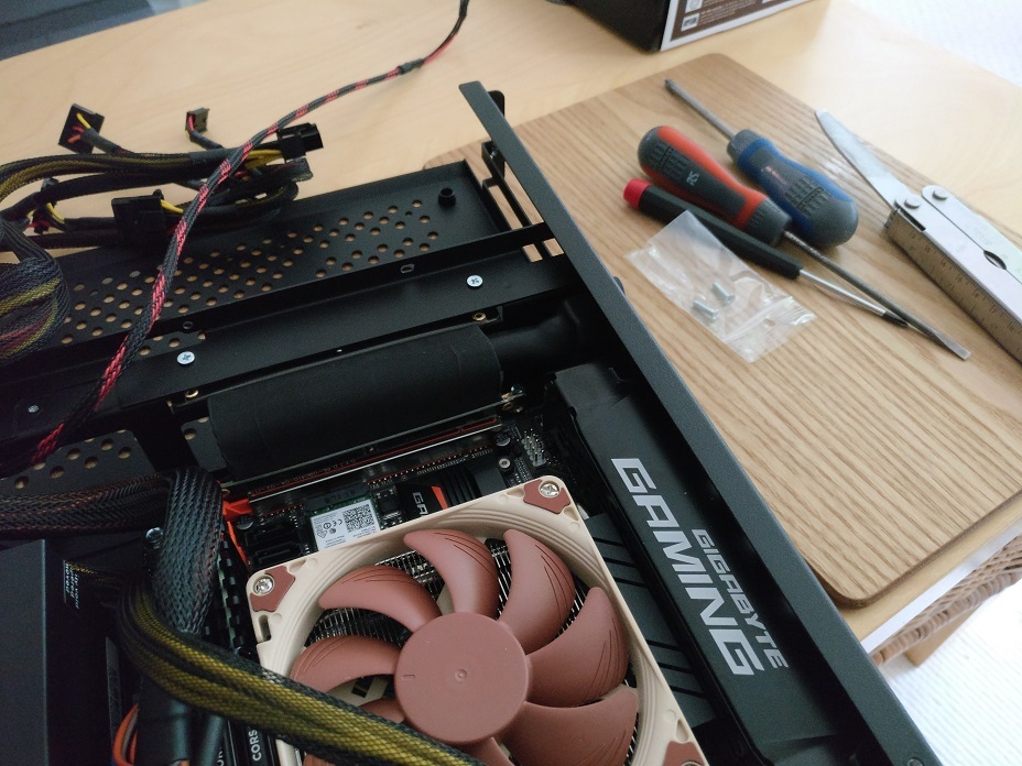

Started and hit my first issue. I wanted to make the heatsink fan cable neatly go into the notch at the edge corner of the fan. But after a number of attempts and also discovering i caused a little nick in the cable i decided to leave it. (01 FanIssue)
So easy part done - board mounted in case. I then hit my 2nd issue which i did not expect at all. The PCIe extender simply would not fit into the motherboard slot. (03 - PCIe Problem).
When looking closely I felt the extra space between the edge of the contacts and the edge was much larger than the other part of the riser card. So carefully filed and used a stanley knife to grind off a small bit at a time and tried to re-fit it. (04 - PCIe Problem)
Finally got it fitted (05 - Fixed) so completed pretty quickly after that and have finished my new build. (06 - Complete)
Thank you to the Dr Zaber team, it's a fantastic little case and loving it so far. (07 - Desktop)

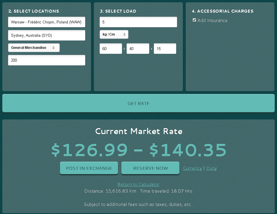

1) We were preparing campaign to be able to launch with 100 orders and thus we weren't able to get any proper pricing for courier shipments unless we were doing something like 500+ packages monthly throughout whole year and at least 100 packages going to same country with each batch. Even if we went with that we wouldn't bet on getting so much orders from Australia.
2) I don't know where did you get the $28 freight rate because of the the shipping price for the package by air is somewhere around $130 according to our courier and this freight calculator here: http://worldfreightrates.com/freight
We talked about this here when we were preparing campaign as the biggest target of the campaign is obviously US and we couldn't get anything better for US shipping. Since people here were already waiting quite a lot of time for us to launch the campaign, economic shipment to US that takes longer but doesn't cost $100+ was better option.
3) Indiegogo is not perfect - there isn't an option to give you two shipping types to choose unless you split a perk but at the same time you can't make multiple perks share item limit which was our core problem with white cases in the campaign.

I will add 2 cents to what Saper said about costs of shipping.
First of all please remember you are receiving a really big package. Really. 60x40x15cm isn't small. At start we just wanted to send you every package in small transport box, but when we were talking about this with you in forums and via emails, most of you were complaining about how transport companies treat packages in different countries. Some of our backers even sent us youtube videos like this one (link) showing how transport looks like in small cities in their country. This is why we decided we need to go big with the package (bigger transport foam, thicker external box, etc.) to avoid future problems.
Secondly, before the campaign when you do not know how many packages will you be sending, then noone from courier companies will give you better price. You have to tell how many packages you will be sending, and if you don't know that, then you will get something nearly as "good" as standard price for 1-package customer.
Finally, i have an example of the offers we received before and after the campaign. When we were preparing the campaign, the best offer for the USA which we received was something like $85 (including insurance and handling customs paper work). Now (after the campaign) when this transport operator saw how many packages we have to send, he gave us an offer for $60 if we will send all of those packages through his company. How can we compare $27 (customs paperwork we are doing by ourselves) which we offered for transport during the campaign to $85 offer which we received before? Many people asked us about the possible options of transport and when they heard those prices most of them said they waited almost 3 years for the Sentry, so 3 or 4 weeks more doesn't change anything. This is why we decided we go with this economic package, and we were talking about this many times.
I hope that explains everything.
Oh. And the best offer for 5-14 days transport to Australia which we received before the campaing was $109, while economical transport which we offered costs something like $28 afair.

Would it be possible to fit some of the taller GPUs by using an angled PEG connector? I know it's on the list of incompatible GPUs, by wondering if there are any brave soldiers out there who attempted a Strix 1070.
The answer to the first question is YES - you can fit slightly taller GPU with angled PEG connector, that's why there are dimensions shown in the compatibility info both on our website and in the image linked on top of the spreadsheet:
The answer to the question about strix is NO - strix cards are generally too big. Strix 1070 is 134 mm tall measuring from the slot and as you can see in the image above there's 112 + 18 mm of space there, so it won't fit by ~4 mm.
If it wasn't for those 4 mm it would fit as it has properly recessed PEG connectors, but it would boil inside sentry recycling the hot air most likely because it's made to draw a lot more power than reference GTX 1070.
