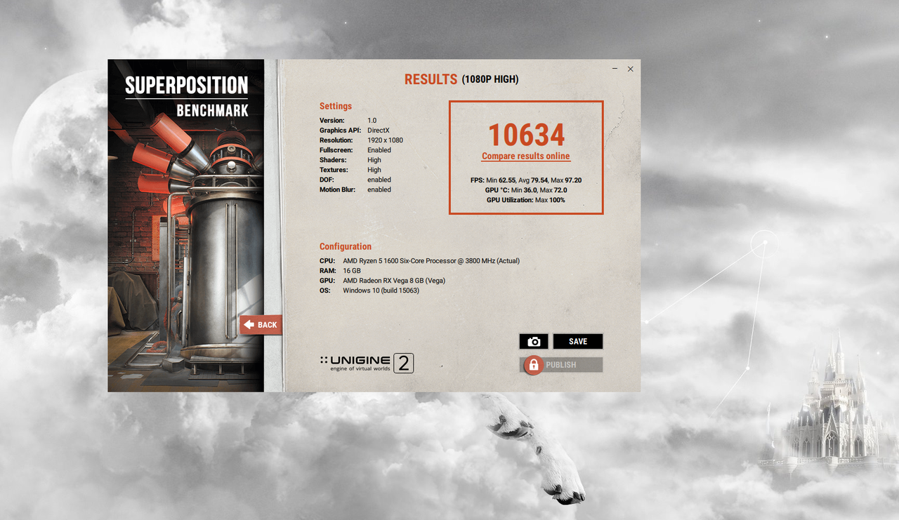

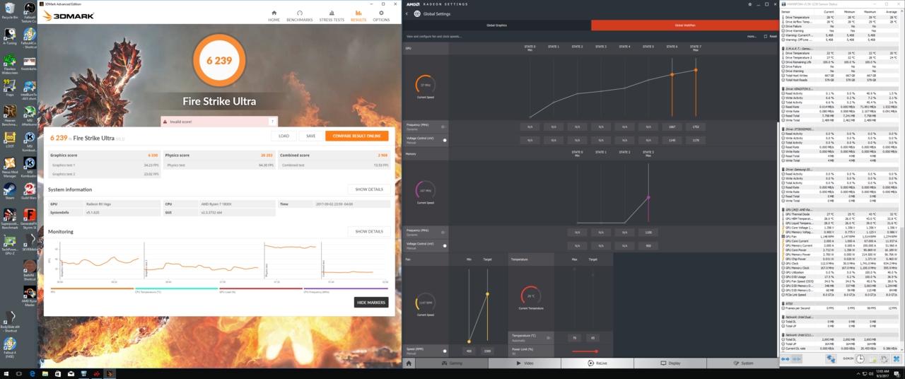

Ok so after getting up this morning decided to throw a couple more runs of Firestrike extreme at my Vega and got lower scores. First I noticed the first test would not go into state7 clocks. Finally figured out you MUST set voltage to Manual whether you change anything or not, otherwise it stays very conservative. Ok so after that I noticed the clocks never reached the same levels as last night with stock volts, regardless where you have your max clock set. LOWER VOLTAGES GETS HIGHER CLOCKS. Have mine set for 1777Mhz. At stock volts (1200mV) the max clock I would see was about 1742. @1180mV max clock was 1768. So far that works out quite well. Then I ran Kombuster KMark and reached 1804, max still set at 1777. Still got a lot of learnin to go apparently.

so this is my first try tonight and I decided to leave the core clock stock and ONLY change the voltage (all this after seeing some reviews of flashing the air cards with LC/WC bios'). Clock never was as high during the tests as previously yet managed a better benchmark run... go figure. Gonna try and see how low but black screening sucks with my PC being in my air-conditioned cabinet ( too muchwork getting to the reset button, lol).
EDIT: Wait I see what happened, maybe. I accidently set the memory to 1100 not 1000 like I had before.

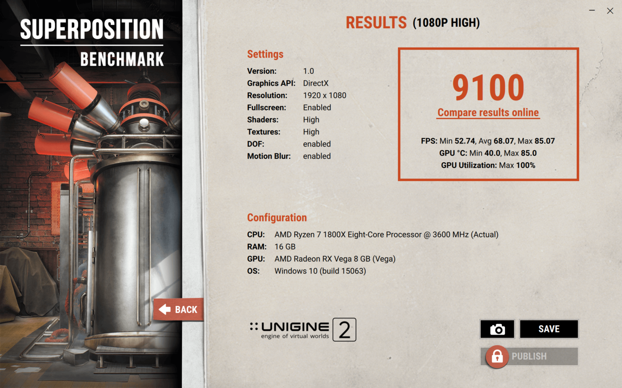

So I've been messing around with undervolting a little bit to see what is going on
Here is default turbo:
And then we have custom with 1050Mhz memory, increased fan speed (3400rpm) lower temp max and target (80 and 72) and plus 15%
Lastly I decided to keep the above settings, but I bumped the voltage to 1050 for state 6 and state 7 from 1020
Quite the drastic improvement from bumping down voltage. A 9% improvement in performance vs turbo just from lowering voltage.I don't have a kill-a-watt to measure power differences, but ill consider ordering one if you guys are interested.

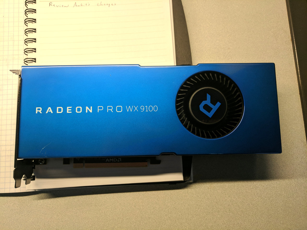

Not gaming, and it's not even going in a very powerful box. Intel i7-x990 with 24GB of RAM. Used for professional CAE software development and validation, running Linux.
But hey, it's fun having the top of the line Vega card to play around with. Here's hoping the Corsair 850W PSU can handle it.

I'm trying to get one, because compiling on that i7-x990 is takes WAY too long.
I have access to a Lenovo Thinkstation P900 with dual Xeon E5-2695v3's(28 cores, 56 threads), but it's only certified with NVidia cards, so the wx9100 can't go in it, so where's the fun in that? :)

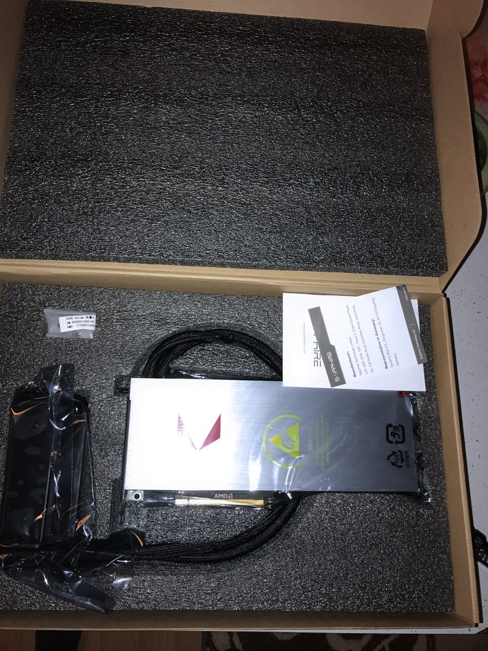

Got mine up and running, had to tear apart the Nano rig, set it on top of the workstation vice integrated into it. This is with a 600w Corsair Power Supply which so far is doing great:
The highest wattage from the wall as read on a Kilowatt meter was 457w when doing the benchmark in Dirt Rally at 4K Ultra preset and it average was in the high 70's. Other benchmarks it was less than that.
It has to be the most beautiful looking GPU I've ever own or seen, the packaging was huge, a lot of foam rubber - this thing could be drop out of an airplane and it would probably survive. :ROFLMAO:

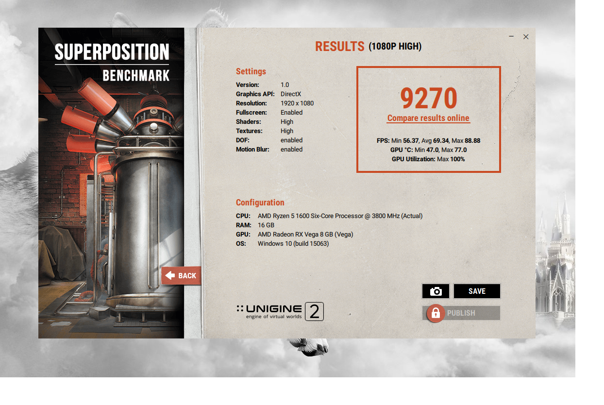

ontariotl and JustReason what clocks were you guys at to break into 11k in superposition?
In Balance power mode, I got 10670 something 447w from the wall
Power Save 99xx something 385w from the wall.
Balanced mode clock speed maintain around 1600mhz, Power Save it was around a consistent 1500mhz.

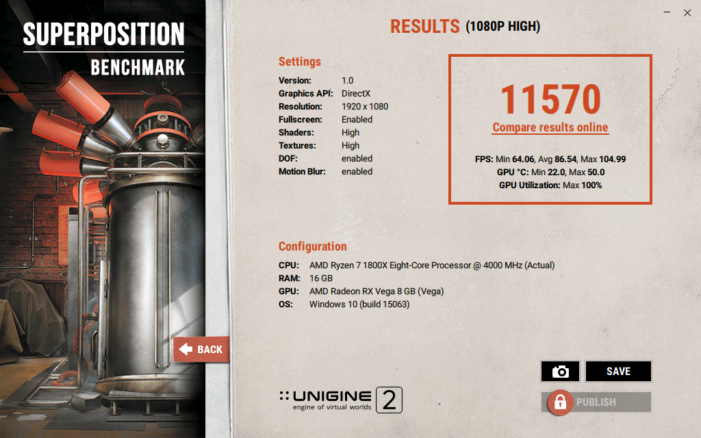

He has his blocked so his temps are incredible. But anyway my clocks for that are 1772core @ 1170mV with memory 1100@ (says 950mV but that cant be right so I haven't touched it, think it is around 1.356mV if HWiNFO64 is accurate). Another thing DO NOT LEAVE VOLTAGE SLIDERS ON AUTO!!! It will kill benchmark runs. Even if you don't touch voltage, although knocking of 10-20mV is a good idea, setting it to manual will make sure you hit STATE7, which for me wouldn't in test one of firestrike.
I'm using the high power AIO bios and I have mine set to 1732 as the highest P state. I can't go any higher. And I have the Ram set to 1105.
JustReason - Thanks for the voltage tip. I didn't think about turning off auto. I'll see if it makes any difference.
