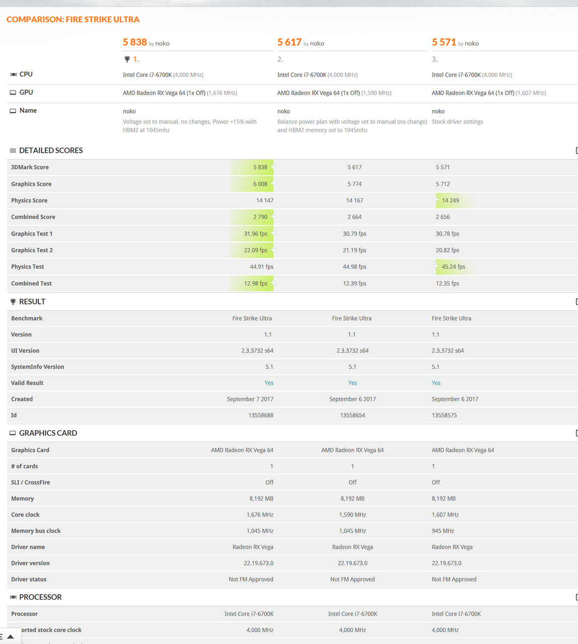

Just getting a feel for the card on settings using Firestrike Ultra (GPU limiting). Lowest score is stock settings, second is with HBM2 at 1045 and manual voltage but no changes to the voltage, highest is +15% Power, HBM2 at 1045 and manual voltage (no change in values). Power tune brought up the clock speed significantly, max power from the wall I caught was 497w but most of the time it was around 480w with the +15% power. I don't want to go above 550w from the wall even though the power supply 600w output means an input of 600w/.9 = 667w from the wall. Still it would not take much to push up the power high. Looks like the clock speeds was limited by the power settings.
FireStrikeUltra.png​
Just getting for a feel for the card on settings using Firestrike Ultra (GPU limiting). Lowest score is stock settings, second is with HBM2 at 1045 and manual voltage but no changes to the voltage, highest is +15% Power, HBM2 at 1045 and manual voltage (no change in values). Power tune brought up the clock speed significantly, max power from the wall I caught was 497w but most of the time it was around 480w with the +15% power. I don't want to go above 550w from the wall even though the power supply 600w output means an input of 600w/.9 = 667w from the wall. Still it would not take much to push up the power high. Looks like the clock speeds was limited by the power settings.
Yes. and looking at your first test frames it definitely is limiting. That is what happened when I left voltage to auto, I would only hit State6 and not go into state7, the other tests would- odd I know. Actually looking at it your first test isn't that bad actually compared to mine.

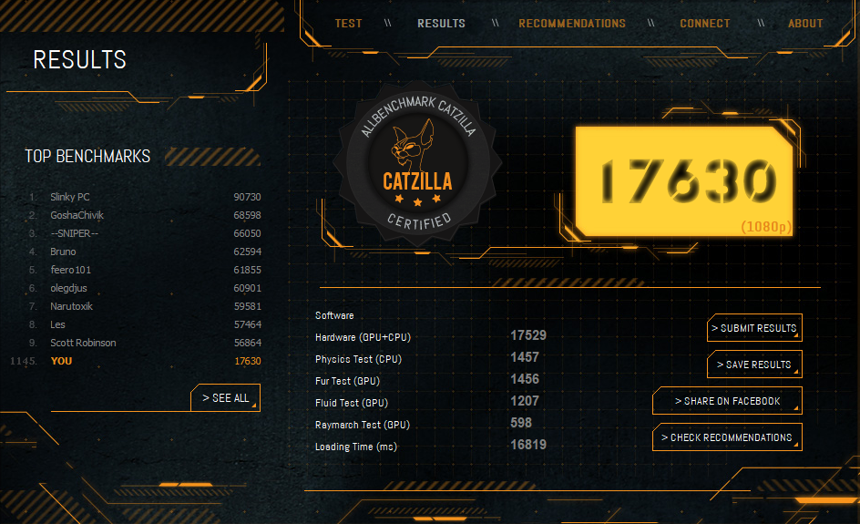

Anyone like Catzilla? Sadly only ranked 1145, there was a time when I was 13th place, that felt nice.
