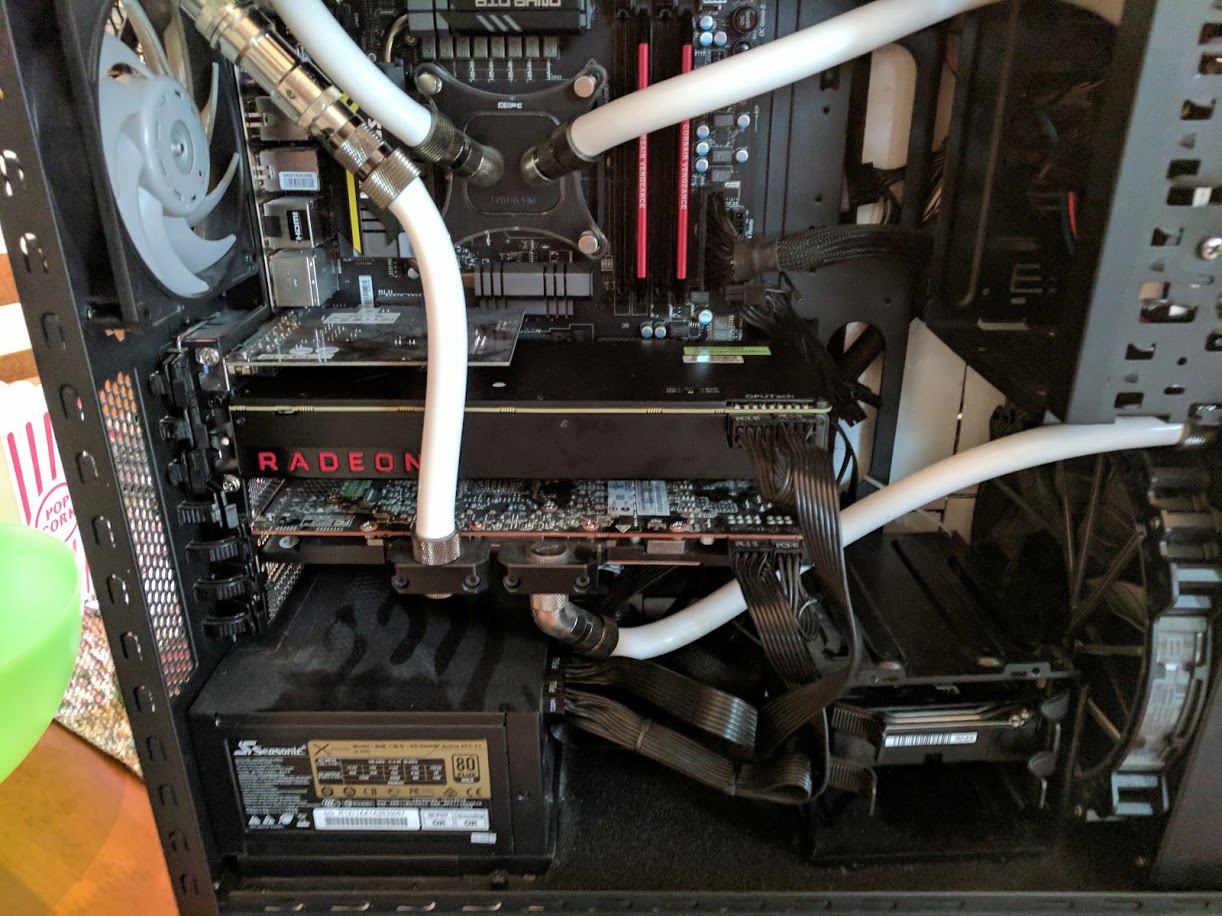

You probably should run a separate PCIE cable to your VEGA card . See FAQ https://seasonic.com/faq/I wish I could, but my stock cooler was used for all of 15 minutes to make sure my card wasn't DoA and then I ripped it apart. Here is a photo of VEGA with his little brother, my last platinum clocking 290. I am aware of how dirty my case was lol. I have a positive pressure setup, 2 x 200mm front intake and 3 x 120mm AP-15s up top with just the single AP-15 pictured as the only exhaust. I sealed the case up as much as possible, which is kinda ironic since it a heavily modified HAF 932.
