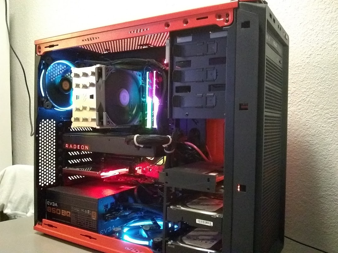

Got mine installed.....Seems to have Samsung memory so im happy with that. What i got to do to undervolt it?
This thing can really throw out some heat when running full throttle lol.....but at least it is blown outside the case![]()
