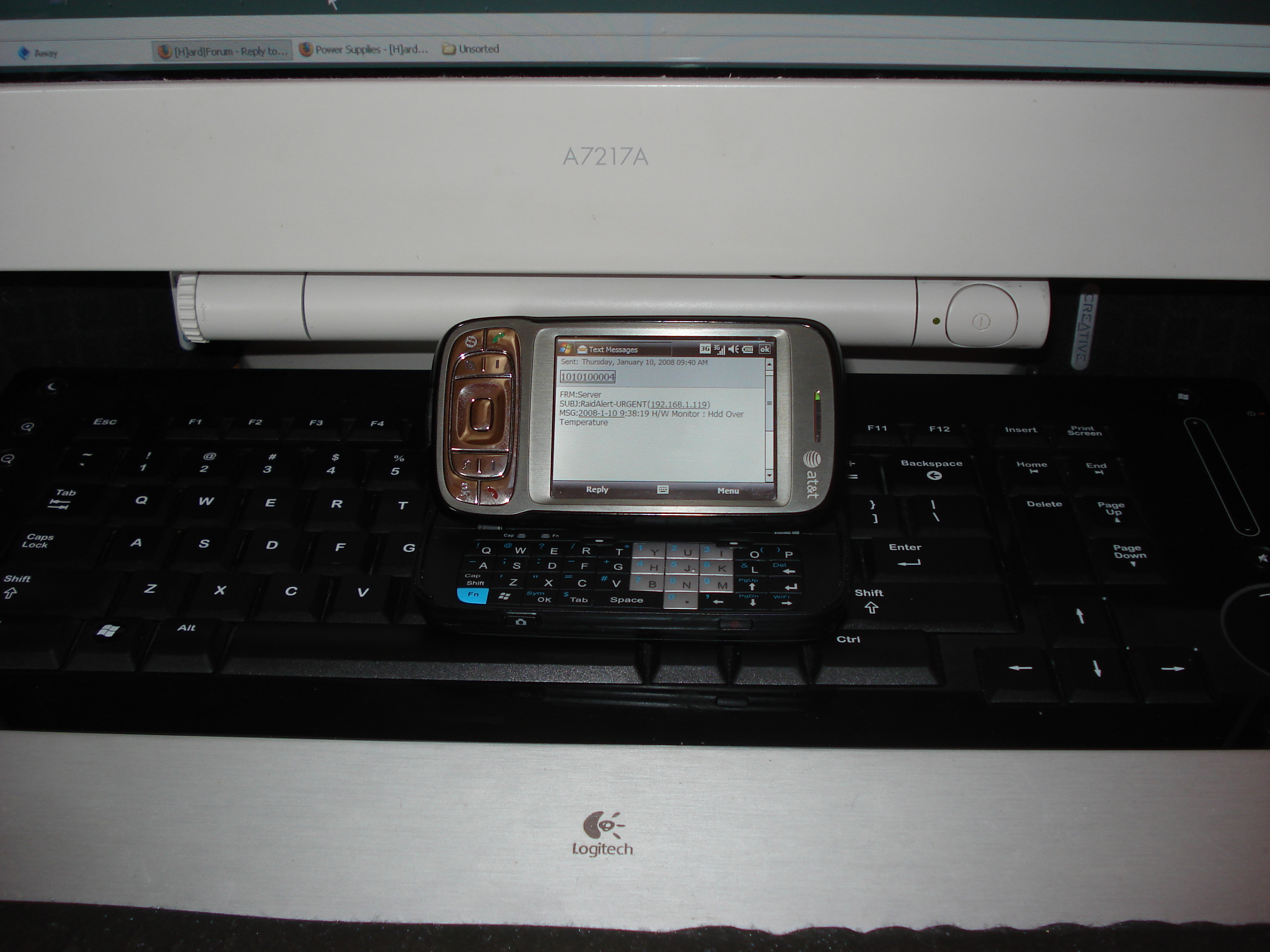

I have my card set up to send me text messages if something ever goes wrong. Was not fun being woken up early in the morning as I had left the side of the case off and the sun was temporarily shining directly onto the drives. Neat feature though. Only need to get an IPMI card for my Tyan board so that I can shut down the server from my phone if it starts overheating and I'm not home.

Areca 1130ML...half the ports of the 1280ML (and also PCI-X). All the cards that have 12 ports or more support out-of-band management, so once you find out your phone's email to SMS gateway, it's pretty simple to get the card to send you text messages.
Yep, thats what I want to do with the 1280 :)

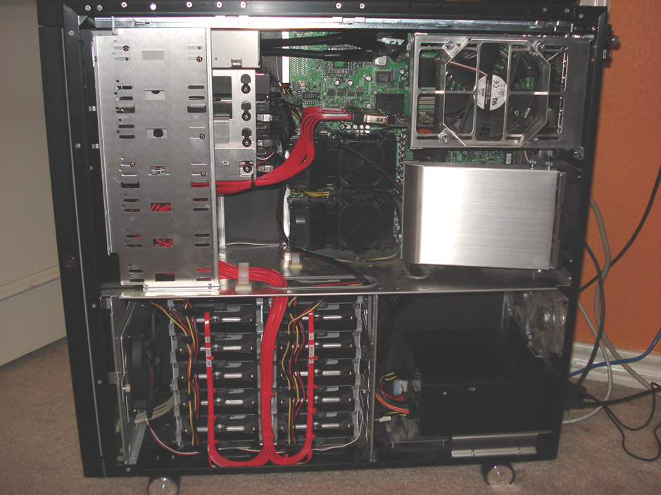

Update: So I started the build lastnight, took tons of pictures of the entire process and everything... then as I was completing the build so far, I dropped the camera on the floor (bumped off the table)... to say the least, the POS CD camera corrupted the disk, so now I am unable to recover the pics. :mad::mad: So to say the least, no log pictures, I will just have to show you guys the end result pictures which I will take later tonight. I am done with this POS camera, never in my life will I buy a CD/DVD/optical disk based camera system again, this isn't the first time... some bumps can corrupt the disk too, especially while it's writing.
Anyways, now for the positive side. The case and motherboard was made for eachother, never had I ever had such a pleassure building a machine before, everything fits like a glove. The PSU signaling cables fit the motherboard perfectly (motherboard had built in headers), the case LED's and front panel buttons fits the board without the use of pin cables... meaning just one nice ribbon connection. Everything fits the way it's supposed to. I keep amazing myself with supermicro products, but this one put the cherry on top. Incredible buy for the features and price... hell, the thing even includes a full rail kit AND they protect wrap the metal parts of the case for added protection (not to mention double boxing the case).
This is one amazing setup and I think it's going to blow all prior galaxies way out of the water, no doubt about it. Solid, clean, organized, and professional.
