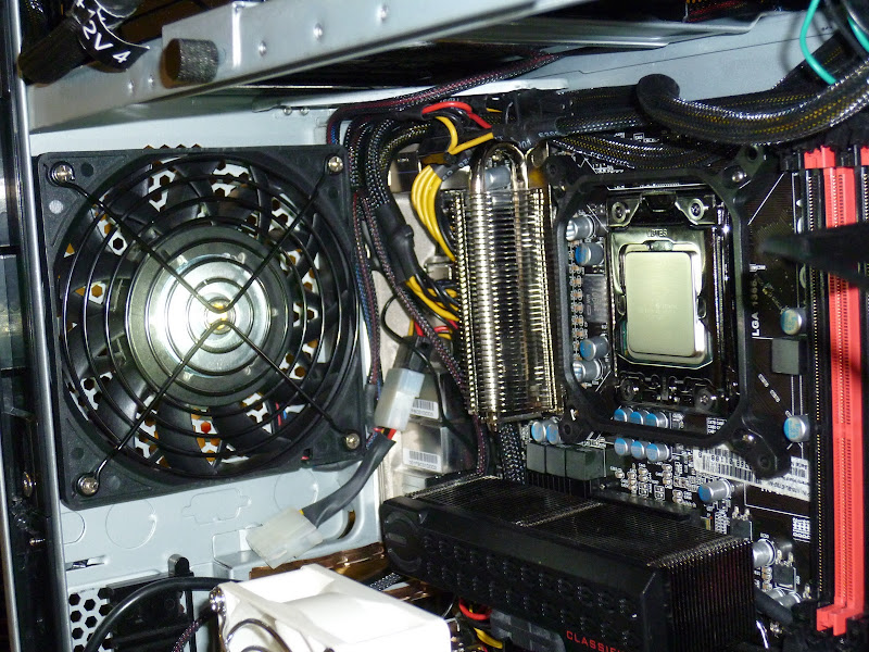

Thanks to all for the team welcomes and system compliments.

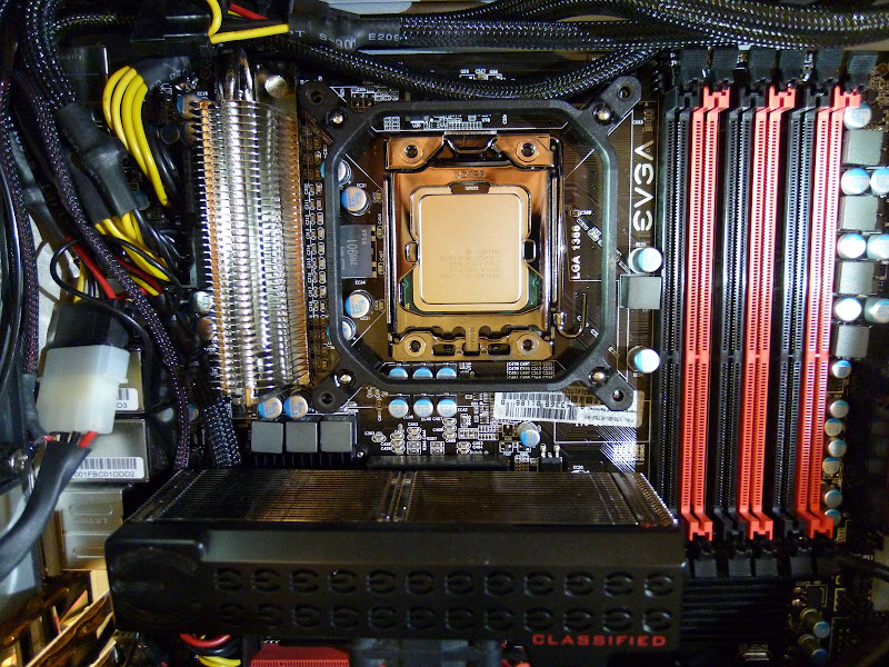

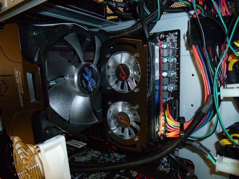

The top fans are more for extra cooling for system longevity than an absolute requirement. The only fans required are the CPU cooler (obviously) and the northbridge . Anyone who has dealt with the Asus Rampage II GENE already know why if you overclock this motherboard. Even a northbridge TIM rework does not get you out of the O/C desert where rattlesnakes combust as you eat your sandwich. :).
Plus one other fan up top push a little extra air down into the pocket made up from the power supply - video card - rear case - RAM. No fan on the rear like you might see on a traditional design. Any movement helps keep the northbridge and voltage regulators cool.
Even without a cooler I think the RAM might be just fine. The G.Skill doesn't seem to get nearly as warm as some other brands in about the same configuration doing the same work. I chalk it up to the heat spreader design G.Skill uses.

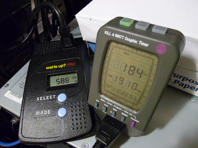

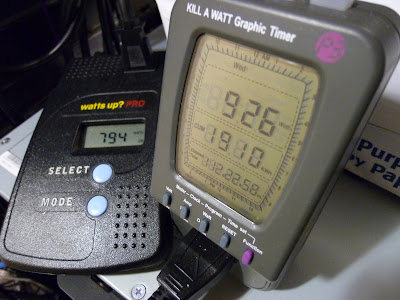

Back to the 4-Way GPU system for a bit. Below are the idle and running wattage values for the system.
Watts Up Pro = BFG EX-1200 power supply.
Kill A Watt = Both Thermaltake Toughpower 650W bay supplies.
Each Thermaltake power supply feeds two EVGA GTX 295 FTW cards. The BFG EX-1200 power supply feeds the motherboard and the rest of the system components
Idle wattage. Windows booted but doing nothing.
Load wattage. All GPU and CPU SMP -10 Folding@home clients running.
To quote Frank Barone, "Holy crap!".

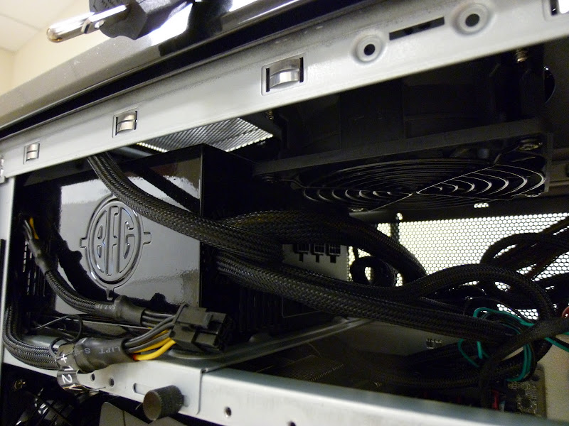

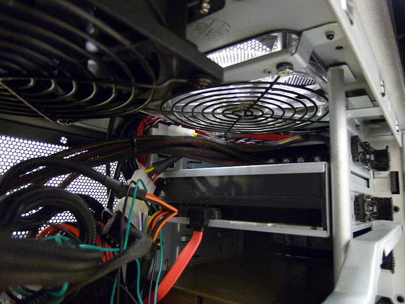

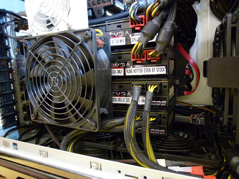

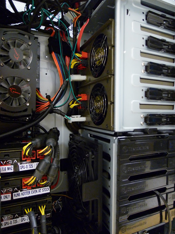

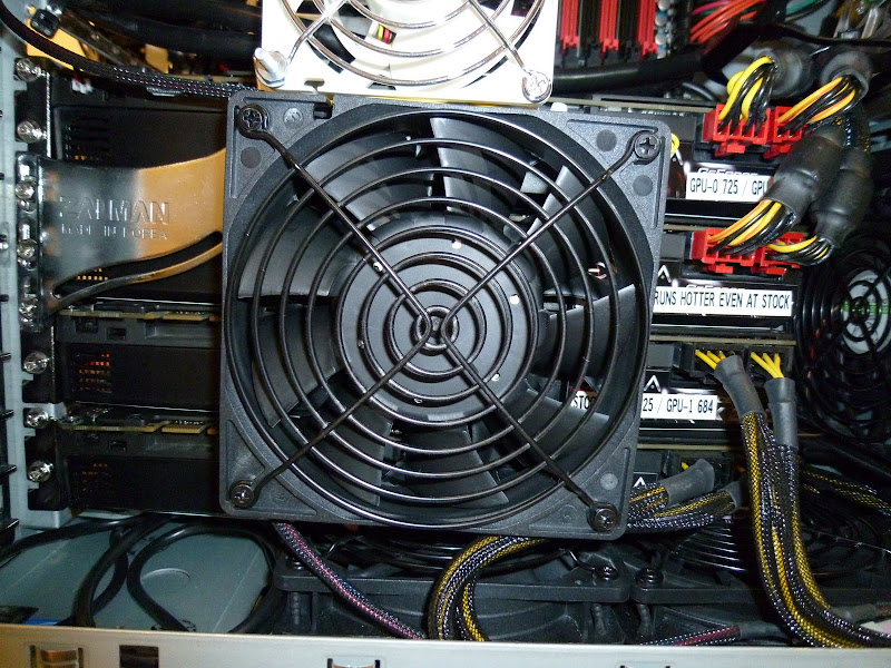

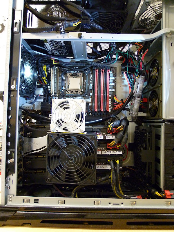

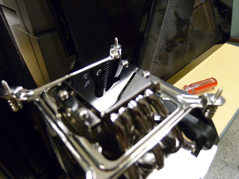

A few more pics from the [H]ecklerKoc[H]'s #1 PPD system..
Fans speak to you in the voice of Sinistar " Beware! I'm near!". My fingers listened well when he said "Run! Run!" and then installed fan grills everywhere.
This is a bbaaaadddddd fan!
This is what the bbaaaadddddd fan sucks through!

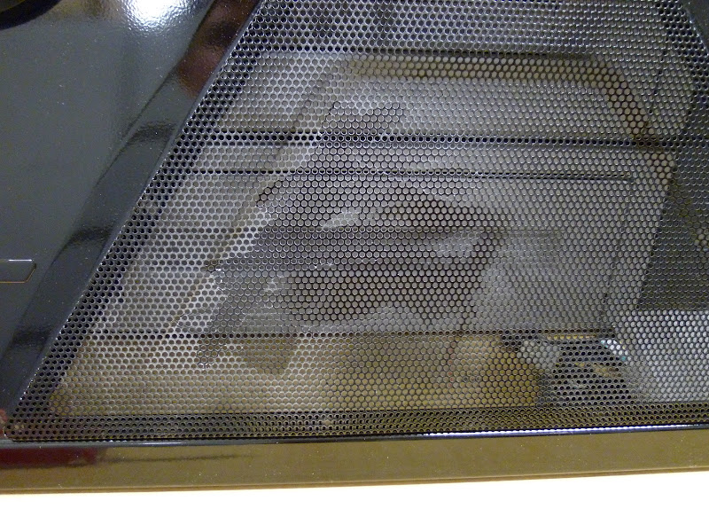

The Zalamn's surface prep mentioned previously. Right after cleaning for reapplication of the new TIM. Your camera cannot actually photograph the surface all that well, so a reflection is needed.
The Well.
Trivia Question: Can anyone name the most correct reason to place the ultra skinny fan shown in the pics?
You mean the one at the back of the case? Whenever I use very low-profile fans it's because clearance is highly limited for some reason. I see in this situation that doesn't appear to be the case. I guess I'm stumped unless this is a particularly powerful model. :confused:
im guessing your talking about the little white fan and if thats the case its to move air behind the card so the top card doesnt pull in the hot air from the chipset heatsink through the open vent at the top/back of the top GTX 295? if its the black fan sitting up against the cards then its to force cool air between the cards..
Try the one that is behind the cards mounted on the HD cage area. It's THIN hard to see in some pictures.

For all the equipment you have in that case, your cable management is fantastic - very very impressive for the amount of wires and stuff in there.
re: the fan
I'm guessing it's to help move the air exhausting from the 2 front mounted psus so the air is blown more towards the back of the case instead of not moving much and remaining stagnant in the case and then heating up the hardware more (primarily the ram and the cpu).
GTX 295s exhaust air out of each end, so the skinny fan might be pulling hot air from the cards out the front of the case.

The fan the question was about is this fan.

The case is fairly easy to work because of the wire management.. While no one wants to expect a component replacement, the fact is something is going to happen with a Folding@home box like this. If not a component replacement, then its going to be an airflow issue. Cable management is really more of a requirement than an option. The benefits of easier and faster component swaps plus better airflow control have already been experienced in a few different ways. The work does make for a nice picture too!

The fan the question was about this fan.
Yep, that's the fan I thought you were talking about. Is it a high vlume fan for its depth? I have a fan that is ultra-thin too, but it moves a ton of air. Sometimes appearances can be deceiving when it comes to fans.
or is it to save space for longer gpus? :eek: What's bigger than gtx295?
The answer to the fan question is, to bend the air from the GTX 295's, up.
During the build a few different option were considered for cooling the drive cage. The first option choose was to install a front fan. Natural enough since there is a spot for one. However, the video cards dump hear in two directions. The heat going to the front of the case was heating up the drive cage.
The next natural solution seemed to be one of two things.
  1. Install another fan with the included bracket
  2. Install some customized flexible ducting you might use for a dryer or HVAC venting. Take it to the top of the case, and fit it to a fan for exhaust.
The second option was definitely more intriguing. Plus the appearance would have given the case an even greater techno-custom look. Not that it would matter once the side panel was in place. But I could still "see" it in my head.
But the bracket called and another 120mm fan was looking for a home anyway. Not the 120 you see, but another 120mm fan. The drive cage temp was good after the fan install. But there was another problem. The fan was strong enough to push air right back into the video cards. That defeated the goal of having an air-cooled system stay cool all around.
The 12mm Scythe Slip Stream Slim Fan was consider. The Scythe seems a joke since the airflow from the four video card is not exactly zero The fan over the top of the video cards cards also contribute to the problem The Slim Fan was worth a try anyway.
The surprise came when the Slim Fan and the fan at the bottom of the case worked together perfectly to send the hot air upwards. Without heating the drives. Without pushing hot air back down the exhaust of the video cards either.
Another completely unplanned evolution that works great! But I still think some robot-techno-duct would look good in the case! :)
