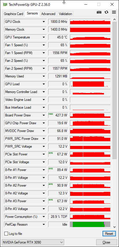

I feel the load balancing on my FTW3 is perfectly fine. When I look at GPUz while gaming or benchmarking, I'll see like ~128W or so on each 8-Pin connector evenly and 74W on the PCIe slot. What more balancing do we need? lol.
As you can see here my PCIe and #3 power have the same average draw. In reality, the PCIe often draws 5-10 more watts than the #3 power connector. This behavior is displayed on my old card and my fresh RMA. I have a 3090 FTW3 Ultra. Thus why I asked if there is a guide on how to flash the XC3 bios to the FTW3U. Once the PCIe slot hits about 79.8w the card goes into PWR perf cap mode and cuts the requested clocks. The card never gets hotter than 60c.

It's hardware. If they had a software fix we'd have it since they fixed the 3080. Here is a 130 page thread with many people finding the same thing. https://forums.evga.com/EVGA-GeForce-RTX-3090-FTW3-XOC-BIOS-BETA-m3124192-p130.aspx
