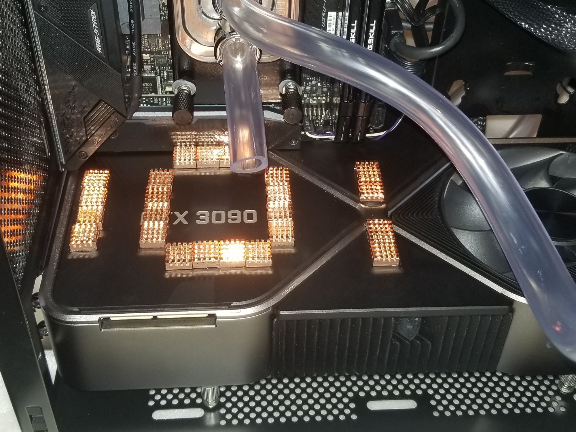

Is this considered a ghetto mod
Is that actually functional? I’d imagine you’d want to install the heatsinks on the actual memory chips and VRMs to dissipate the heat effectively. The backplate will spread the heat before it gets absorbed into the heatsinks.
The backplate gets hot as 75c. The ram sinks are over the ram chips, sense chips, and power delivery. It will add more surface area at the least, but I do think it will help. It's an itx case with a rear rad directly over the backplate and a front rad blowing hot air into the case, so Im hoping this makes it a little less worst case scenario for the card, mainly to keep it from ramping the fan like crazy due to ram Temps.
Is the backplate metal or plastic? If it’s plastic it’s probably acting more like an insulator than anything.
It's metal
Let me know how it works, I’m actually interested.
My water cooled 3090 will be mounted vertically directly over intake fans. That should hopefully alleviate any cooling concerns on the back of the card.
Personally, I think it will help minimally and not worth the effort.
One, the backplate is metal and is already distributing the heat load and pulling heat away from the chips. The extra heatsinks my add a little more surface area, but without good thermal transference from one metal that is spreading the heat out to the other along with lack of sufficient airflow to cool down the heatsinks, you will be back to square one in heat.
The idea of heatsinks is to not only increase surface area to absorb and move away the heat, but also to give a larger surface area for a cooling mechanism (be it air or water) to cool them down so that they can continue to pull heat away from the source. Otherwise, you are just delaying the inevitable that they will become the same temp as everything else.
I think you would better served, if possible, to put a fan sideways and have it blow air directly over the top of the graphics card and its fins. I think that will give you better gains in dropping the temp down than adding these small heatsinks on top of what is pretty much a heatsink.
I will report back, hopefully tonight. I don't really have room for a fan.
Time waste or not, they're staying, because I've gone too far to turn back :D
Yes that's a very ghetto mod.
If you're doing to do something like that, get this and throw a fan on it. You may have to dremel it to shape as I'm not sure if it will clear the 3090 edges.
https://www.amazon.com/gp/product/B089QJQY17/
*Edit* now that I saw your second picture...not sure it will fit anymore...
I looked at that one. I didn't have clearance for 15mm tall. The ones I have are 6mm.
I have my Zotac 3090 ghettoed with a heatsink and fan on the backplate. I bought it for gaming but am mining with it also to make up some of the money I spent.
Anyway, it reduced the backplate temp by 10 to 20C. Heatsink with no fan didn't help much. I put a 60mm Noctua on it. Even at 100% power, no thermal throttling.
Ghetto but works until I go to water at some point. Although the backplate might still be an issue depending on the design of the waterblock I suppose.
