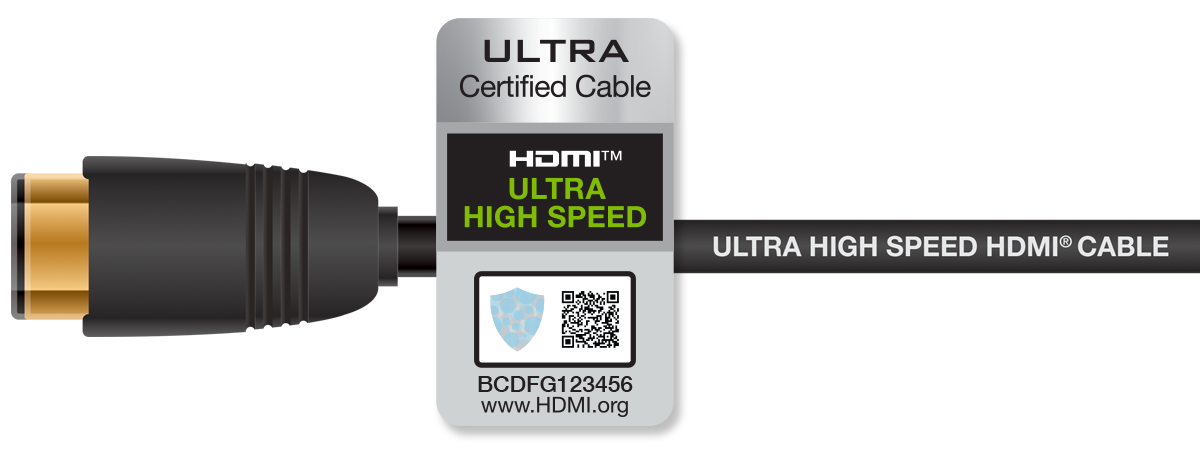

https://www.hdmi.org/spec/hdmi2_1
They said on that site that they would probably be available sometime in the first half of 2020 but that might have been just wishful thinking.
From that site:
" Existing HDMI High Speed Cables with Ethernet can only deliver some of the new features, and the new Ultra High Speed HDMI Cable is the best way to connect HDMI 2.1 enabled devices to ensure delivery of all the features with improved EMI characteristics. "
So be careful like Fleat said.
Other fiber hdmi cables that come out later claiming hdmi 2.1 might work without being "officially certified", and the ultra hdmi cable spec info on that site could be some marketing on top of the certification, but I'd get one of those ultra ones when available to be safe.
