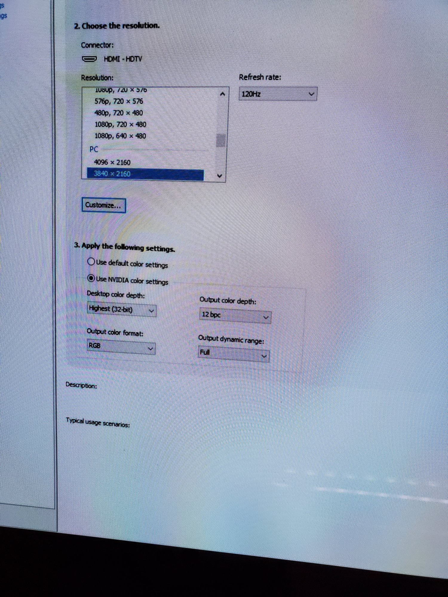

I got my club3d adapter.
Im able to do 120zh and RGB. If I mess something up on the nvidia, it will do a black screen and I just need to wait for it to revert to the previous setting. At word I need to unplug and re plug the hdmi...so I dont need to restart the pc at all. I thought first I thought it made the screen looked weird, but it actually reset the TV setting, so I had to re do it, then it looked fine.
Actually 8-bit dithered RGB at 120 Hz is still better than 10-bit RGB. You get less banding from a temporally dithered lower bit-depth signal, especially at high refresh rates. If the source were to render to a 12-bit+ surface and output a 10-bit dithered signal, that would be better than 8-bit dithered.
Say what? Sources?
Windows / NVIDIA drivers don't even dither by default. There is a supposed registry hack for dithering; not sure if it's a 100% solution. I'd still like to see reliable sources that say a lower bit dithered is better than a native higher color bit depth. Everything I've ever read said the opposite.
I'm not so sure about 8Bit RGB dithered being than 10Bit RGB but from what I've tested between 8Bit RGB and 10Bit 4:2:2 in HDR, I cannot tell any difference at all. So at the very least 8Bit RGB seems to be on par with 10Bit 4:2:2 making there zero reason to ever switch color depth from 8Bit RGB. I'd rather just leave it at that settings for both desktop and games.
At 120 Hz, even 8-bit RGB is subsampled to 4:2:2. So clear text may be impossible at 120 Hz.
I'm currently running 120 Hz 10-bit YCbCr422 with the adapter because it's the only format that works 100% of the time without randomly getting washed out in HDR. Sometimes 120 Hz 8-bit / 10-bit RGB doesn't get washed out.
Reactions: elvn
With the adapter at least, the CX does not display 60 Hz 10-bit RGB without subsampling to 4:2:2 internally. At 120 Hz, even 8-bit RGB is subsampled to 4:2:2. So clear text may be impossible at 120 Hz.
I'm currently running 120 Hz 10-bit YCbCr422 with the adapter because it's the only format that works 100% of the time without randomly getting washed out in HDR. Sometimes 120 Hz 8-bit /10-bit RGB doesn't get washed out, but the CX subsamples it to 4:2:2 anyway.
I don't have the Club3D adapter. I'm just using a straight HDMI connection from my PC to my CX. I tested some HDR games with 8bit RGB and 10bit 4:2:2 and between the two modes, I saw no differences. Unless the CX is still subsampling it to 4:2:2??
