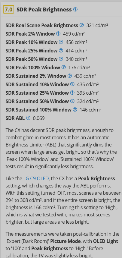

According to RTings CX review, the CX has aggressive ABL like the C9, E9.
"The CX has decent HDR peak brightness, enough to bring out highlights in HDR. There's quite a bit of variation when displaying different content, and it gets the least bright with large areas, which is caused by the aggressive ABL. "
That is how it is with HDR.
With SDR, there is a Peak Brightness Setting. Since it limits the peak brightness it doesn't seem compatible with HDR.
From the Rtings C9 Review, regarding SDR settings concerning ABL:
"If ABL bothers you, setting the contrast to '80' and setting Peak Brightness to 'Off' essentially disables ABL, but the peak brightness is quite a bit lower (246-258 cd/m² in all scenes)."
