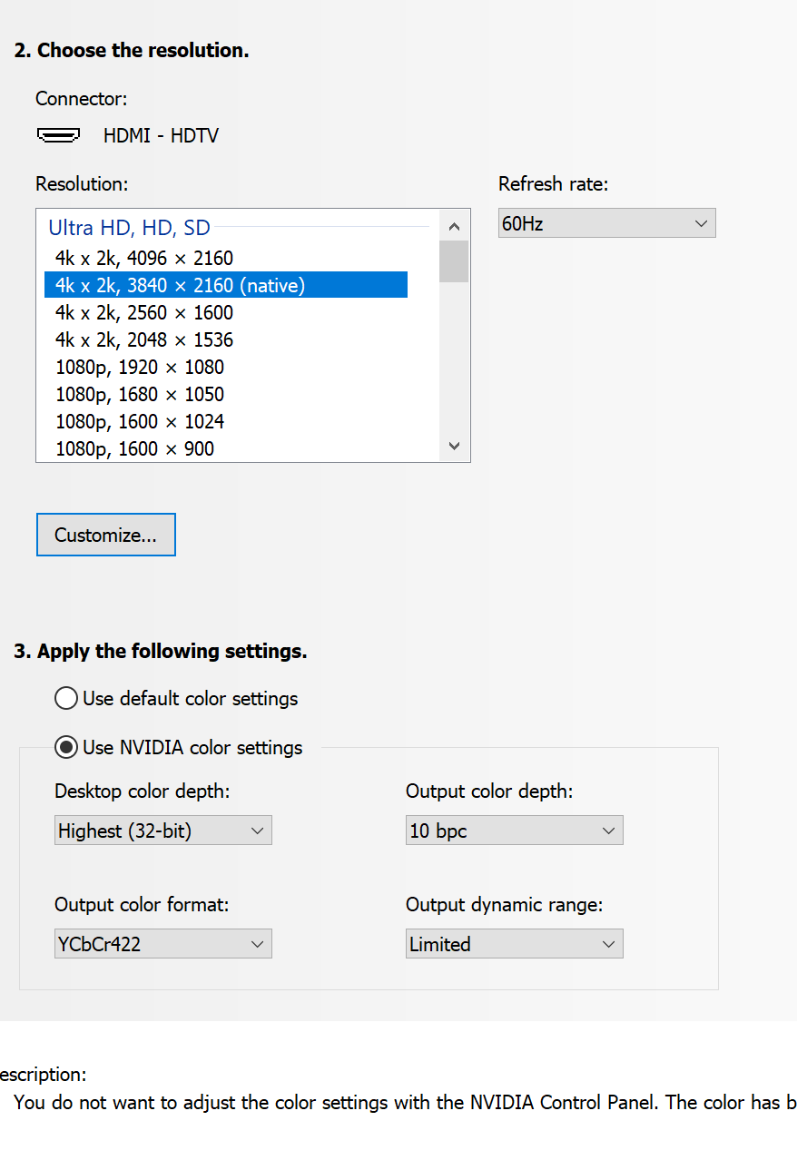

How were you getting 10 bit before? I thought nvidia doesn't support 10bit through HDMI.
Not supported, not at 4K anyway.
Interesting. Well technically hdmi 2.0 does not have the bandwidth to do 10bit 444 at 60Hz. Does it at least show up at 30Hz? I think you may have just solved one of everyones biggest questions about nvidia supporting 10 bit over hdmi.
Just tried 30hz - no go for 444 10 bit.

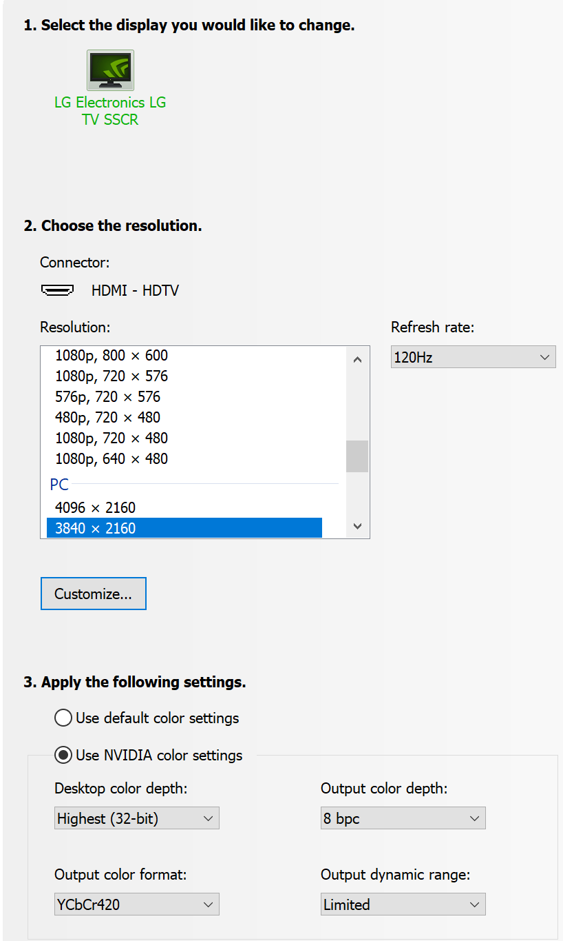

Edit: PPI issue was fixed when I changed to PC mode. It looks like the TV defaults to 4:2:0 over HDMI. [More info.](https://www.reddit.com/r/OLED/comments/hfan8y/lg_cx_pc_mode_and_game_mode/fvxfmmb/) Text is crisp and clear now after the fix, I would put the effective PPI somewhere around 1440p now.

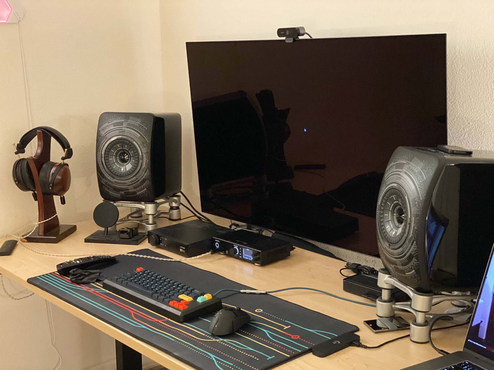

Take some pics. We would love to see your setup! Especially with you sitting at your desk and someone else taking the pic. My desk is about 2 1/2 feet deep also.
What mount if any are you using. C'mon give us the details!
Luckily I have an 84” wide Uplift desk which gives me a ton of flexibility. It’s pretty deep too.
