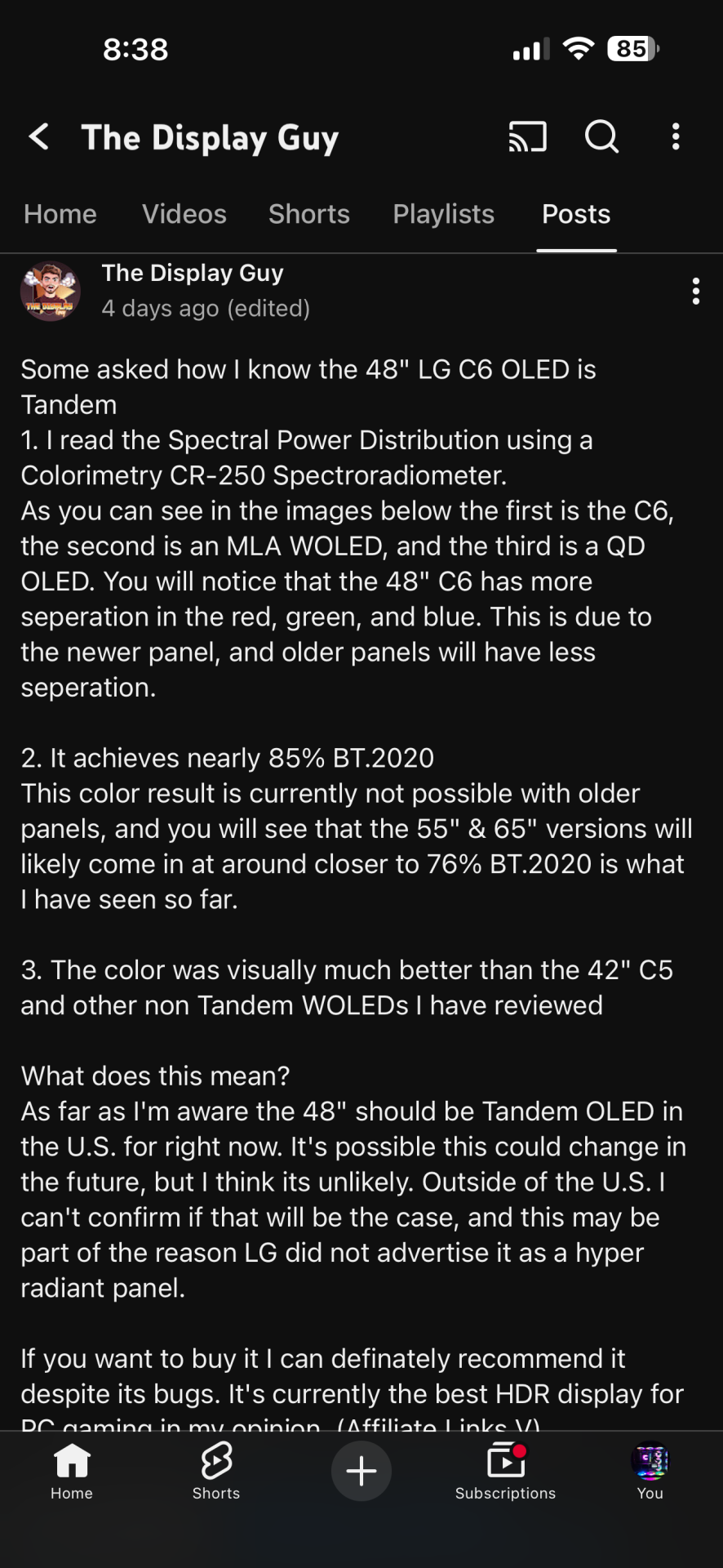

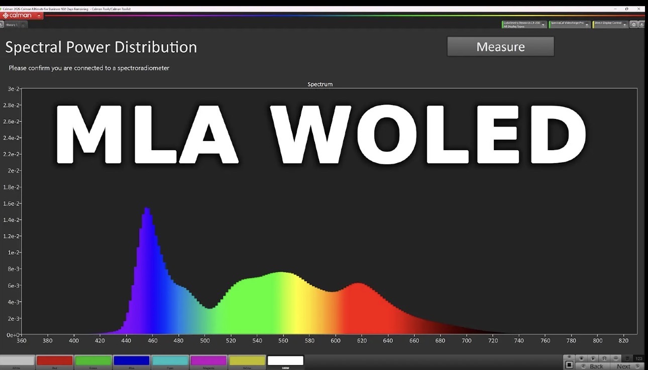

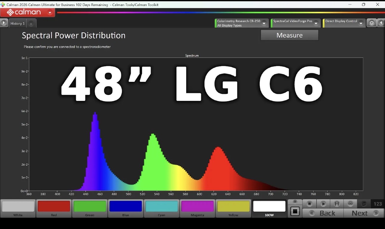

The 48 inch C6 has a tandem panel. The spectral power distribution graph proves it. I'm not a huge fan of the displayguy, but he has no reason to lie about this.

I'm saying you don't need a G6 to get a tandem panel anymore and tandem panel was one of the big selling points for G series. As for PQ issues I don't know that seems to be subjective as to how bad it is.

I finally got around to watching the vid. Interesting.
He said it got rid of the diagonal dithering, but he said it got rid of the dithering "just like the G6" . I'm not sure the G6 did, or I was unaware of it I guess. However, he did post this in his video as proof, up close even :
He also said he thinks it "might" have less banding - depending on the source
So, it sounds promising. Since it's new, there is no discount available on the LG partner store just yet - which is where I got a discount on my LG gx950a. I'll keep an eye on it and hopefully get more details about the dithering and other cons/problems as compared to the ones on the G5, G6.
Edit: Idk if he just reused the same dithering comparison image from his G6 video or not. (He could have just screen-capped the same thing in both instances).
