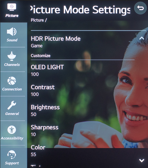

Picture Mode:
As for the picture mode, Game Optimizer or HDR game Optimizer (C1) or Game Mode (CX) will remove processing so that you will get the least input lag -
- but to me, as long as you have all of the interpolation and any other enhancement settings manually turned off on the mode, the other headings are usable in games. The most likely scenario is using most of the other modes for movies and vids and a dim mode - so I'd only zero one other heading extended features wise and customize it for an alternate "game mode" for testing purposes settings wise.
Instant game response should override other modes and swap it to the actual game mode automatically anyway initially though, and back when out of the game, if you have that enabled on the hdmi input (see next image below). I use HDMI eARC out which I think is still incompatible with instant game response hdmi auto-sensing - so most of the time I keep my PC rig's 48CX PC hdmi input on game mode manually and leave it there. If I want to watch movies/vids fullscreen rather than in a desktop window I'll switch to my nvidia shield hdmi input via the remote, with non-game picture modes used on that input. You can also use the web OS with youtube, netflix, amazon video, emby/plex , etc. I think the WebOS will be considered a different input like a whole new hdmi input with it's own picture mode settings.
Any of the named settings can be customized so you can make them your own for whatever kind of material you want them to be used for. They are just a good starting point but you can zero every single heading within any of them and start over if you wanted to. For example, I changed a lot of the vivid settings so it's not extreme nor dynamic. I use vivid mode for anime/cell-shaded video material that I still want to have a little more pop/saturation on along with different motion interpolation settings for it's low frame rate animation (which otherwise can cause some weird artifacts). I use APS as a dim screen usage scenario and a few other picture modes for movies, bright room, dark room. Note that the HDR and DV picture modes won't show up for editing unless you are running that material on the TV at the time.
Some people complain that game mode is dull and lifeless (un-saturated color wise). I just turn up the color saturation in the extended color settings on that game picture mode considerably to make it more vivid. [While in Game Picture mode: Picture -> Picture Mode Settings (press pointer on the heading) --> Color slider]. I can further adjust more or temper it down to less on a per game basis using reshade or nvidia freestyle until it looks great for that particular game style. So I keep the OSD's game mode color setting slightly high as a starting point. That is for SDR games. HDR/DV has it's own scale of color volume that kicks in automatically (and is well saturated and luminous) so it's not necessary for HDR games. My color setting adjustment is ignored by them as it switches to a different HDR gaming picture mode automatically when playing those games.

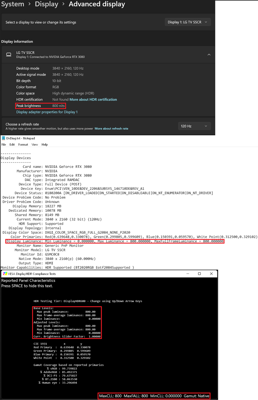

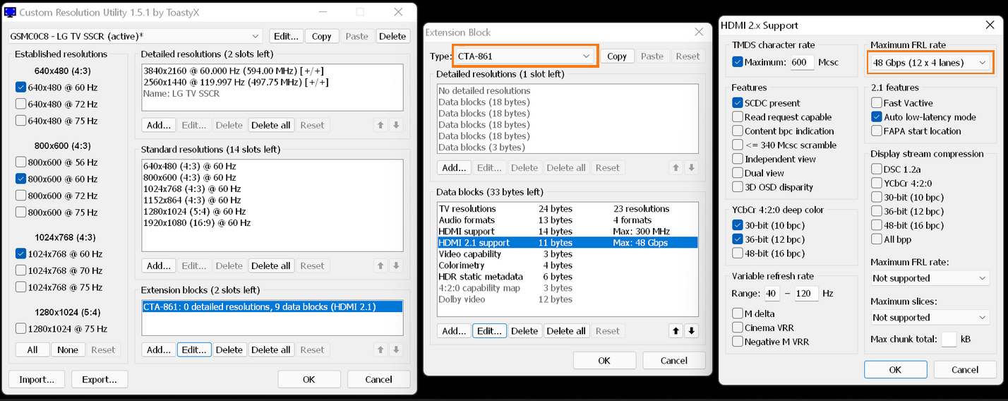

"HGiG tone maps to actual max TML of panel and will most accurately display a tone mapping curve set in-game or on system level."
"For Windows 11, you can use CRU to set tone mapping curve [Edit.. CTA-861 > HDR Static Metadata], otherwise Windows uses maxTML/maxFFTML/minTML 1499/999/0 nits. Quickly toggle HDR in Windows 11 using Win+Alt+B. "
Auto HDR (Windows 11/XSX) converts applicable SDR games to HDR10. (edit by elvn: sort-of. It ends up with a % of the highlights, not full HDR range)
DTM Off tone maps to maxTML 4000nits.
DTM On tone maps on a per frame basis. <---- (edit by elvn: the regular DTM, rather than HGiG, is guesswork/interpolation so it does so inaccurately, causing greater compression on the top end which loses color gradations/details and could cause side effects (perhaps even banding)).
Dolby Vision for gaming enables native DV games and converts all HDR10 games to DV set in-game maxTML to 1000nits.
That reddit recommending setting guide's readout post CRU edit to 800nit on windows 11:
