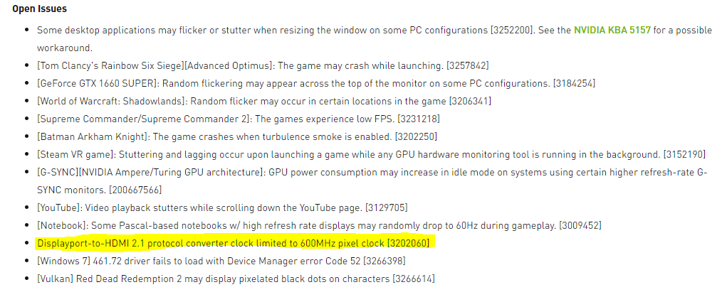

Seems Nvidia has finally acknowledged the issue with the Club3D adapter on any driver newer than 456.71. "Displayport-to-HDMI 2.1 protocol converter clock limited to 600MHz pixel clock [3202060]". Too bad it did not get fixed in the driver that dropped just today.

Well, Nvidia fucks yet another thing up. It seems my CX 48" is no longer detected as G-Sync capable on the latest driver when using HDMI 2.0 despite that being one of the things supposedly fixed by the driver.
EDIT: Had to use DDU to reinstall from scratch to get G-Sync back even on an older driver.
With the driver from december my LG CX was recognized as Gsync compatible.
After installing the current driver I had to go to Nvidia Control panel, Gsync, where it shows "not compatible" and set the checkbox for "use it anyway". Works just as before now for me
Yea I've had the same expeirence. No impact on g-sync performance/functionality.

For me the whole G-Sync tab went missing, even downgrading back to an older driver. Had to run DDU to get it back and then it seemed to work on the newer driver as well.
I also figured out how to use the 456.71 driver that works with the Club3D adapter but have the latest DLSS 2.x support. It wasn't working in Nioh 2 so what I did was use NvCleanInstall to extract the 456.71 and 467.72 drivers, then I installed 467.72 and copied the C:\ProgramData\Nvidia\NGX folder from this driver elsewhere. Then I copied the nvngx.dl_ files from the 467.72 package to 456.71 installation and installed the older driver. Finally I replaced the C:\ProgramData\Nvidia\NGX contents with the ones from the latest driver.
Now Nioh 2 can run DLSS 2.x on my older driver! Neat trick if you want latest DLSS support but need to run an older driver due to some issue.
Nioh 2 seemed to work fine with DLSS before the new driver came out, they patched the game a few days before it and I ran it fine, saw the same performance increase.
Yes it did but it did not work on 456.71, which is the newest driver I can use unless I want to lose the benefits of the Club3D adapter with my 2080 Ti. It's a bug Nvidia hopefully fixes in their next release.
