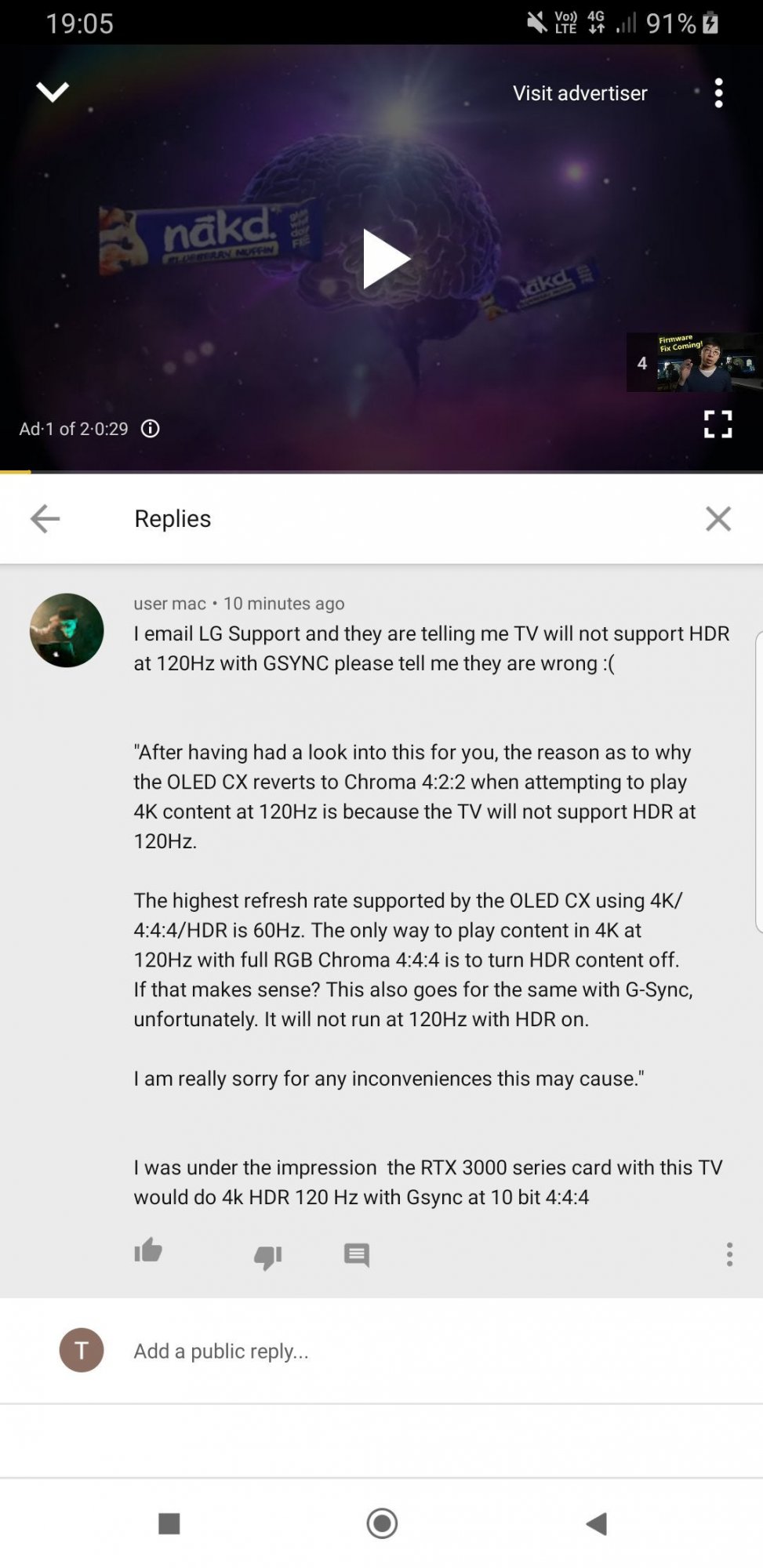

This been already discussed in the CX48 thread. They know of the issue and looking into releasing a firmware update in the following weeks.New poster here guys, this is a concerning comment on the latest HDTVTest video re the LG issues, no HDR at 4k 120hz with gsync as it's not possible, i've sent it to Jonh at Forbes and he's going to speak to his LG contact about it:

Wait I'm a little confused now. So the chroma subsampling to 422 only happens IF you turn HDR ON at 4k120Hz 444? Otherwise it's REAL 4k120hz 444 without HDR OFF? Or does LG tech support have no idea what they're talking about?
4:4:4 4K 120hz HDR = dont work
4:4:4 4K 120hz g-sync = dont work
4:4:4 4K 120hz SDR = okay
4:4:4 4K 120hz SDR g-sync = okay
4:4:4 4K 60hz HDR = okay
4:4:4 4K 60hz g-sync = okay
is what I get from the above.
Yes. 4:4:4 4K 120hz g-sync HDR isn't supported.I think you meant this? .....

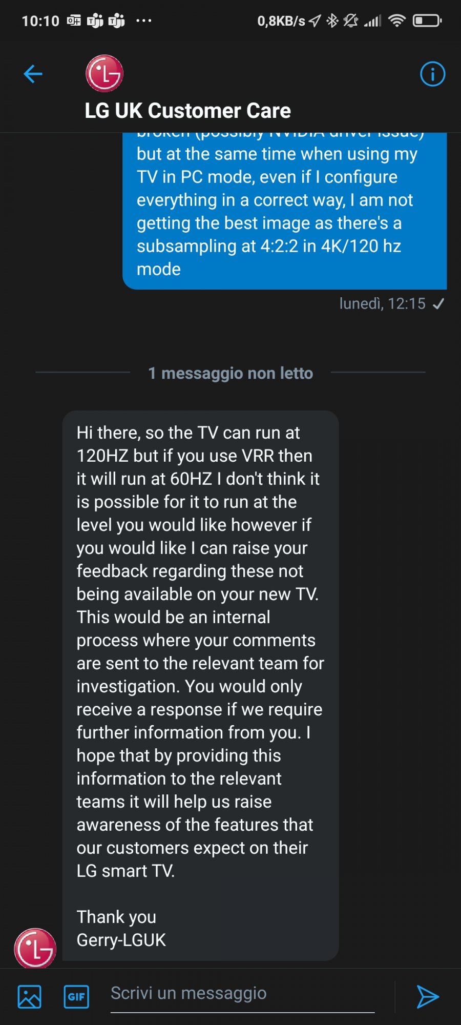

Another response from UK customer care this time, just posted to reddit by someone, this isn't looking goodView attachment 281921
