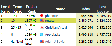

We have a new cruncher, Adam J Bavier (AJB?) who just joined this challenge. If you happen to read this post, just drop us a line. We welcome you to our team(y)
Thanks for the welcome! Those points are from 9 hours of processing on the 1080. This project certainly dishes out MILLIONS of points! :playful:
