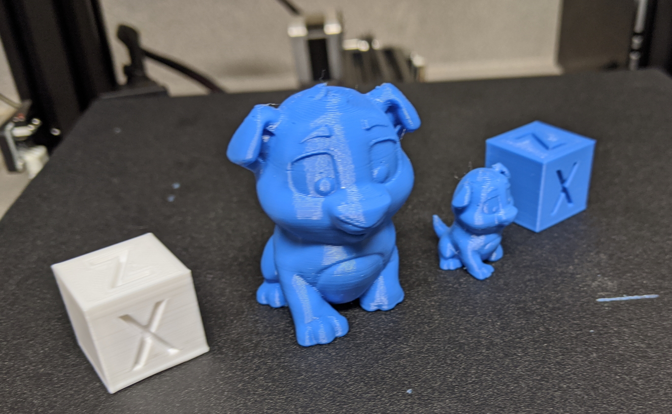

After a lot of futzing, swearing, and drinks I think I have this thing tuned in for PLA. The cube and level verifier helped quite a bit.
https://www.thingiverse.com/thing:1278865
https://www.thingiverse.com/thing:3235018
Oh geeze, and yes.. CALIBRATE THOSE ESTEPS! That seemed to be the last blocker to get this really humming.

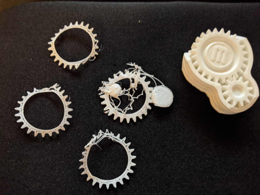

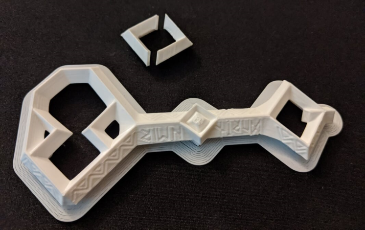

Things I've printed:
The makerbot fidget gear was especially a great moment. After failure and failure and more failure I finally have things tuned enough withing tolerance to print functional gears - in their housing! Super neat.
