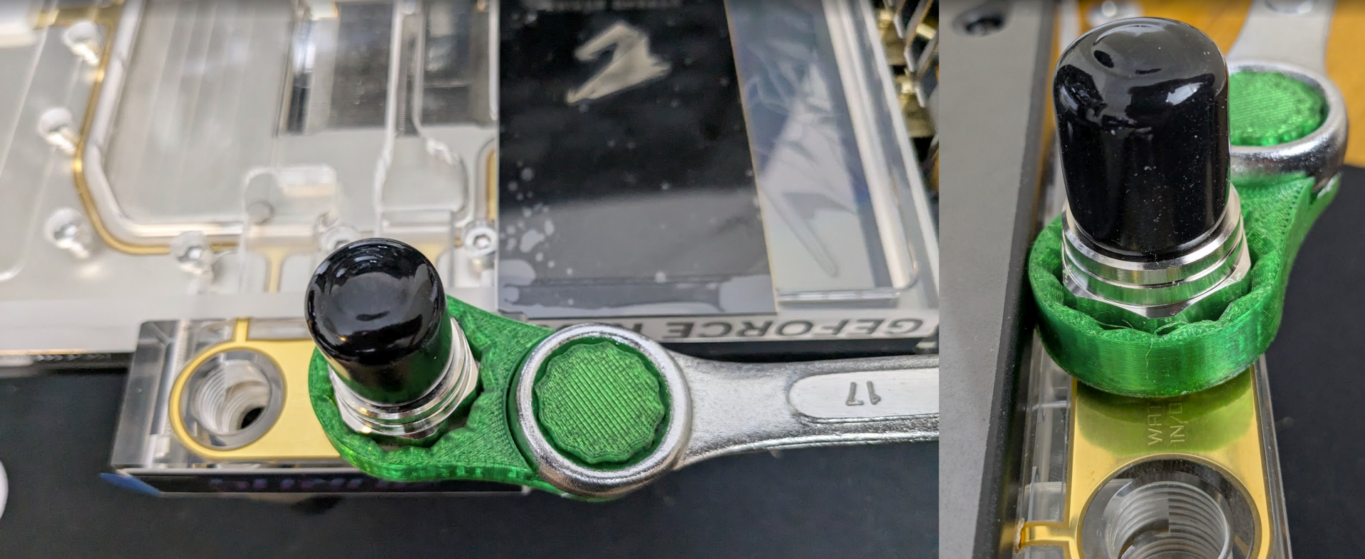

I used 7 perimeter walls so the entire outer wrench is all looped for max strength, 5 top and bottom layers, and 20% grid infill. Takes about 25 minutes to print in PETG. The one thing I have to keep doing is increase the XYZ axis sizes to 101.5% in the slicer. I think that's because PETG shrinks? I want things to friction fit in the hole of the metal wrench, but not too tight or loose. I'm not sure if that's because I'm printing at 242C or if my cooling is set too high (its only at 15%).

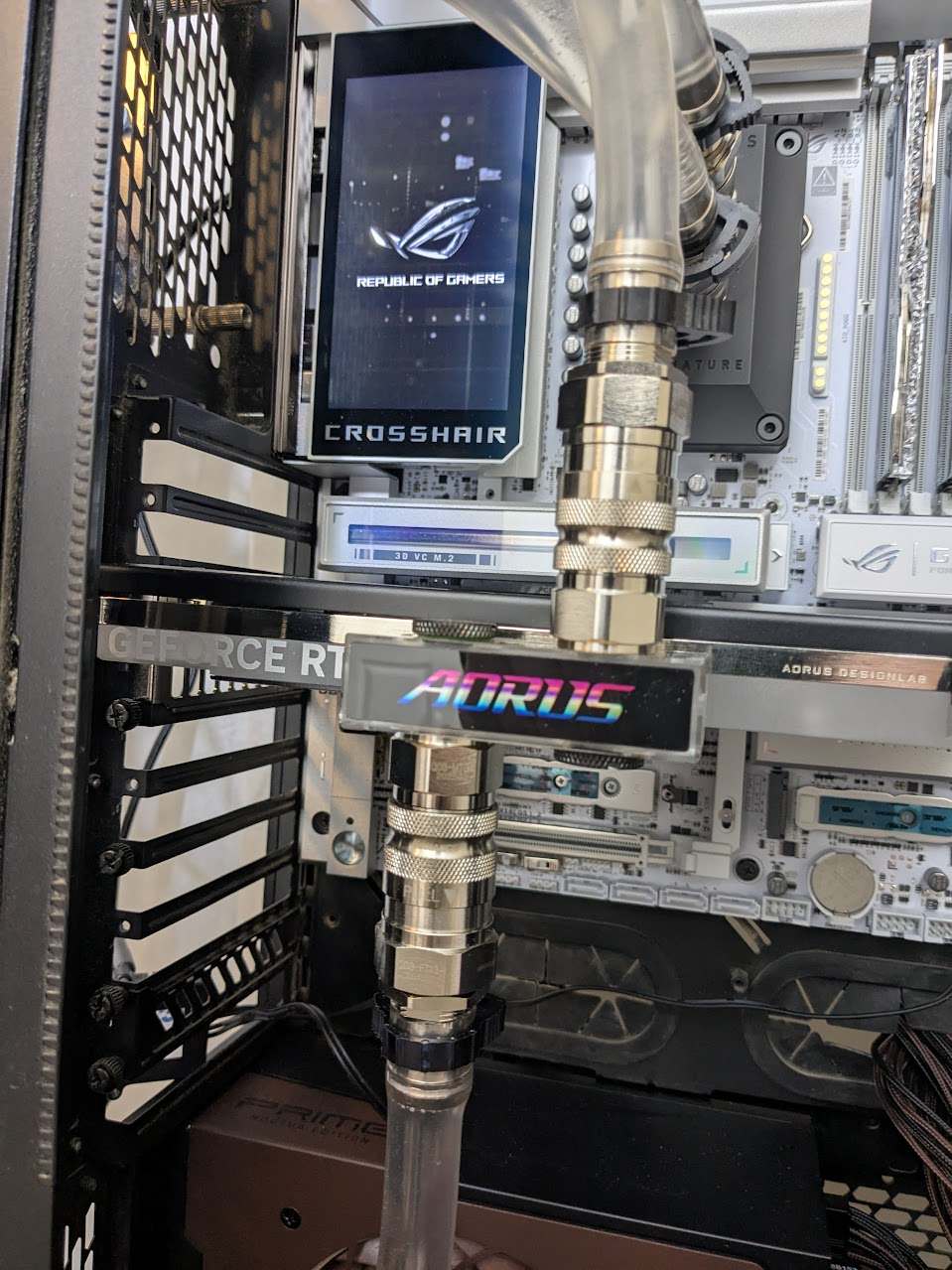

A friend of mine bought a second 5090 Gigabyte Aorus with a preinstalled water block. The PETG 22mm closed wrench leaves no scratch marks.
Also is just thin enough to not hit the back plate (right picture).

I've been water-cooling since 04/05. I've always just used my fingers. Not once have I had a leak.
Neat though. And awesome build.

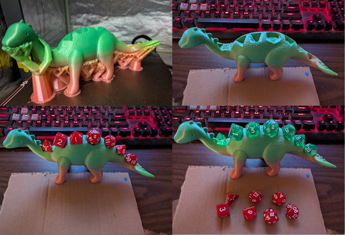

My 2nd most recent print (which for some reason printed at like 300%, and I
didn't notice until it started.)

Was that the intended results or a botched setting?
Also kudos on finding such an interesting shade of... brown. haha
