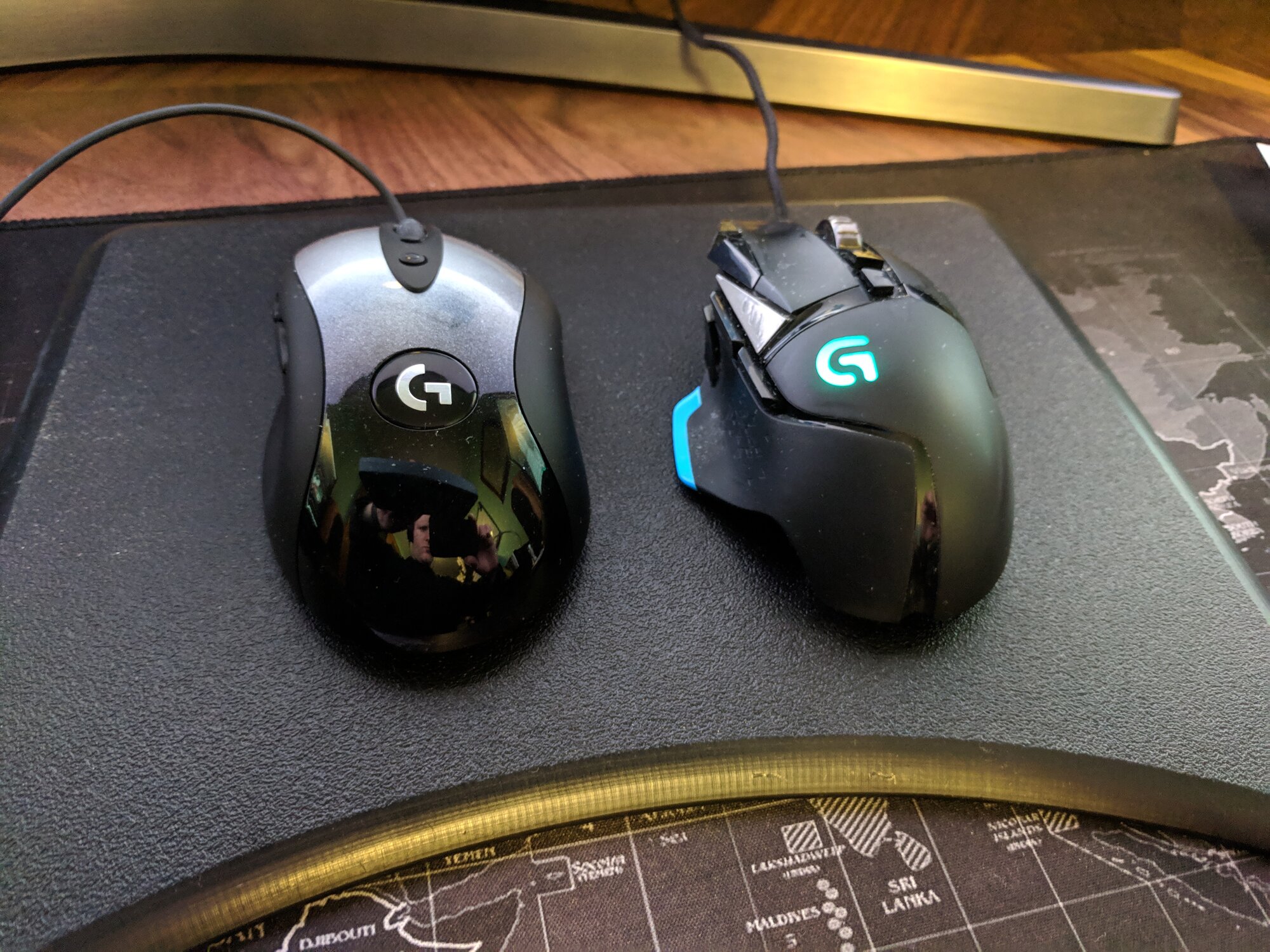

So, another thing I noticed about this mouse compared to my G502 is that it is much more sensitive to uneven surfaces.
As soon as I put it on my old Ratpad and started using it, it was dragging on the surface really badly.
Looking at the Ratpad it was evident that the warping had set in.
So, I bent it back and now the motion is smooth, bit the odd thing is I never noticed it with my G502
Maybe it rides higher on its feet. Or maybe I just worse the G502 a rounded bottom through extebded use on the thing? :p
