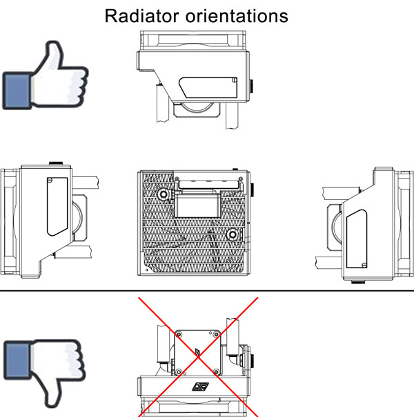

Assuming that the 140 is in the rear exhaust position and the 420 is on the top that layout should work fine. As I said you want to keep your tubing runs as short as practicable which will usually look better too.

If it's too late, you can disregard this, but I started my watercooling journey with a Swiftech H140x too.
Friend... It was awful and I didn't even know it. That tiny integrated reservoir made everything about loop maintenance into such a chore it was unbearable.
My recommendation is that you return or sell the H140x and put the funds towards a DDC pump (the AlphaCool DDC310 gets my vote) and a proper tube reservoir pump top. (Barrow makes decent budget-friendly ones for $20 or $30.) The cost difference will be minor, and that 420mm radiator you bought will more than handle your 7700k and a single GPU, should you choose to add one to your loop.

Can the H140-X be mounted upside down and sideways? The instructions say nothing about orientation and only shows shows the 220x mounted from the top of the case facing down (radiator up, pump/reservoir down). Would it hurt anything to mount it with the fill port facing down (so that I can still see the window to keep an eye on the water)? I wouldn't think so, but as wrong as everything has been going I thought I would ask before cutting the tubing.
Here is the stock picture from their site:
So, there's the fill port at the top in that pic, but I would like to mount it facing down.
If I have to, I can just mount it with thumbscrews so I can take it out once in awhile to look at the windows I suppose.

For orientation of your H140
I don’t know about that model specifically.
In general, reservoirs need to be installed with fill port so they are “Up” in your normal case orientation.
Reason being - the reservoir is there to trap air and keep your pump primed and humming along. Air in the blocks and rads is bad, but you want a bit of air in the res because it acts as a cushion for when the water heats up and cools down. That keeps the pressure on your tubing and fittings more consistent. Further more, sometimes the fill ports may have a small vent drilled in them and you don’t want them to drip.
Also, the pumps are usually installed in the bottom of a res in combo units. For obvious reasons the pump needs to be in the water. If you flip it upside down, now the pump is in the air bubble and stuff just doesn’t work out well.

I gotchu, my man! From Swiftech's website:
Their site is a bit wonky, but I only knew about it because of my aforementioned experience with this particular unit. Is it good news? Can you mount the thing the way you wanted?
Yes, it's the one on the bottom right in the thumbs-up section.
The alternative is the one on the left, which would have the window facing the divider in the case (facing the back of the motherboard) which would have been a pain just to check the water level.
Edit: It didn't occur to me to mount it with the window facing up, but apparently that's an option too. Matter of fact, I think I'll do that because the pump is behind it, so if the water level gets low it will still stay at the pump - the one on the right looks like the pump would be at the top of the reservoir so maybe window up would be better?
Edit 2: Thinking about it, window up might make it difficult to tell how full it is...
