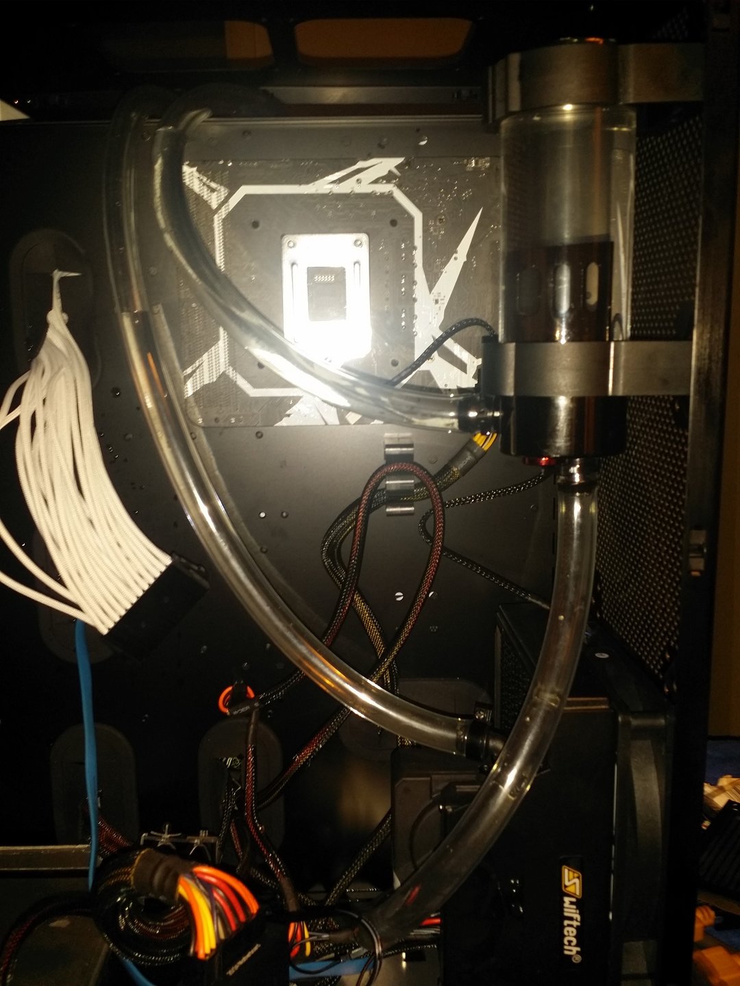

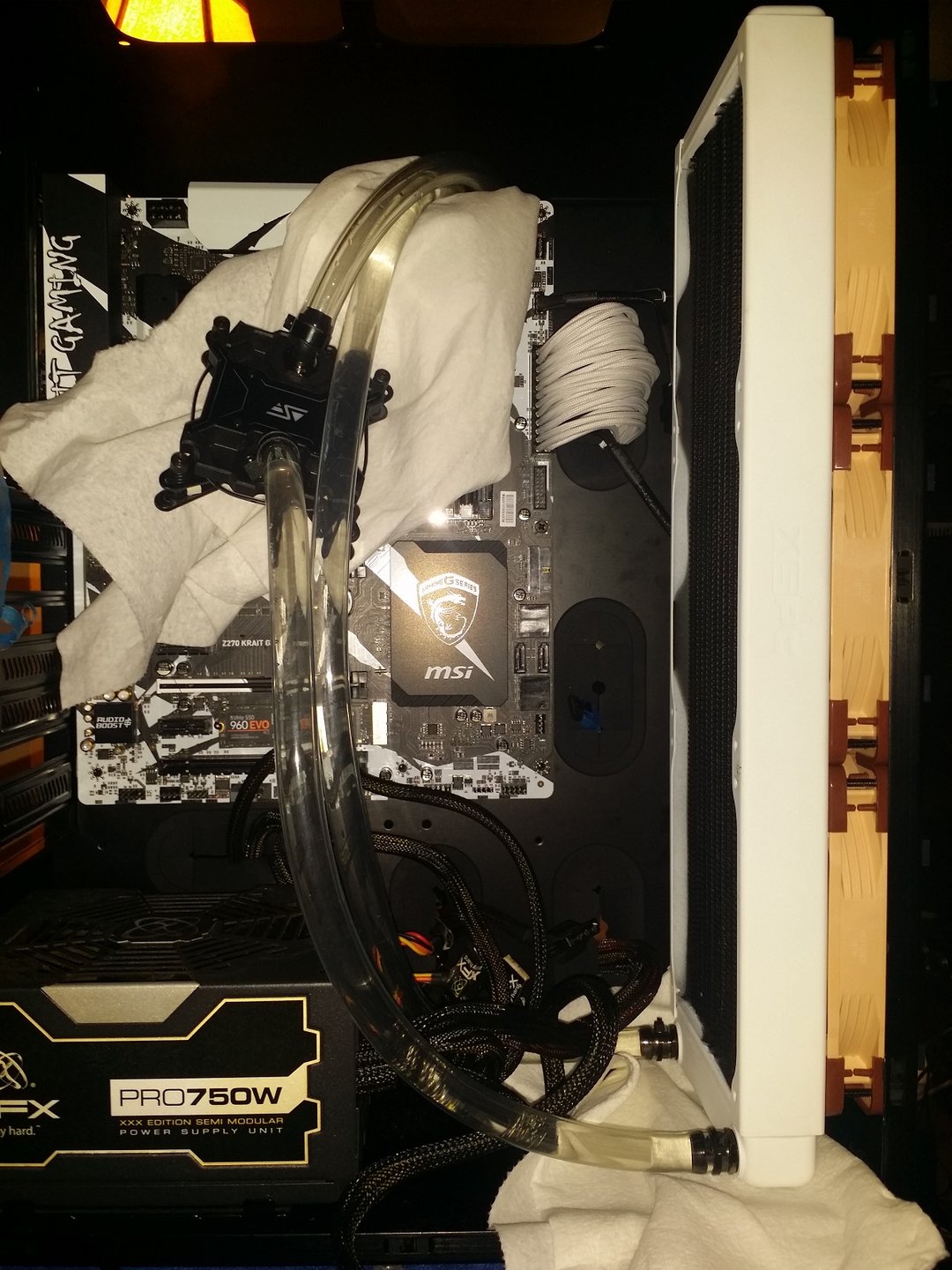

I can't upload a picture just now because I haven't found a place to upload pics (I used up all the free trails). Know any free pic hosts?
But here's how it's set up: The reservoir is mounted vertically using the two 120mm fan screw holes at the top-rear of the case----> This feeds straight down to the H140-X's inlet which is mounted two 140mm fans down at the bottom of the case--->this goes out over the top of the case divider to the CPU block--->the CPU block then goes to the bottom of the case (CPU side) and feeds the 420mm radiator---->the 420mm then goes back up over the divider back to the reservoir.
I would seem I have to alternate between tipping the case sideways and upside down to make any progress. It's as though the pump isn't powerful enough to overcome gravity (it's running full speed I'll assume since the PWM connector isn't connected).
This forum doesn't require third-party image hosting! You can upload pictures straight from your phone and insert them inline with your post. If you're on PC, you can just drag and drop images into the message box and it'll upload them for you. =)
It's tough for me to picture what you mean with your description, because as I recall the Swifty unit has more than one port that could be used as an inlet. Please post a pic if you can.
Ohhh ok, I'll give that a go. Be warned: it's a mess in there, I have lots of cable management n' whatnot to take care of. lol be back in a few...
Ok, on the left (I think, they're side by side on my screen) there is the waterblock feeding down to the 420mm Radiator, and is being fed directly by the H140-X.
On the right is the other side of the case with the H140-X at the bottom being fed by the reservor, then going back up and feeding the waterblock.
So... Reservoir--->H140-X--->CPU block--->420mm radiator--->reservior
P.S. I'll be mounting the reservoir on the back of a fan in that spot but I need to get some longer bolts.
View attachment 42566 View attachment 42567
If you flip that radiator over, you can shorten those tubing runs and make the system a lot easier to bleed...
I was thinking that, but I'm gong to avoid it if I can, it was a real pain in the ass to install. I don't know if it's the case or the radiator, but some of the screw holes barely lined up.
Okay. Here's my suggestion:
Clean up anything big and heavy or dangling, (remove your GPU for this step if you can), fire up that pump, grab your case and shake it like a Polaroid picture.
The H140 has lots of little flat pockets and cavities where bubbles like to get trapped. You want to dislodge those. Your initial goal should be to get it so that there are no bubbles traveling down the line from your res to your pump unit.
Be careful, be safe, tie everything down and don't jostle it harder than you feel comfortable with, but I'm guessing that there's some air trapped in the impeller of the pump and it's hampering the pump's performance. It should quiet down to an almost inaudible hum once all the air is out.

Prime95: 57C pretty solid
Realbench: 56C peak, 50C average (it's jumping a lot between 46C and 51C)
These were both really quick results; maybe 10 minutes of each test.
I don't think I could be happier. This calls for a sixer of Heineken. :)
