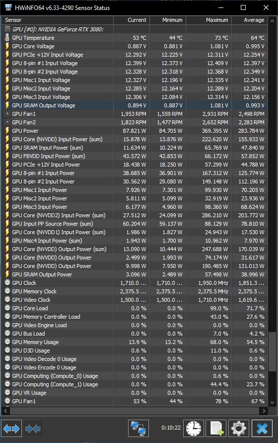

Waiting for your results when you have time. I'm curious if either the 12 pin cable, the hotfix driver, or both, completely fixed your card.
Also curious what your voltage rails look like. Remember to show it during full load (hwinfo64 has a "minimum" and "maximum" table under the voltages).
First image is with raised power headroom, other is stock. Both are heavy load, fan is fairly aggressive.
I haven't had time and I was planning to redo this because I forgot to restart the monitoring app so my columns other than "current' are not useful. I was feeling good on the hotfix driver and then it rebooted this afternoon. Next up, power cable swap. After that will probably downclock memory.. I have to start doing mental gymnastics trying to figure out why other things away from PSU/card/cables/drivers might be the issue. I've also had others reach out with the same issue.

Ok I finally got time to mine my old PCIE cables out and swap in the Seasonic 12 pin cable. I don't love it because it doesn't look good with my other cables but if it's functionally sound then I can worry about asthetics later. Now I just need to let it grind until I feel that it's stable.
In the meantime I pushed the power slider up and let it run Port Royal stress test for a long while. I'm attaching HWiNFO for that run, just look at the max column.
The voltages look the same but it looks like the new cable helped stability?
