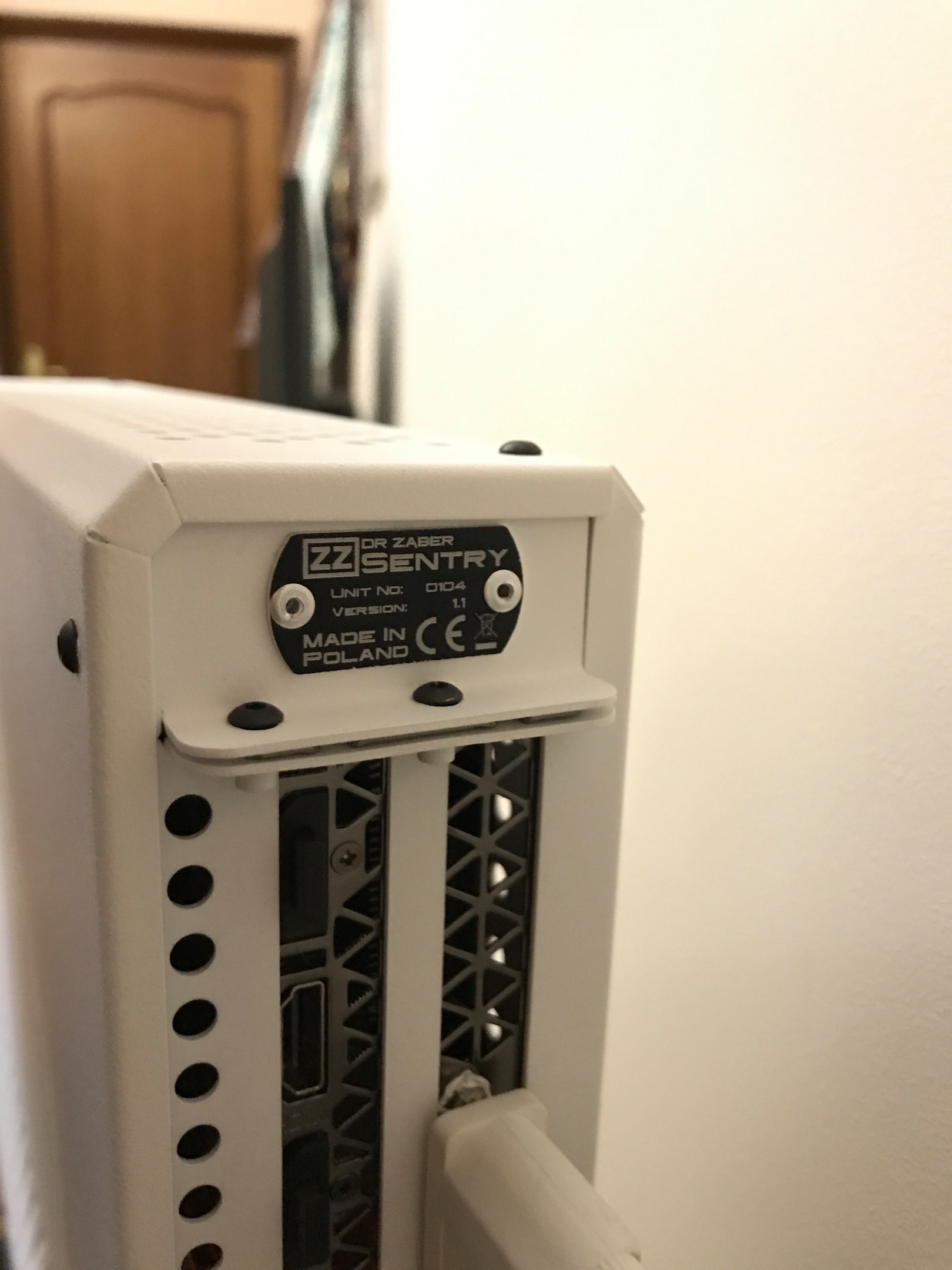

Just received! Thank you Zaber!
Which country are you in?

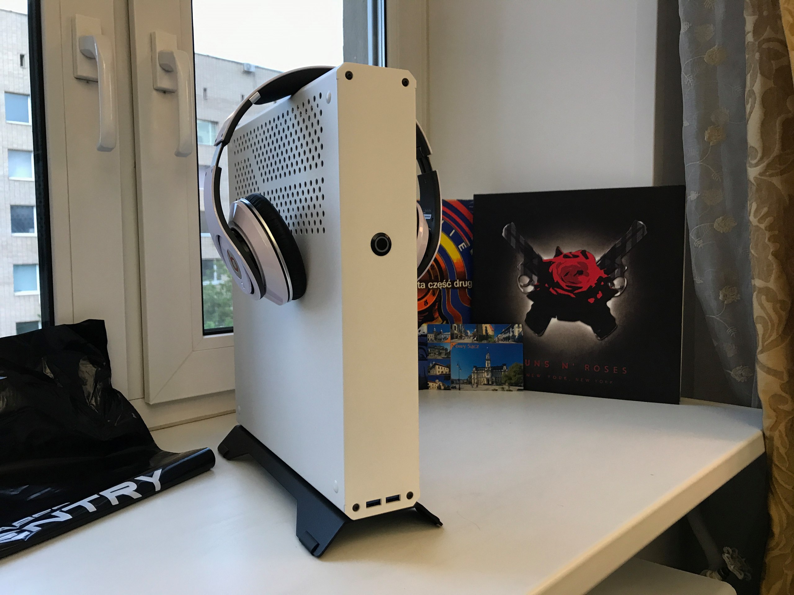

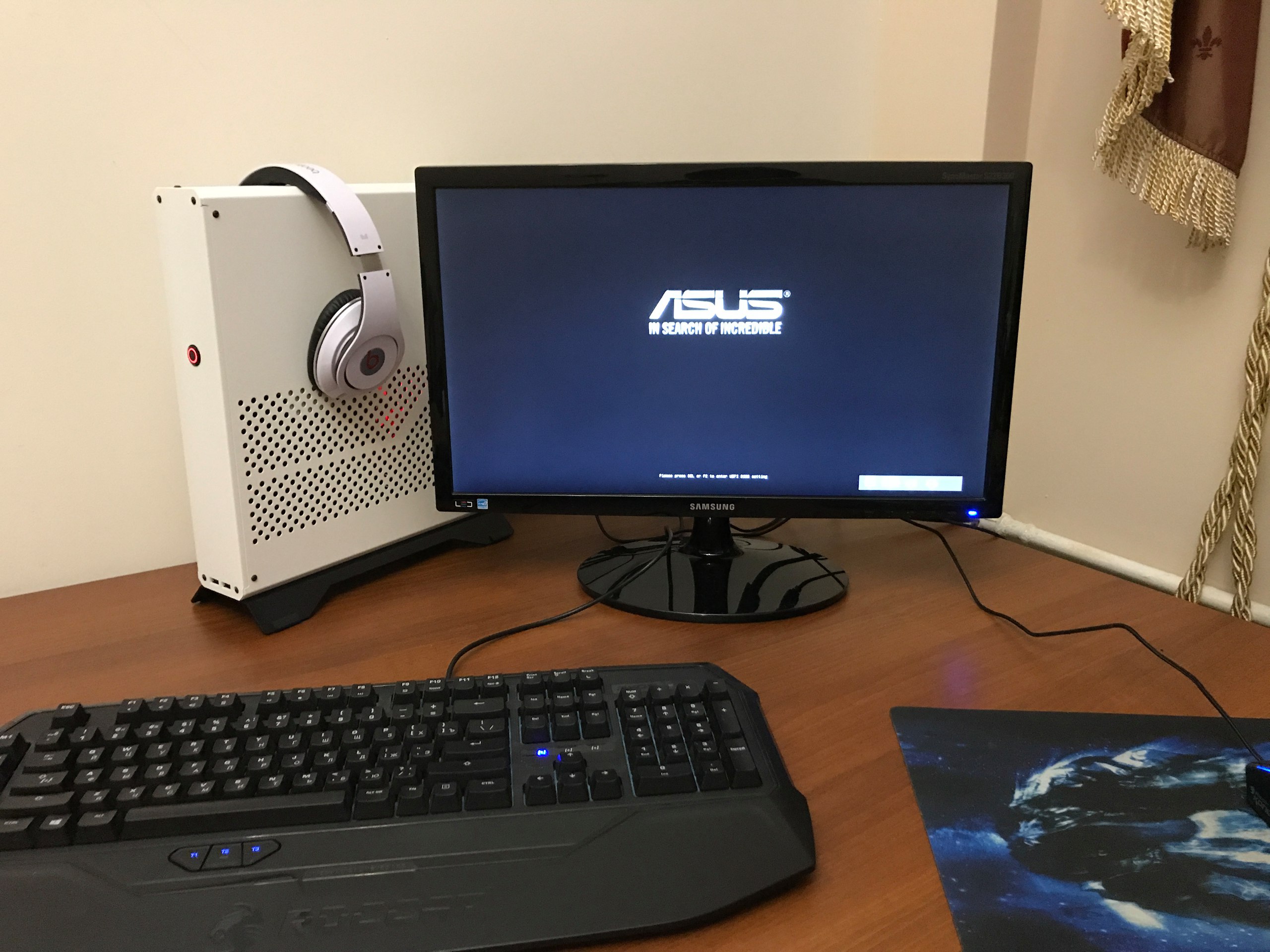

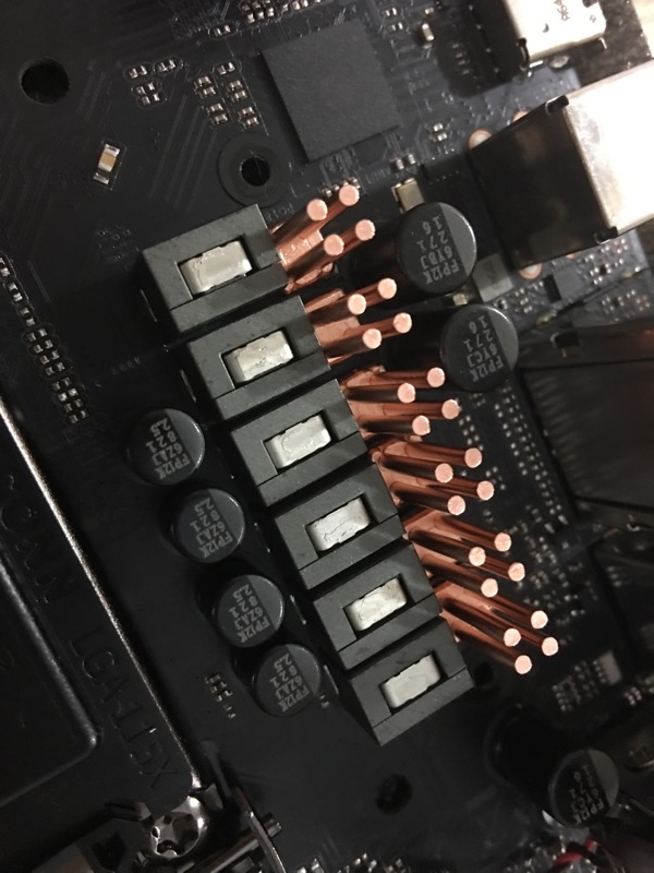

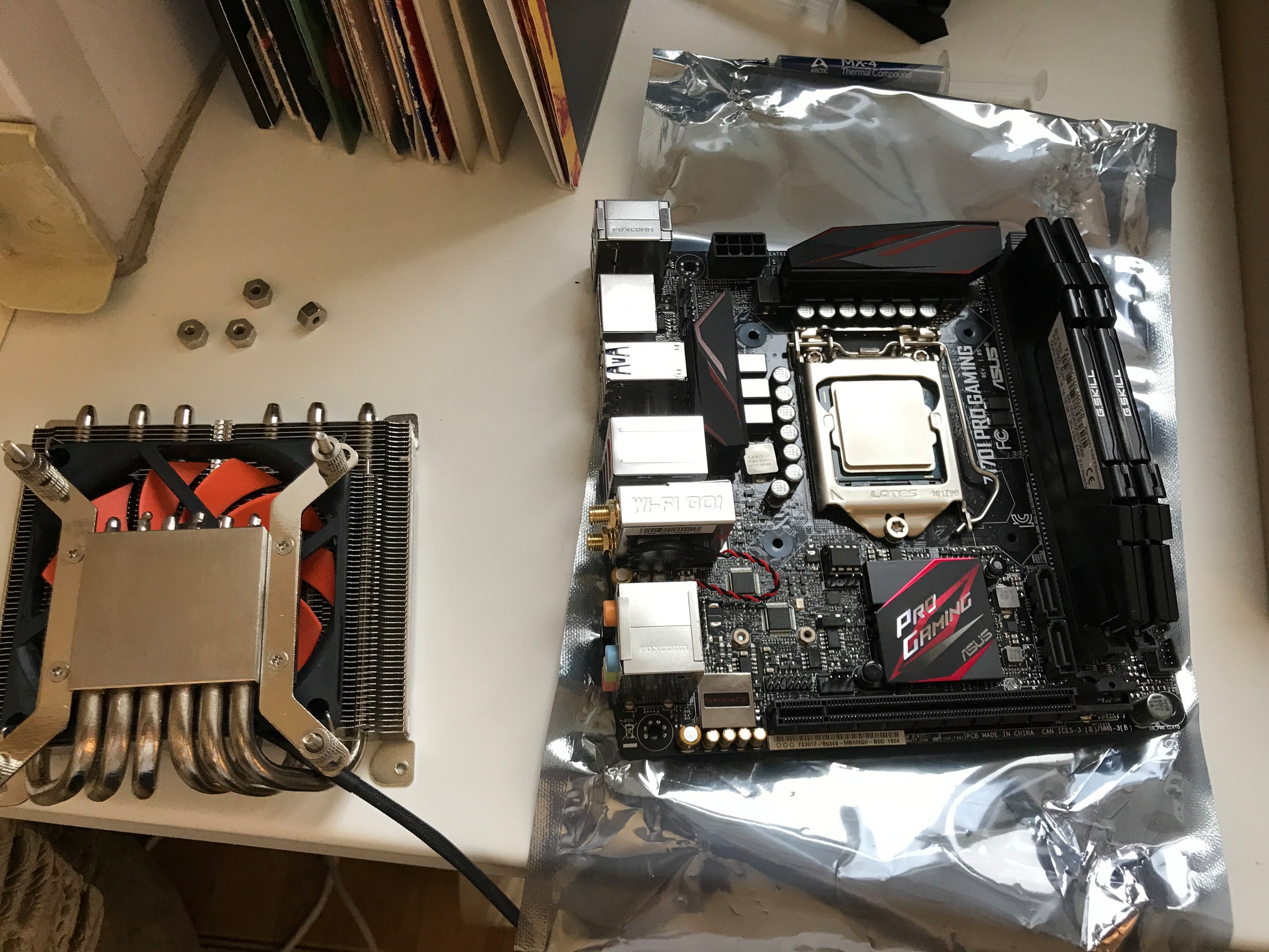

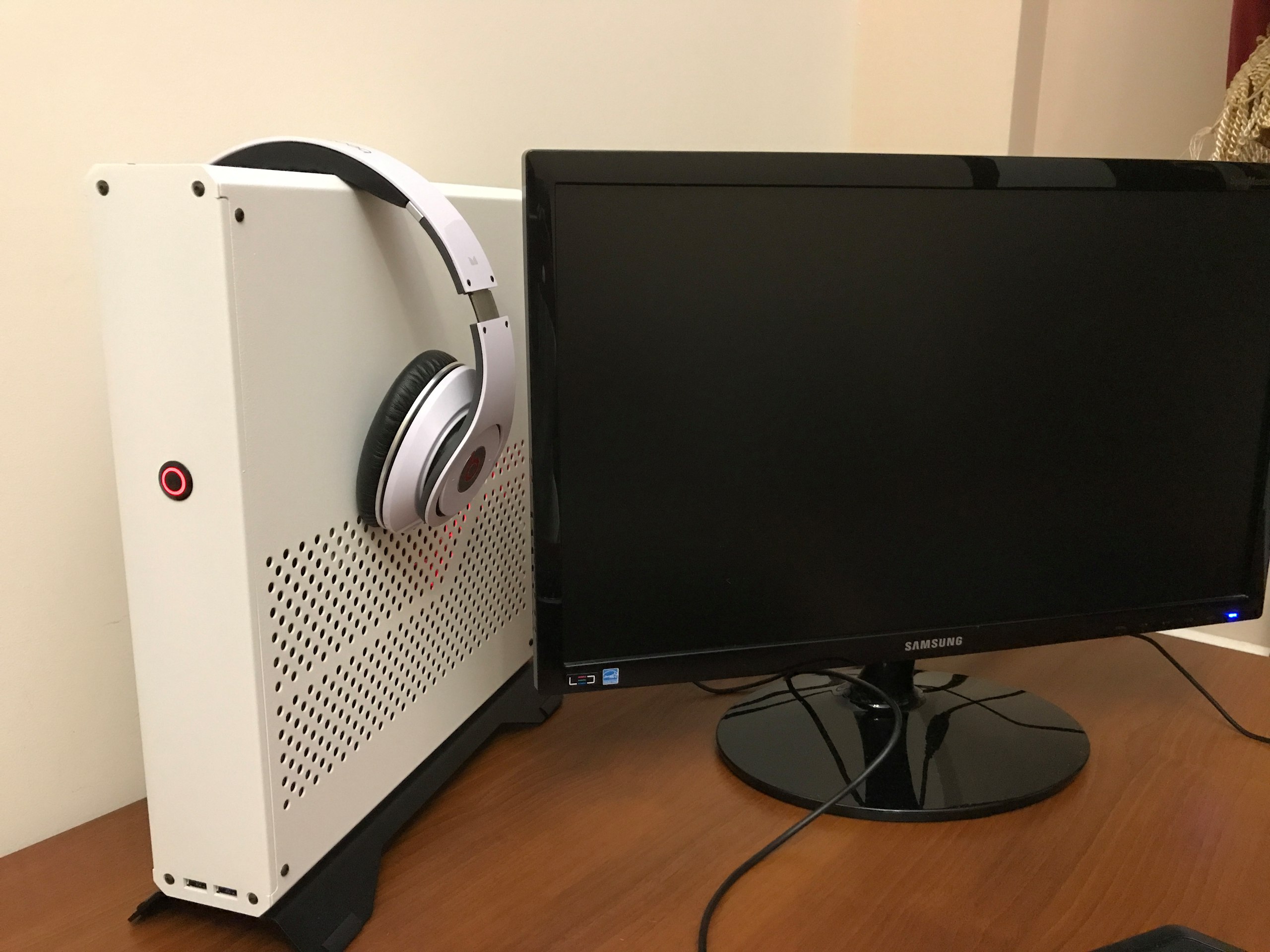

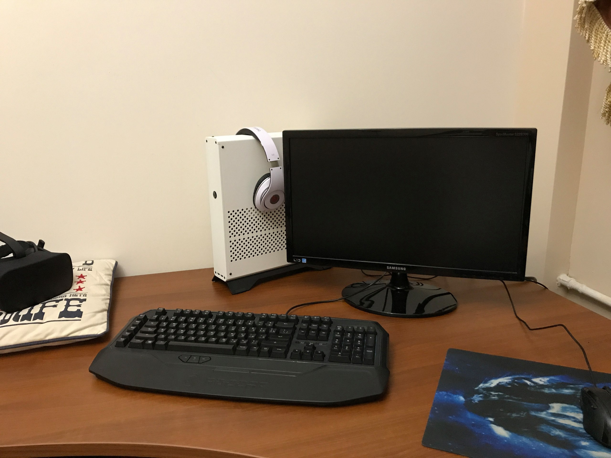

Ok so my is-40 v3 arrived much sooner than I've expected (in like 10 days from China to Croatia, that's pretty good)! So I'll be able to test it soon, during next week. AM4 brackets are included, although cooler is oriented so that fins are perpendicular to RAM and IO backplate. You also get a tube of thermal paste, I could also test that if anyone's interested. Packing is nice and sturdy.
Pictures:
Pictures:

First of all: I really want to thank Krzysztof and Kacper Ząber, our dream comes true because of you.
Here is my little build log with some photos:
Russian post is soo slow, i've almost died waiting for the case.
Package was very good, thank you guys protecting case so well. Even internal box was like "no scratch". Opened it and here is my beauty.
Prettiest case i've ever seen. Btw there is good ol' vinyl from Poland at the back =)
Post card, ooh, that's so nice ^_^
Build parts: i7 6700k, asus z170i, 16gb gskill 3200mhz, gtx 1070, toshiba rd400 256+ tr150 480.
Assembly was ehh.. tight, not saying otherwise. I/O shield was hard to install because i can't align screw holes and i/o holes well. Sadly, but i have to screw MoBo with only 3 screws. Under the Mobo I stick some thermalpads (3 layers of 1.5mm 6watt pads, but i have to squeeze it a li'l bit, it's around 4mm "under the hood") My drive is now 40-60 degrees, after 80-90 w\o cooling and 70 with simple metal-plate (but plate was put on w/o thermal paste or somthing, that's why it was so bad). Videocard was the easiest part.
And some final photos (sadly my main display died just before Sentry arrived, so here is ol' Samsung):
My number is 104. Now you can understand how fast i was refreshing preorder page and clicking "shut up and take my money" button =)
TL;DR: Awesome!
My thoughts:
  • Never ever buy Xigmatek Janus for the Sentry build. Worst cooler imo. I made a huge mistake, because you can't swap stock fan at all (you need 10mm 80x80 only), ofc stock fan is noisy and ineffective, ofc you can't use top fan at all (i knew it, and my idea to use it with noctua 92x92x14 was terrible, it barely fits in the cooler itself, but has a collision with VRM heatsink), choose something else. Btw if somebody can name me Top3 fans for Sentry (cause i don't know if top1 fan will be available in my shop) i will be grateful
  • Advises about cable management in assembly manual you should give before with big red letters, imo. Average builder may have some troubles with that. Especially I/O shield, frontpanel, usb3.0, sata before routing the power.
  • As I've already mentioned you can (and must imo) use the case as a huge heat-spreader with M.2 drives. You need average 4mm good conductivity thermal pad (i've used 6watt 1.5mm x 3 stacked on top of each other. Worked pretty good)
  • Stand is a bit loose, it will be really nice to see some holders (like pin on stand and hole on the case to align)
  • In future version of Sentry you may think about adding videocard support, my card was really heavy and without backplate, I've added some foam cube to prevent damage in transporting.
Damn it was awesome, Thank You again, my Sentry will always remind me of good guys from Poland, Nowy Sącz.
You can replace the VRM (MOSFETS) heatsink easly with one of these
Yeah, but because fan is under the radiator itself, i forced to use tiniest mosfet heatsinks, that means they will be way less effective, and I'm not ready to lose stock vrm. Idea itself maybe not great, but not so bad either. Unfortunately, to do this I must fully disassemble the case, find those heatsinks, buy new thermal pads, reapply thermal paste (cause i can't swap fans w/o detaching the cooler) etc. Easiest way - buy new cooler and add it with next upgrade (maybe ssd space or videocard, or even led strips :))
But thx anyway

To wrap it up, a couple glory pictures. My desk isn't nearly as clean and gorgeous as any of the ones we've seen so far; it makes me feel sort of ashamed... but hey, it's more like a workshop than a battlestation, anyways. It works for me. :p
Ugh, the mess:
Doesn't look too bad from the other angle, though. It goes great with the server that just got moved in here for more regular maintenance.
Just imagine there's a second monitor in there; I sold it to a friend and have been waiting to buy a new one until I can get something really nice. I love my 1440p Iiyama, but I really miss the smoothness of a high refresh rate. I'm hoping to eventually get the 1440p gsync HDR ultrawide that Asus announced at Computex.
This was 112% worth the money and time, and I couldn't be any happier with it.
I know that I said I'd do some benchmarks of pcie cables, but unfortunately the drunk-stress-testing got in the way of that. I do, however, have the cable, so if anybody wants to test it out, all they have to do is pay shipping from the west coast USA and it's theirs; I'm not going to be using it anytime soon. (*And that should be fairly cheap; it can just go in a bubble wrap envelope.)
