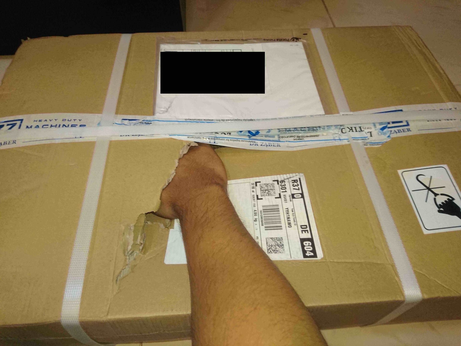

Order 1199, Unit 837 reporting on package condition :D
Outer box has a hole large enough to easily fit my hand in.
Fortunately, the inner box is in very good condition.
However, there is a minor tear in the back, probably, due to flexing during transit.
No worries; the case itself is in perfect condition. I'll be building my system in a few weeks after Coffee Lake releases.
Again, thanks to Dr. Zaber team!

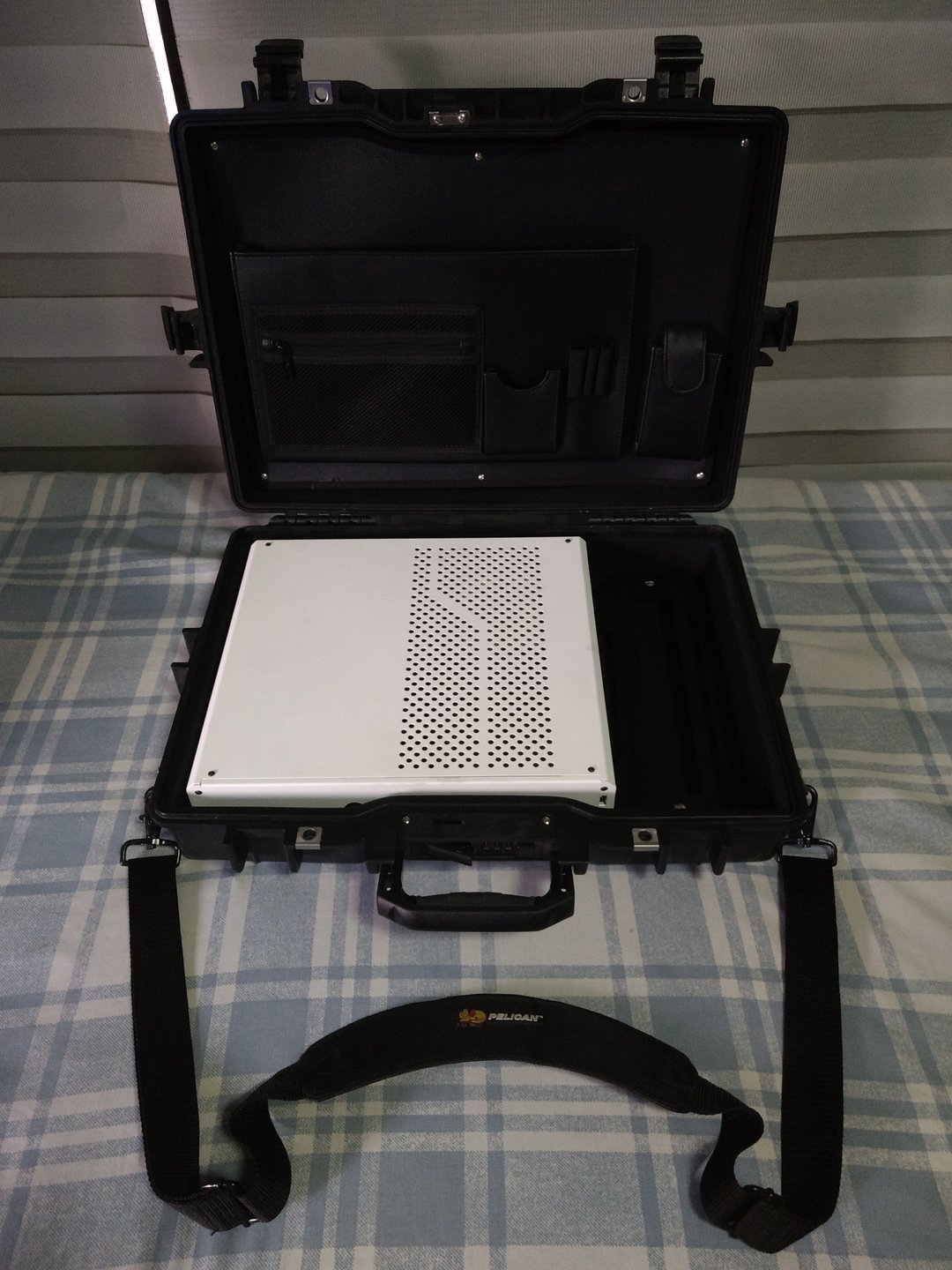

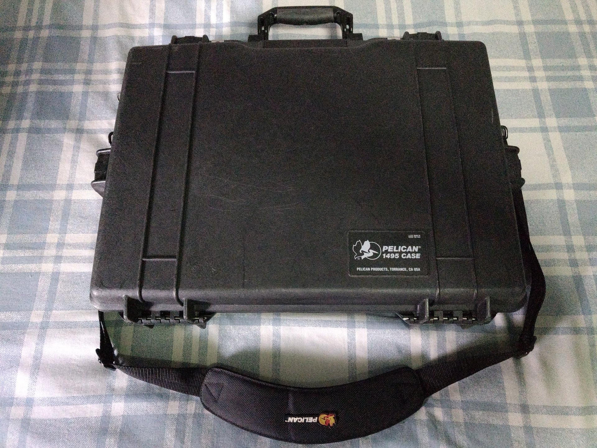

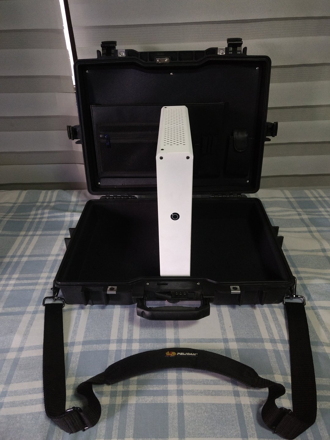

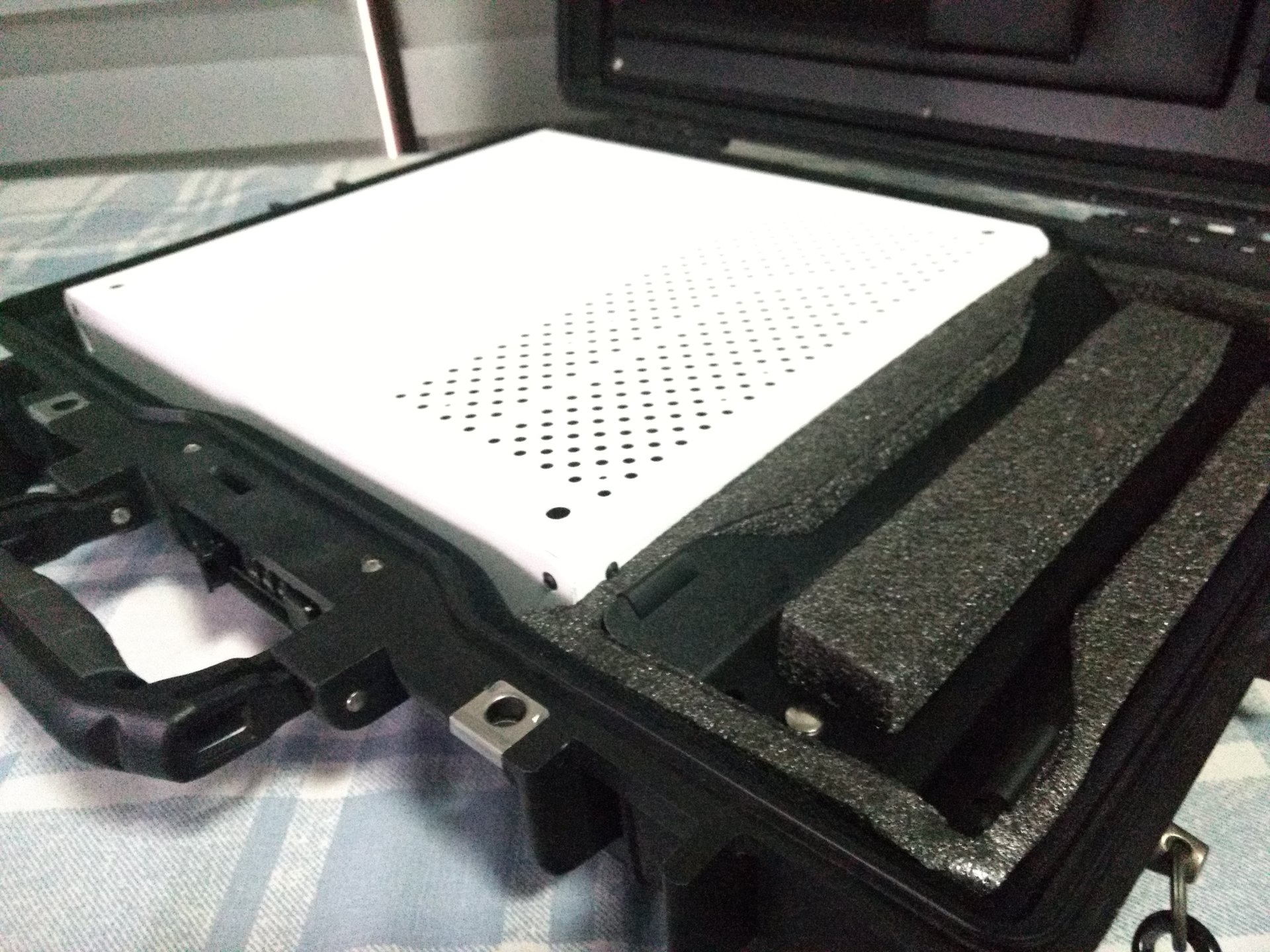

When I reassembled everything again, I very thoroughly inspected every nook and cranny of the motherboard, front and back, and nothing looked out of the ordinary to me. Anyway, everything is working perfectly fine now after reassembly, so I'm not too concerned about that anymore (though it is curious).
In an unrelated note, in case people were wondering, the Sentry fits very well inside a Pelican 1495 laptop case. In fact it's got plenty of room to spare, as you can see in these new pics:
IMG_20170928_160312227.jpg IMG_20170928_160334831.jpg IMG_20170928_172149118.jpg IMG_20170928_160425242.jpg
rfarmer
May 9, 2014
1,153
View attachment 37838 View attachment 37841 View attachment 37839 View attachment 37840
Looks like the perfect case for the Sentry, fits like a glove.

You thought I was kidding when I said October???
Status still says “Sent from Poland 2017-07-24 13:23 WER Pruszcz Gd.”
8 weeks since shipped and 4 months since I posted in this thread (page 91) there’s no sign of where my Sentry is. No tracking for it yet on auspost.com.au so it hasn't gone through customs.
Any Australian’s received theirs yet? :mad:
Mine was from the third transport, so it should've been sent in early June. It arrived Australia on 29 August. Yes it took around 3 months.
Because it's a cheap international service, it's not trackable. So you can only wait for it or "the card" to arrive your doorstep.
Very nice pelican case. Always love their products.
I love the size of sentry makes it "easy to transport", but I sure won't be carrying mine around lol
Haven't actually measured it yet but I'd say it weighs more than 5 kg o_O
I have been taking it back and forth from work to home and I can confirm that the weight is no issue for me . Even with the fan I attached to the side it still fits perfectly fine and leaves room for keyboard mouse and VR headset so plenty of room. I am used to the weight though, before the sentry I had one of those ROG laptops that weights about the same as what I have now.
