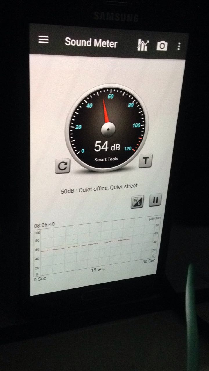

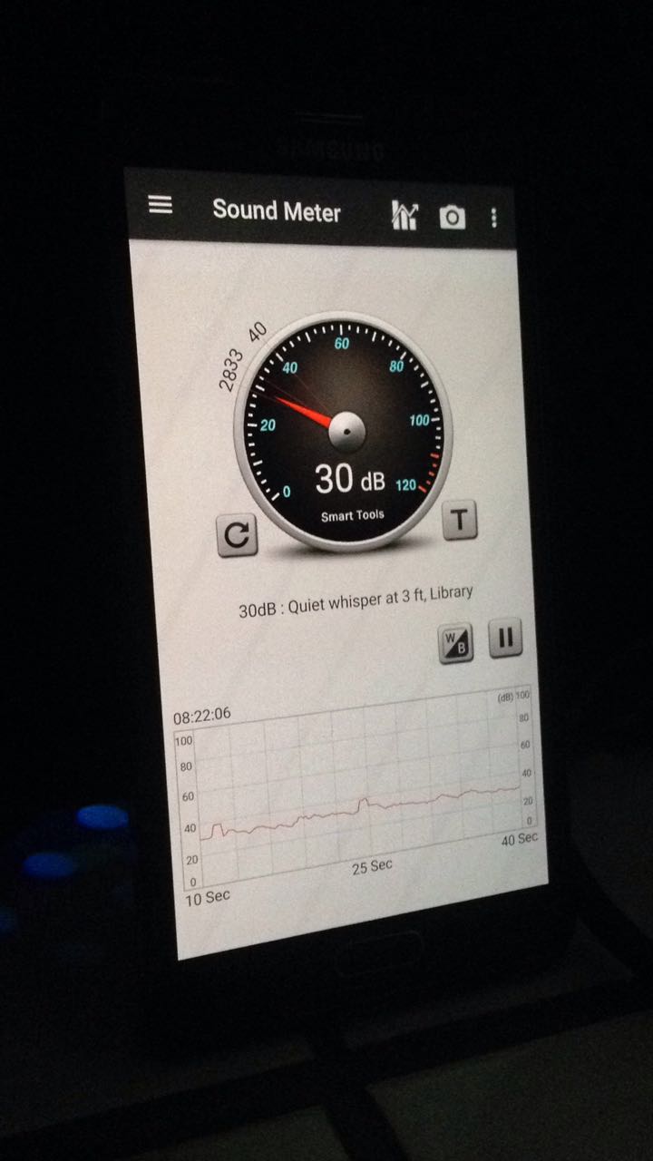

What are the noise levels like with the NF-B9 against the case?
I just tried this app. it's a nice app. I get around 50db on load and 38db on dile ( 34db with no fans running). Measuring right next to the fan.
Measuring right next to the fan defeats the purpose :D
You should check it from the perspective of user sitting in front of the pc to measure the how loud the system is instead of measuring how loud the fan is since that you can get simply from fan's manufacturer's data and its reviews.
It wasn't exactly right next to the fan it was about an arm's length away. I have the computer sitting right next to me on the desk but thanks for the tip. The fan I have attached to the outside of the case has Noise levels: 15 ~ 24 dB(A ) The noctua fan Acoustical Noise is 19,9 dB(A) .

Heh... guys... such apps usually don't work :)
I have few questions:
- Did you use a calibrated sonometer to calibrate your microphone/app?
- Did you check what kind of drivers you are using for your microphone installed in your phone? (f.e. to check if you don't have active noise or echo cancelling, or frequency cutting).
- Did you at least check this app on two different phones to find out if the measurements are the same? (different values with the same noise source would show the problem with the calibration of one or both phones).
- Finally, did you measure the background noise? What was the value of it? 50 dB (which you measured) is lower than the sound level of typical conversation.
Such apps aren't showing any useful information and they won't help anybody unless you will calibrate it with calibrated sonometer and you will be sure you have a really good microphone in your phone (i don't know if there is a phone on the market with a mic for such purposes).

Agreed, same goes for smartphone "bubble" level apps, distance/length measuring apps, etc. Though for the purposes of measuring difference in fan speed it should be fine. Even if the raw values are incorrect the difference between minimum and maximum in absolute value should still be useful information? Or am I wrong?
It would be a useful information if everybody would have the same smartphone with the same microphone and the same app version :)
