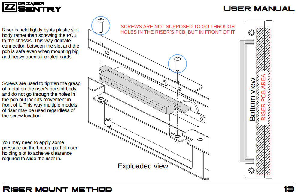

Doas anyone have a problem to fit the riser card into the case? The last 5-7mm wont fit into it wich result in a gap between the GPU and the case which wont let me secure it. The riser seems either be to big for the gap or I'm to stupid to fit it in (brute force wont help). Does anyone have an idea what to do?
I've installed the riser into the case like described in this YT:
Thanks in advance!

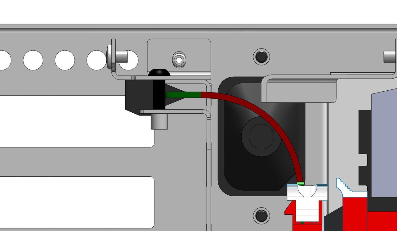

The plastic piece should be held between the metal pieces of the gap. If it doesn't go directly in, then you can fit it inside two ways: 1) try to use a pry tool or a screwdriver to "let in" the plastic piece 2) angle it a bit to make it fit inside:
That's how this should be fitting:
1) Pry tool/screwdriver
2) Angle
3) Finally if that doesn't work, then you can simply bend the lower piece a little, just apply some pressure with fingers till you can fit it inside. Just few degrees of angle / push it down a millimetre.
Also note the fact that notches in the bottom of the riser have to fit into the cutouts on the bottom piece like shown in the page 13 of the online manual:
We know this part might be tricky and we will try to improve the manual based on your feedback.
you can shoehorn it in there really easy with a thin piece of plastic like the hard kind that most ram are packaged in, just cut a section out with a scissor.
Nice idea for DIY prytool replacement like in #2
Yeah it works very well.

That was the trick! Actually it was pretty easy with the screwdriver and a little faith. Thanks for your help!
